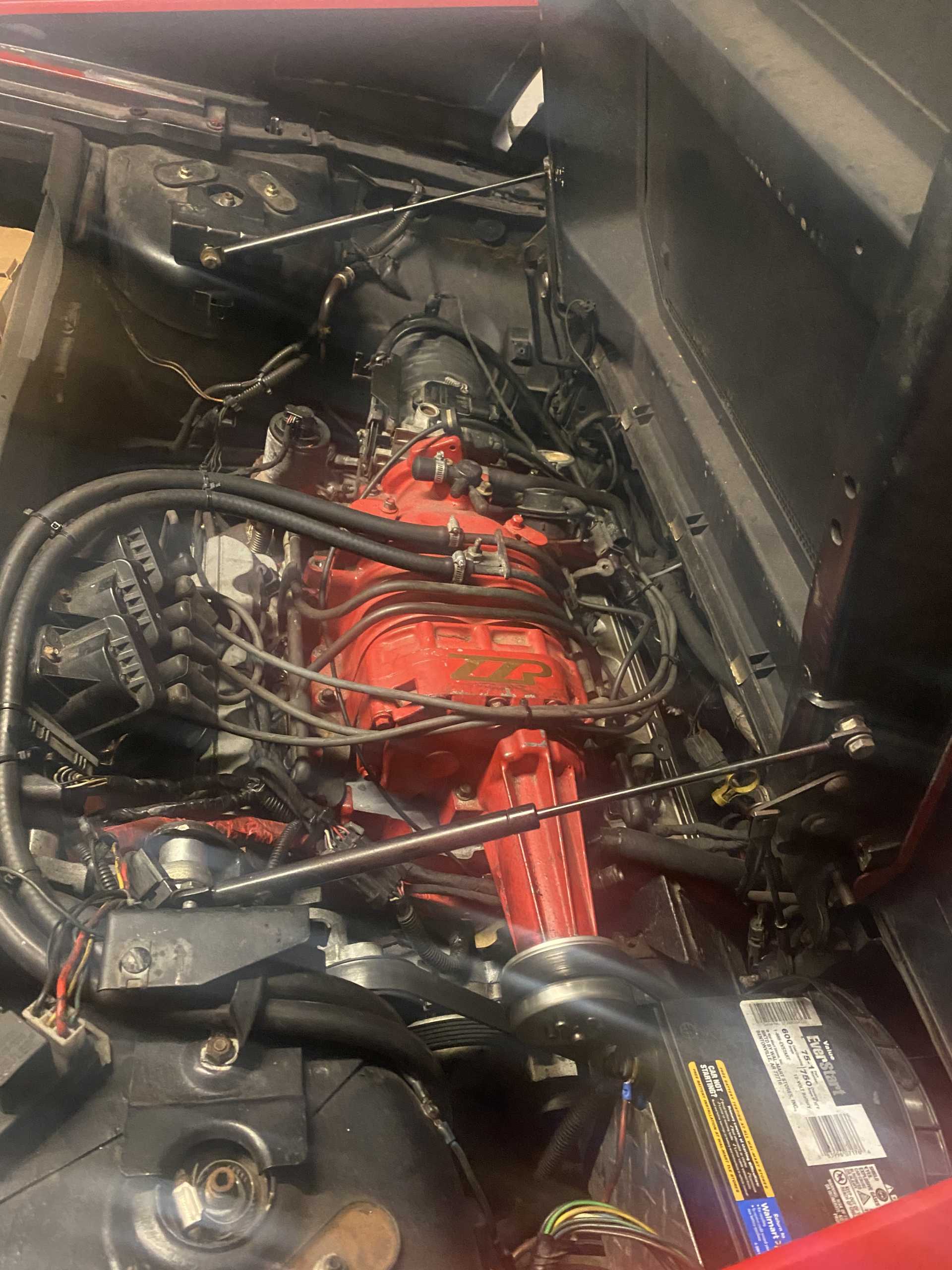

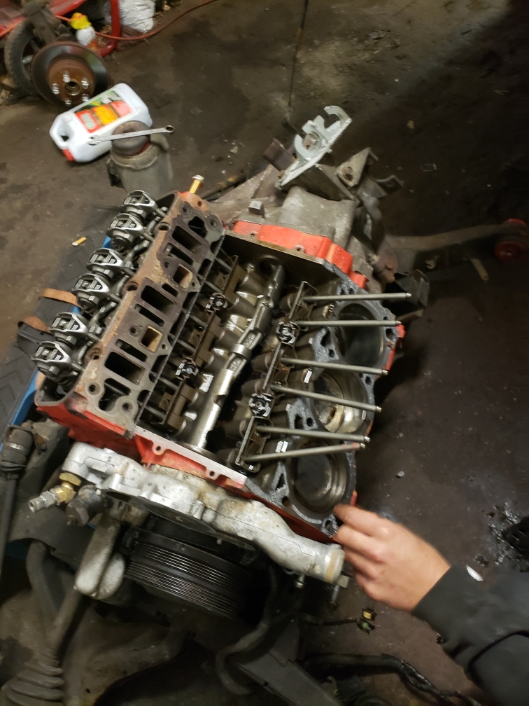

Ok so I had a bad 2 months I had my 3800 built well come to find out I chipped a piston and crushed a spark plug along with dropped a valve. I pulled the 3800sc out and had it rebuilt I just got it back from the machine shop again and in the car I’m ready to start it.
With this build I went with a 5% overdrive harmonic balancer a 3.4 zzp pulley and did front and rear power logs from zzp. Stock L67 bottom new pistons, rings, hardware for crank bearings were fine so machine shops ending up reusing those. I don’t want this to happen again so what is the proper break in procedure?
I’m running 10w30 with a break in additive from Lucas oil company is this fine. I heard run it up to 2000 rpm and hold it there for 20 minutes making sure fan comes on etc so it don’t overheat.
Anymore info will be nice  [img]http://images.fieroforum.co m/userimages/pontiacfierokid1985/FD1E1601-130B-4A9F-87F1-3076EBAE4DE9.jpeg[/img]
