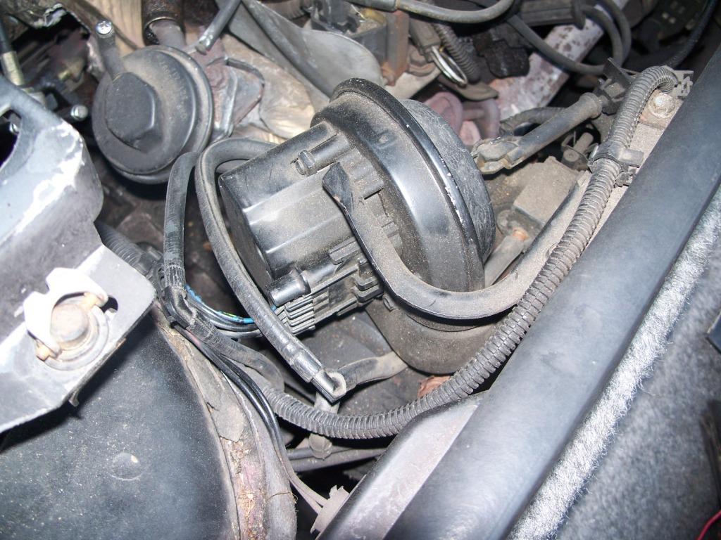

Does your fiero have cruise control? if so, the module has the cruise control throttle cable, which can be adjusted through 5 different holes. mine had the same problem. i put the cruise control cable on the outermost hole, and it idles at 1200 warm and 1500 cold. (they usually have retainer clips on them, check for that) (credit to 2002z28ssconv for the photo on a post here from 10 years ago) EDIT: also yes i know that picture is of a 2.5 L4 cruise control, but the 2.8 V6 is in the same place.[This message has been edited by 86fierorestoproject (edited 03-27-2021).]
