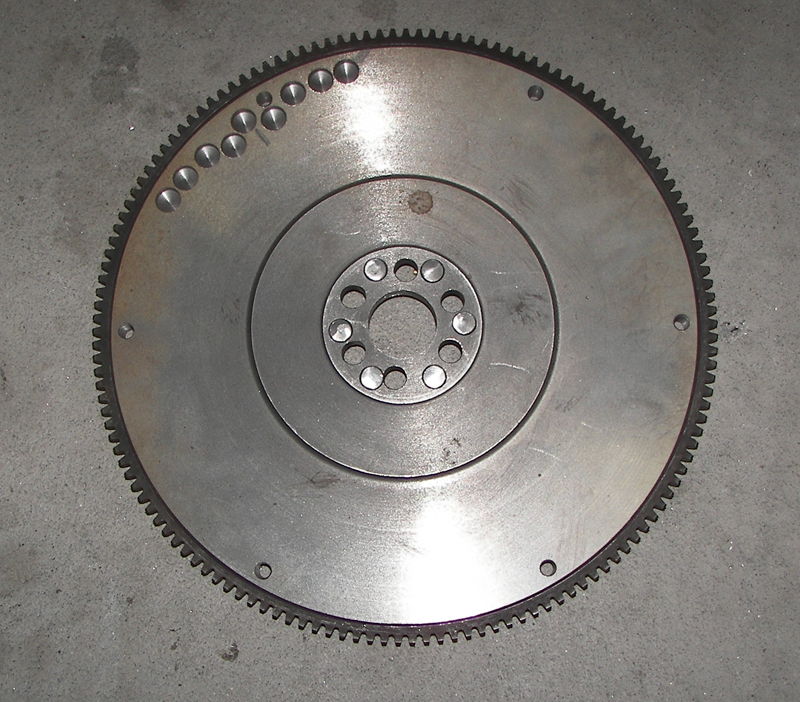

I'm putting a 1990 Allante 4.5 and a Getrag in my Formula. When I ordered my flywheel, I was planning on installing a 4.9 but I found an Allante engine instead. I know the 4.5 Allante block is the same as the 4.9 so I am going to use the same LSC flywheel on my Allante 4.5. But then I read that the Allante 4.5 has a different crank balance than the 4.9 somehow. Should I take the 4.9 flywheel along with the 4.5 Allante flexplate and have the flywheel balanced? Or can I just use the 4.9 LSC flywheel on my Allante 4.5 as-is? Thanks!

Hi, The Cadillac and Allante 4.5 engine is internally balanced on the front half and externally balanced on the back half. I found this out while building a 4.5 for a customer with an aluminum flywheel. You can tell this by looking at the 4.5 flexplate compared to the 4.9 flexplate. The aluminum flywheel was too light to balance so we ended up adding heavy metal to the rear of the crankshaft to get it to balance. If you are using a steel flywheel, you wont have a balance problem to where you need to add weight to the crank. Just take your 4.5 flexplate and your new flywheel and have it "matched balanced" at your local machine shop. Then you are good to go. It will look something like this. Cheers John

Here's what I have. I put a magnet on the flywheel and it's definitely steel and heavy AF like a street flywheel should be. I'll take them up to a machine shop and have them balance matched. Thanks John.
