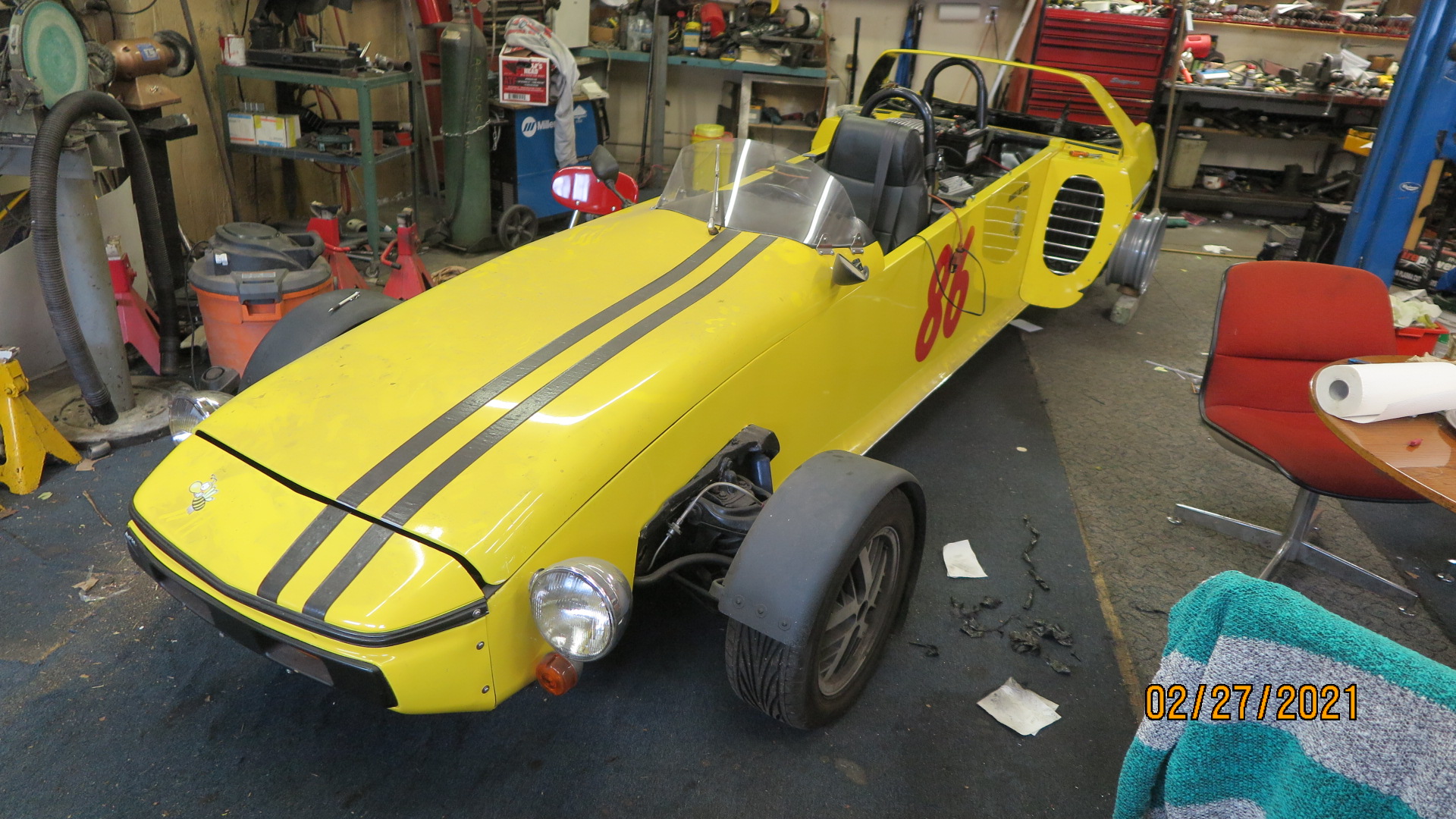

I have removed the engine and replaced it with a 305 Chevy in the passenger seat area (see photo)
I am now connecting up the fabricated gas tank and I know which line is the fuel, but I don't know which of the other two can be used for a vent. The large one is fuel, then there is a medium-size oneand a small diameter one.

The small line went to the charcoal canister. Got any more pictures?

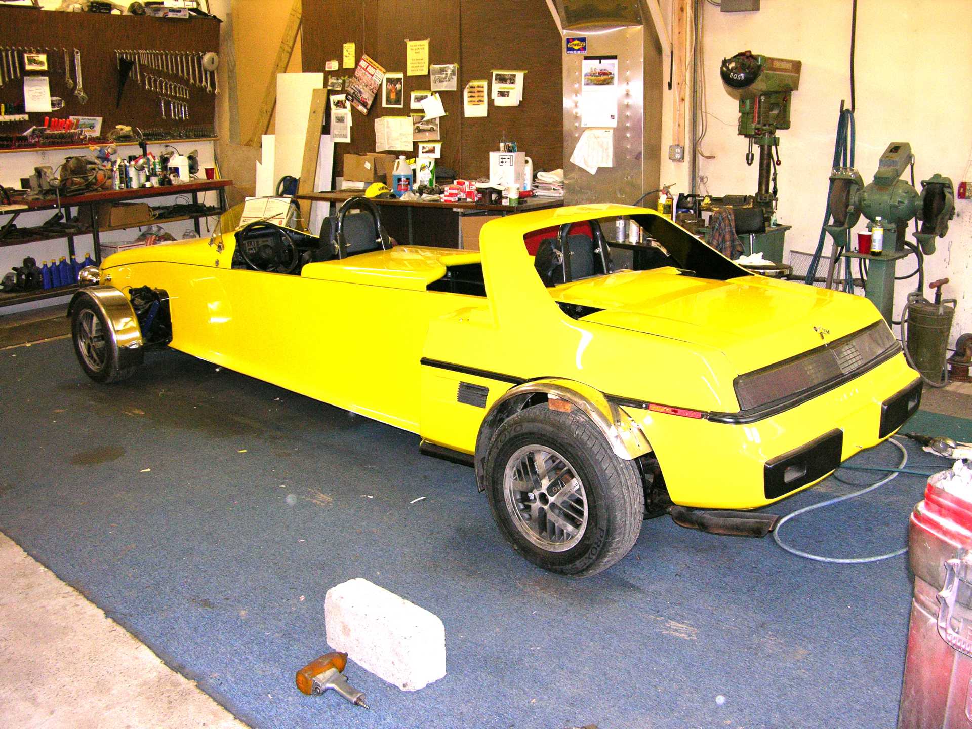

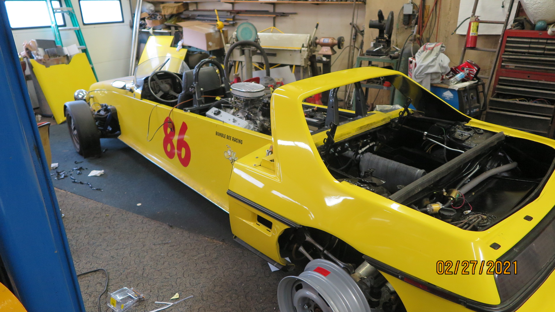

Pic's requested' 305 chev with 84 Corvette rear suspention
Roger Walling
MAR 01, 07:13 PM
