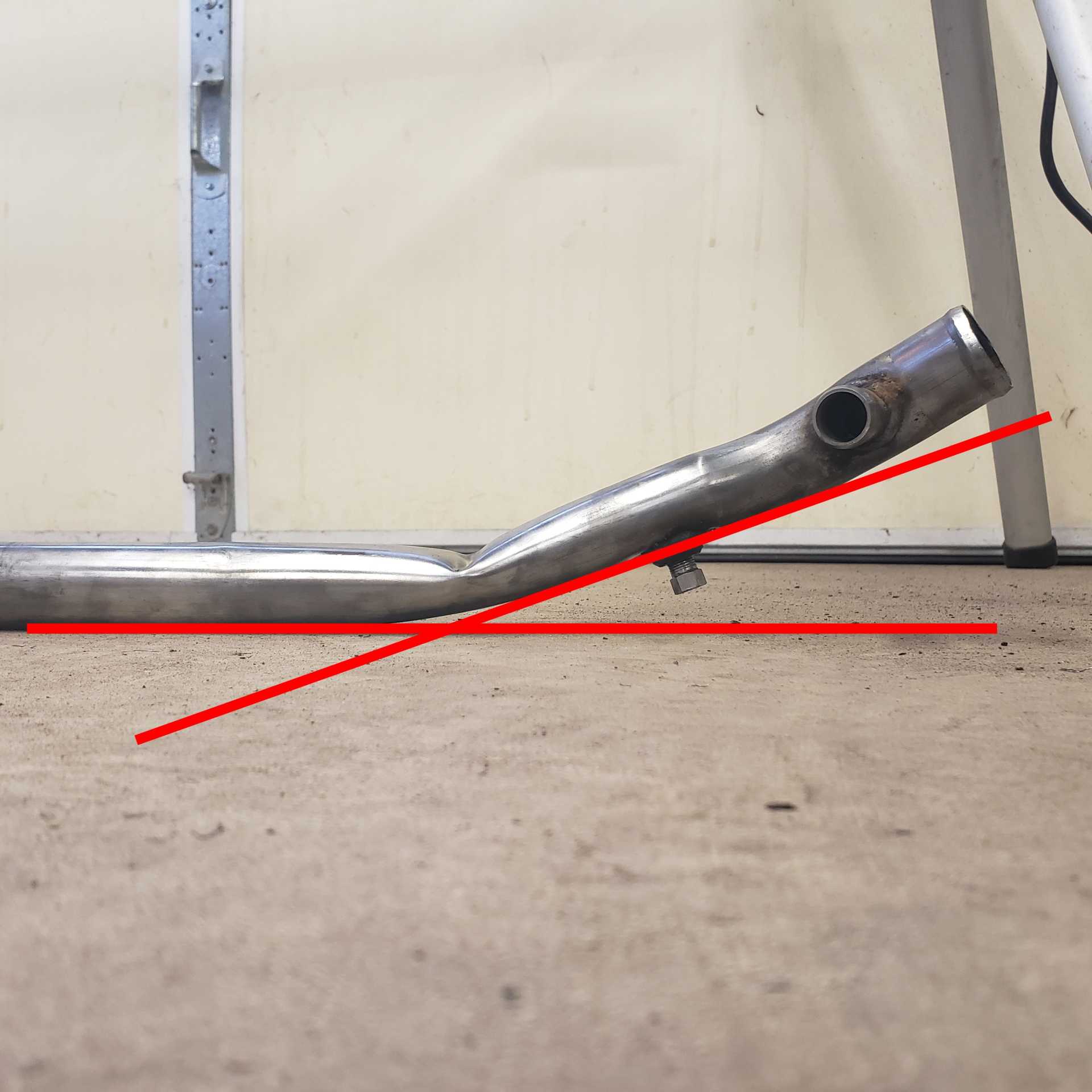

Both of my coolant pipes are kinked at the rear wheel well. Common occurrence I guess. I've never seen what a perfect pipe is supposed to look like. I plan on having the kink cut out of the pipe and a new section of tubing welded in place. My question is (using my picture for reference): I should have the coolant pipe corrected so that both of the red lines become one line, yes? The coolant pipe should be straight, except at the very end where it is supposed to bend upwards slightly.

The pipe is supposed to be straight, right to the point where it "kicks up" at the back. With that said, if you're just going for functional, as opposed to "concours/show worthy", anything close should be fine, as long as you can tap the sides in where it was kinked, in order to mostly restore the cross-section. I had a set that looked nearly that bad, and was able to mostly straighten it, and used a vice and a hammer to "massage" it almost round.
Barring that, Rodney Dickman sells repro pipes, that contain the "under the door" section, all the way to the rear. Since the front sections are almost never damaged, the new rear sections are spliced into the existing fronts. I was only recently made aware of these.

Thank you Raydar. Straight or straighter they will be. No, not going for the concours thing. I just don't want overheating problems.

Strangely enough, I bought an 88 coupe a few years ago. The passenger side coolant tube looked a lot like yours. I was able to drive the car around, even in the summer, and it never seemed to overheat. But I had access to a spare tube, so I swapped it. I then straightened and hammered out the original, and gave it to one of the guys in our club who also needed one.
FEB 13, 10:16 AM
Straightening that tube by bending/hammering may work but my level of comfort in doing that is not 100%. There is a phenomenon known as "work hardening" that tends to make the material more brittle and thinner when it is bent a few times, especially so on old material that has been heat cycled. Will this work on your pipes? Most likely yes, but being the stickler that I am for precision my tendency would be to replace the pipes. ------------------ " THE BLACK PARALYZER" -87GT 3800SC Series III engine, custom ZZP /Frozen Boost Intercooler setup, 3.4" Pulley, Northstar TB, LS1 MAF, 3" Spintech/Hedman Exhaust, P-log Manifold, Autolite 104's, MSD wires, Custom CAI, 4T65eHD w. custom axles, Champion Radiator, S10 Brake Booster, HP Tuners VCM Suite. "THE COLUSSUS" 87GT - ALL OUT 3.4L Turbocharged engine, Garrett Hybrid Turbo, MSD ign., modified TH125H " ON THE LOOSE WITHOUT THE JUICE "

A muffler shop is where I'm going. I'm only going to have a short section welded in. Cut out the kink, weld on a replacement. These tubes are a non standard size. I measured my OD to be 1.317"~. My plan is to use seamless SS tube with an ID of 1.402". The resulting 3/64" gap should be filled nicely by the weld.
Any welding place can do this. I'm looking for a TIG weld with SS filler.------------------ Stanton '88 Formula, red on gray

Welding other tubes to this often fails. Weld "rod" and new tube isn't same metal and have problems because of that.
Cut at crimp. Expand the tube. "splice" w/ hose. Many sure short end is tie to frame to support it and can't "blow off" because any tube w/o "hose lock bumps" easily blow off/out of hoses. Use search.------------------ Dr. Ian Malcolm: Yeah, but your scientists were so preoccupied with whether or not they could, they didn't stop to think if they should. (Jurassic Park)

I'll be sure to inquire about that theogre. I know next to nothing about welding. My plan is to use a muffler shop thinking they weld thin wall tubing regularly. They often work with stainless steel. I'd like them to back purge the weld as well. Hopefully in the end I have a quality job done. I think I will have. We're talking metal here. Nothing special. It can be welded. If it isn't, it's the welder's fault.
Worst comes to worst, I buy the repair tubes from Rodney. In any case, I want the kinks gone. ------------------ Stanton '88 Formula, red on gray
