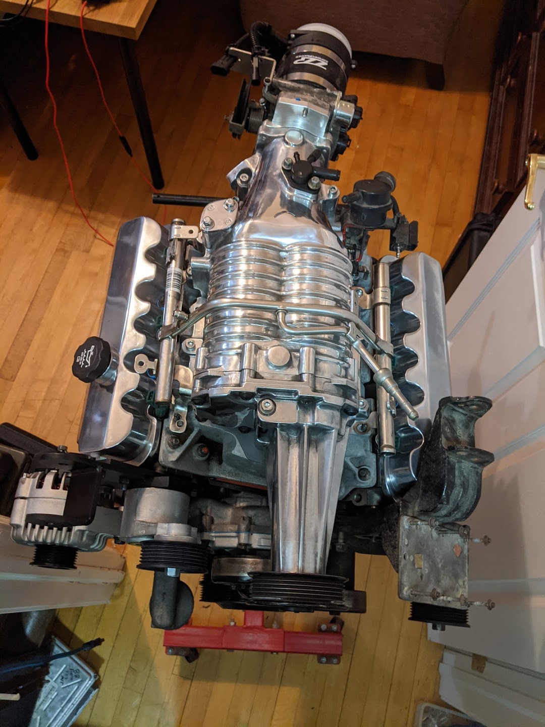

Hey all!
I'm currently in the process of plumbing my fuel system and am planning on running a Series 3 Returnless fuel rail. Does anyone know if the Corvette / LS Fuel pressure regulator combo will work for this application (I find mixed opinions on this)? How will tuning need to be set up? This is a brand new rebuild so I can't dyno it to get it dialed in, I need to have the fueling somewhat accurate from the get-go in order to properly break in the engine.
I'm really stuck at this part, and any help would be appreciated!
