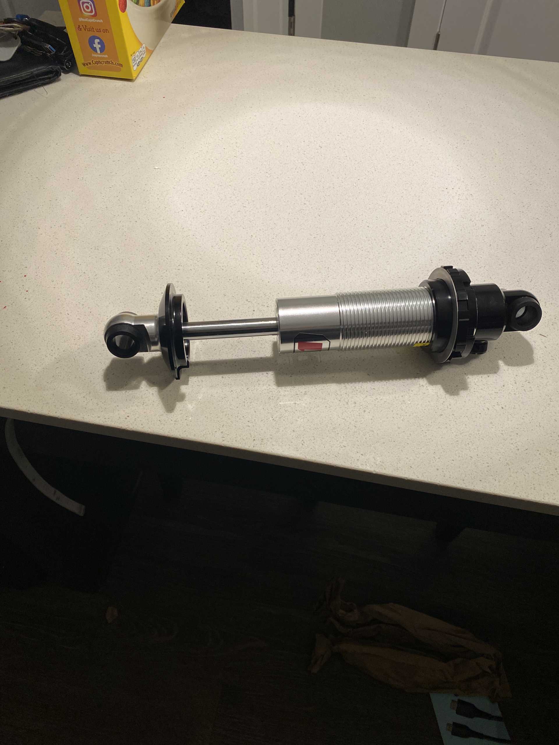

Hey everyone, sorry I had notifications turned off for the post. For anyone who is wondering, the bushings for the control arms are the same bushings used in the ‘88 stock control arms. I don’t have a part number for that but I ordered some prothane ones off of eBay and I’ll post the part number as soon as they come in. As far as the shocks go, they’re QA1 DS402 coilover shocks with a QA1 SS110SDM top mount adapter. The coilovers can be purchased on Jegs and the top mounts are only available through QA1. Hope this helps, and I’m sorry for the delay! I’ve also attached a pic of the shock sans adapter.
