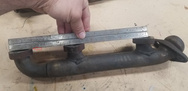

Hello all,
I purchased a set stock exhaust manifolds , I am in the process of porting.

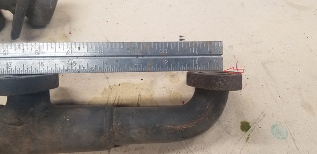

I have a question; Do all three ports lay flat and level across all three ports?
I currently have a gap between ports.
JAN 26, 05:44 PM
All three ports need to be flat and level with each other. A buddy of mine used a large belt-sander to level mine when we ported my manifolds.

All three ports need to be flat and level with each other. A buddy of mine used a large belt-sander to level mine when we ported my manifolds. |
I figured as much but want to certain. I was thinking going the same route with the belt-sander as well. Harbor Fright has on for $75 but I don't think it has enough HP to get the job done.
Do you what grit was used?
