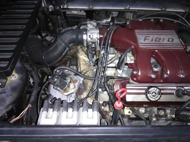

Just for the sake of clarity, here is an example from the Georgia Fiero Club site. Don't get distracted by the changes due to using a coil pack. The EGR comes with a black cap that is removed in this photo. I am a little concerned that the aluminum adaptor plate might fall into the 'bright, shiny object' category. Perhaps it could be painted a rust color to sort of blend in?
skywurz
JAN 05, 03:42 PM
One thing id be worried about is one of the steps is to literally "check egr" they check to make sure its there. That doesn't look like a typical EGR for this era of car.

On the matter of the digital looking different, what if we welded the OEM, rusty-looking, digital flange to the pipe right were the original Fiero flange went? The weld would be underneath the flange, so not observable, and we could use a (working) junkyard EGR so the installation would at least look old ...
