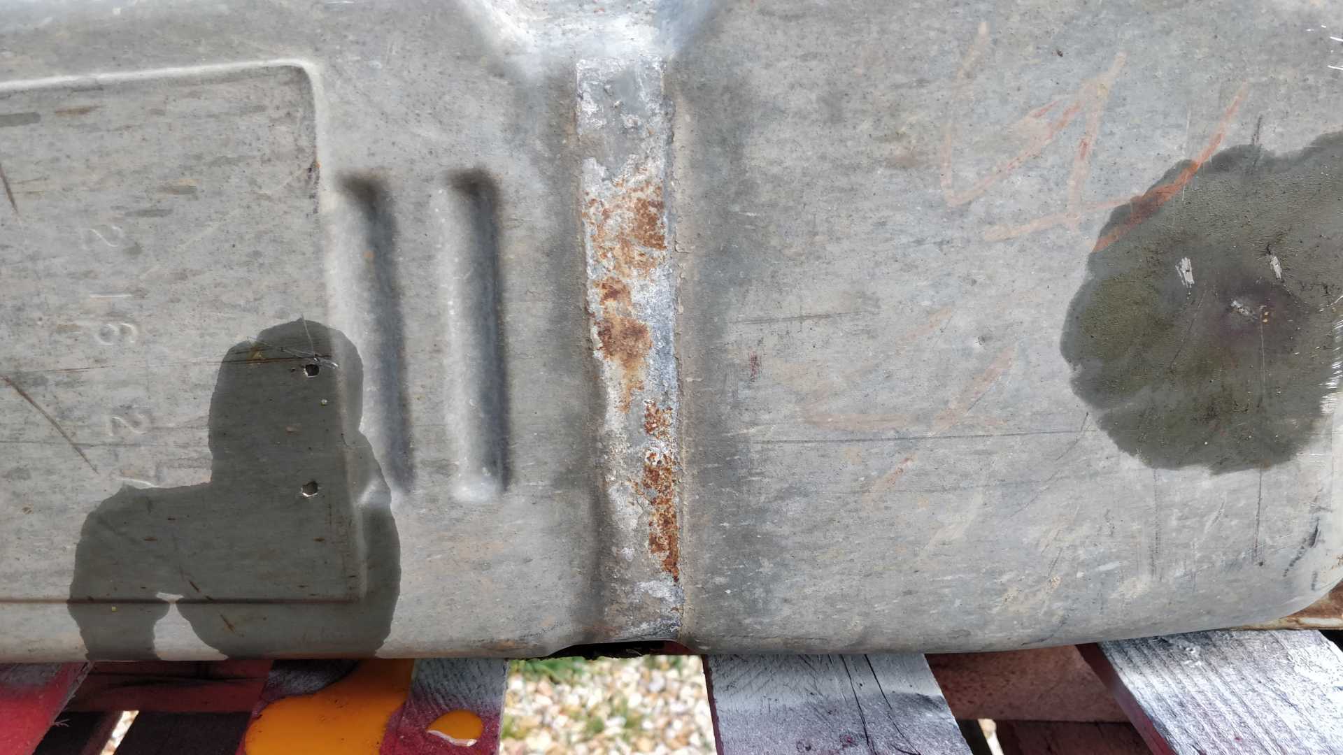

So actually the gas tank is missing out of my 88 GT project... Some how i didn't notice.
I have an extra 88 tank sitting in the corner. But im 95% sure it has a pinhole leak in the center rear right on the bottom. I have tons of options and thought id ask and see what you all think

Do you have a radiator shop nearby? I’d let them clean the tank (to remove the rust that caused the pinhole) and plug it.

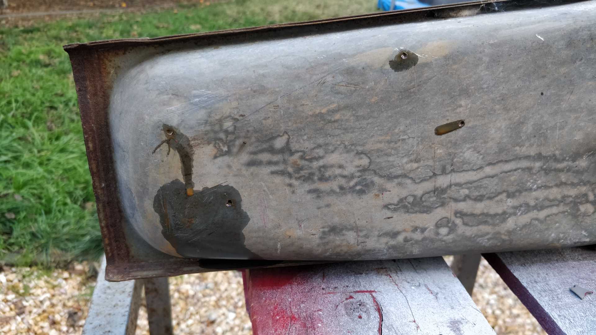

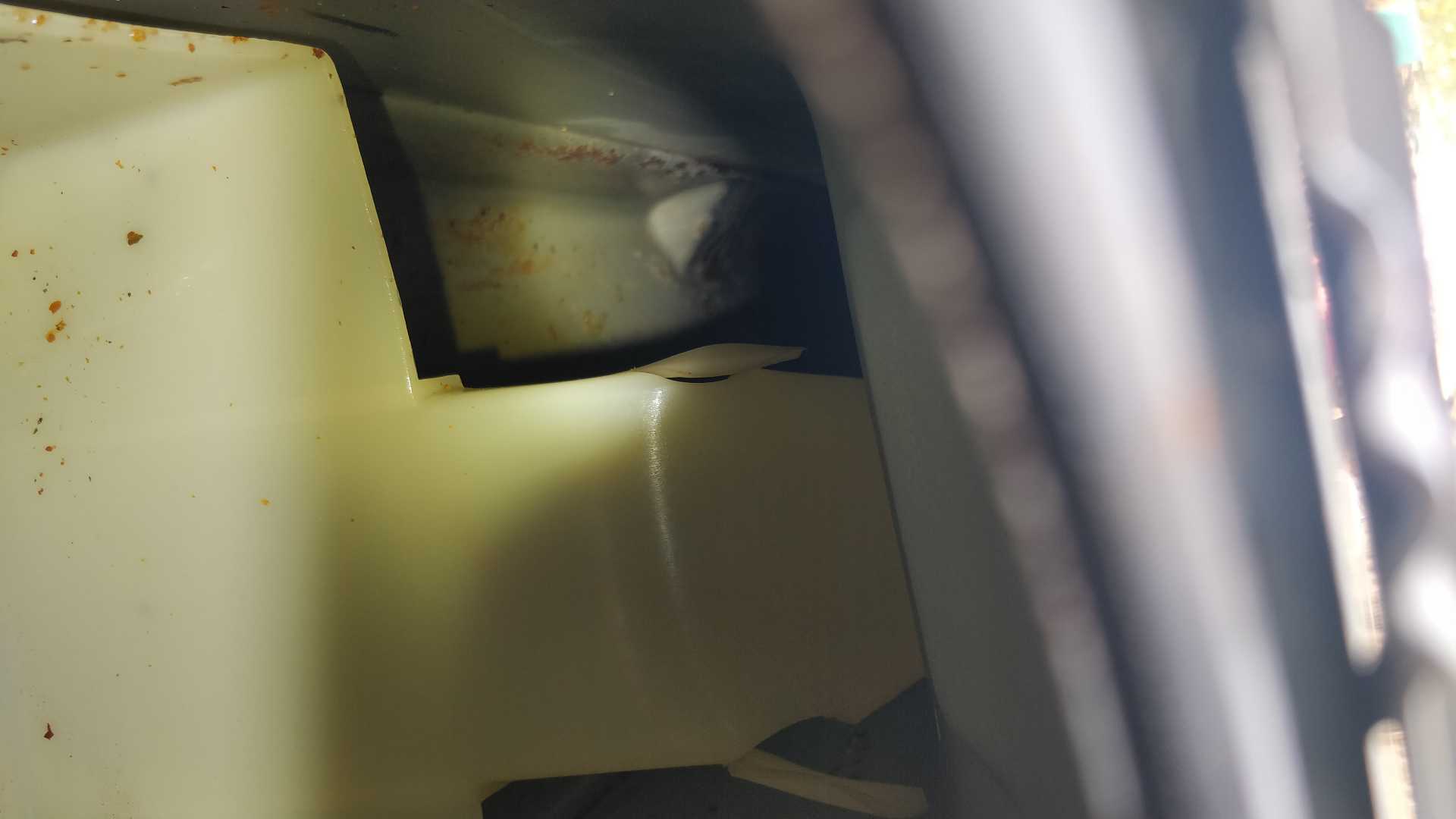

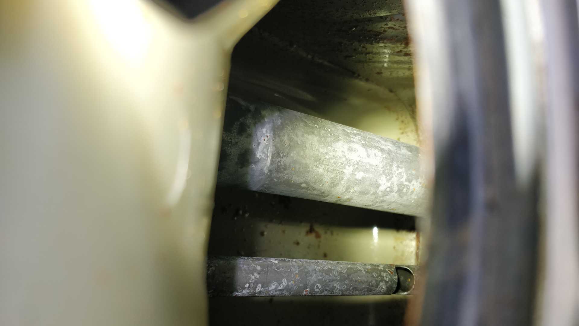

So after posting i decided id go look at the tank closer.
Opened it up and saw lots of cheeto goo
I decided to take a blunt object and poke at some of the rust spots.
10 holes opened up and happily leak.

I hate to say this, but if RUST caused that hole- How bad is the rest of the tank? Might be better to find a replacement; Either one from a junked Fiero or possibly a newly manufactured replacement. I saw on the RD website that Rodney was looking at possibly making replacements.

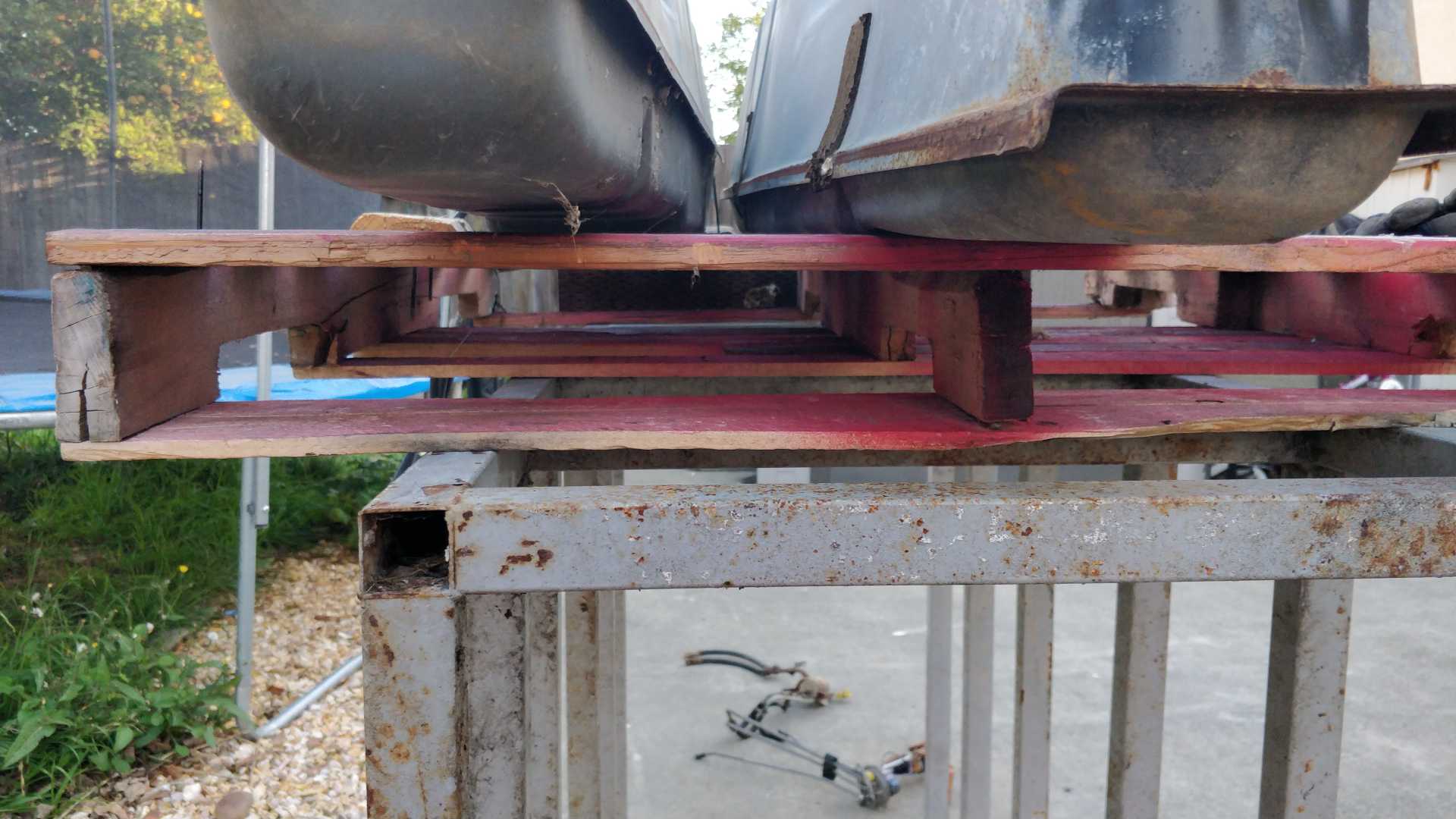

DEC 26, 07:05 PM
So i pulled this tank i pulled out of an 86 and put it next to this one... If i use the 86 front strap will it work in an 88? The only difference i really see is the tank seam is lower on the 88 and the bottom is deeper in the front.

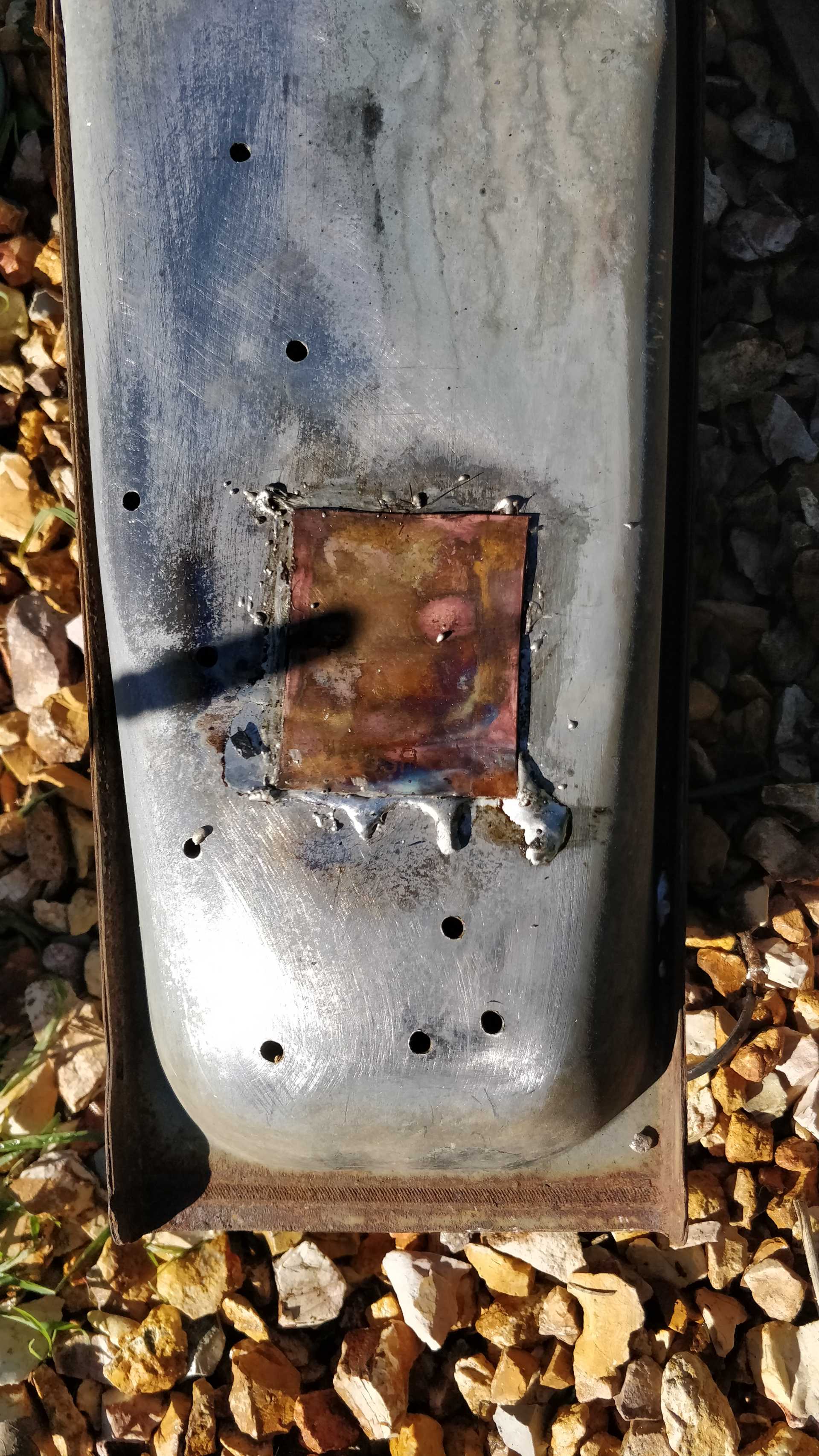

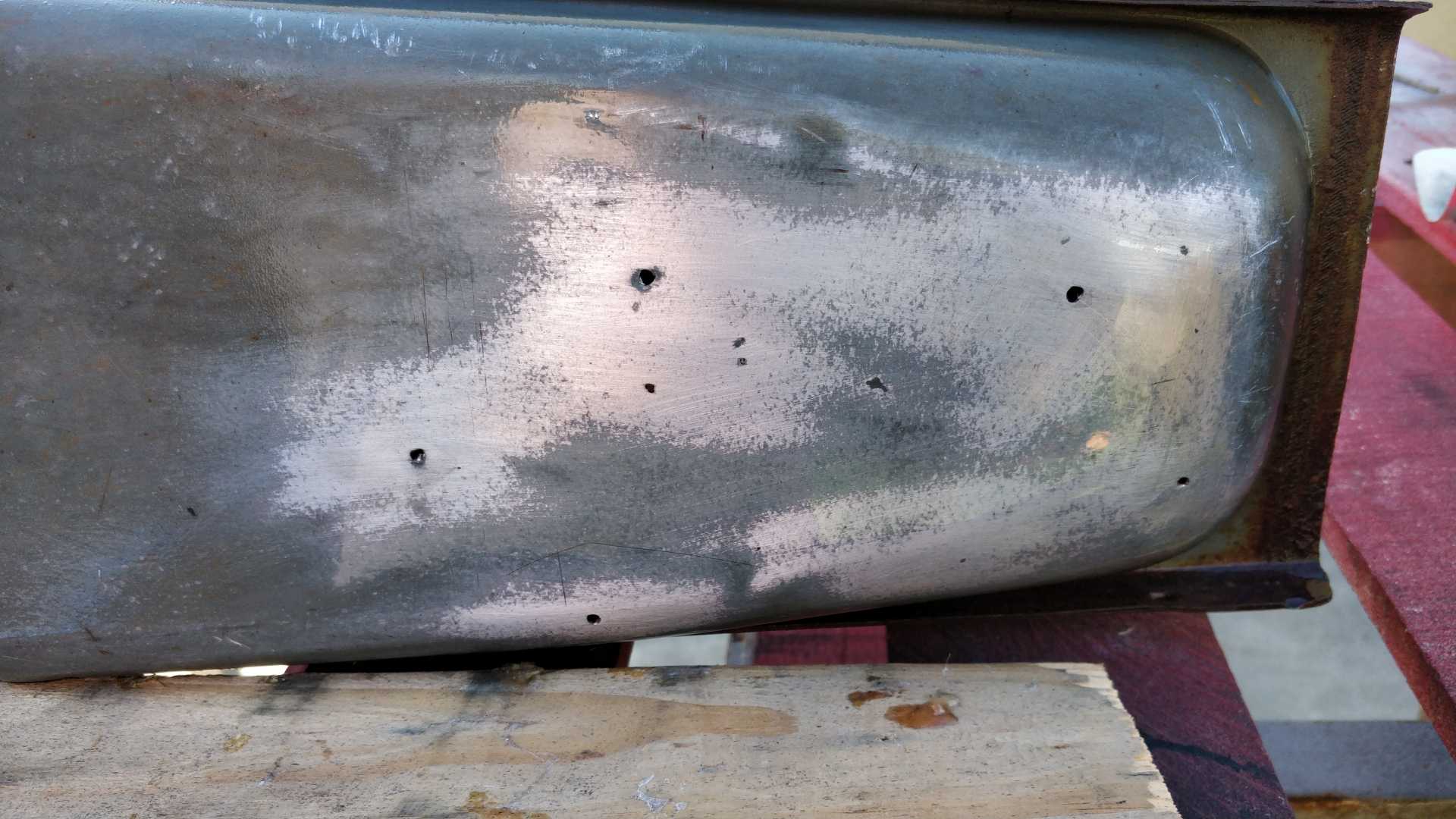

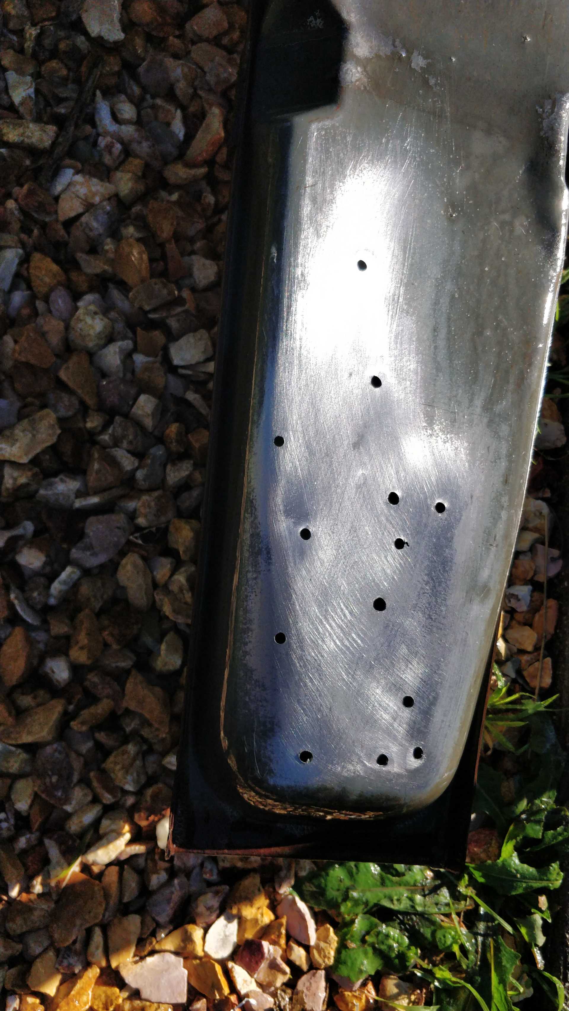

So i decided to play around with this 88 tank as the nearest one i have located is 500 miles.
I cleaned up the front of the tank.
I drilled out all of the discolored possible pinholes

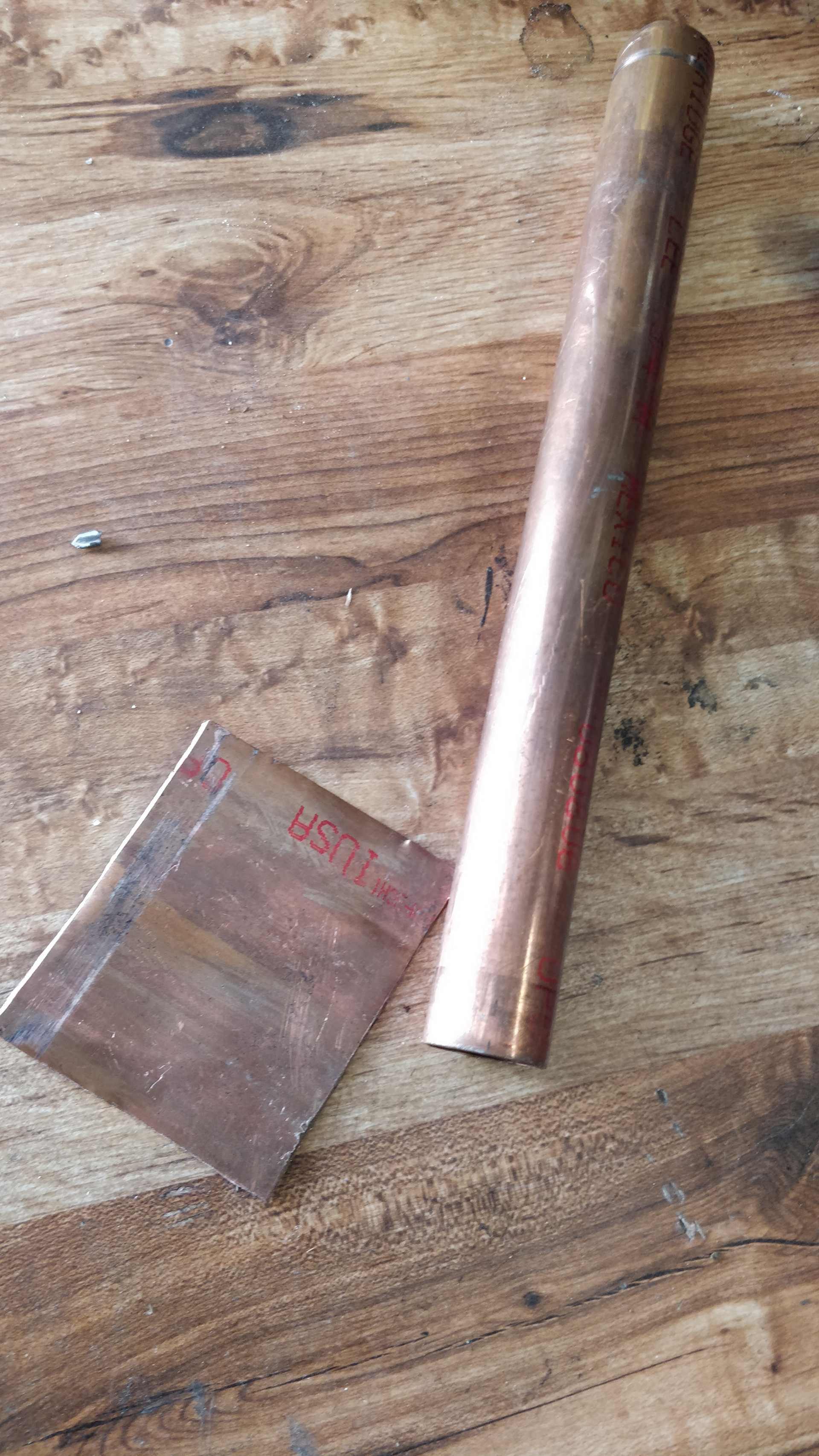

I took some copper pipe and flattened it out
I started trying to figure out how to solder non electronics
I figure ill do the rest and water test it and see if any of my patches are worth a darn.

If you have located that many holes that need repair, there must be many corroded spots that will soon turn into more holes. Keep looking for a replacement. Have you checked Car-part.com ?

Patching is good but doing in video and above is way wrong. I've seen kids solder better then the video in top post.
With as many holes in a short space needs expert level repair or will fail sooner then later and likely on highway maybe burning down w/ little or no warning. Even then If holes are near the plastic baffle then expect damage to the baffle.
Also if tank is Galvanize, you have Zinc poison dust/fumes to sand/grind solder or weld. Must do this outside and better you wearing a "hard" mask and P100 w/ Carbon filters. ------------------ Dr. Ian Malcolm: Yeah, but your scientists were so preoccupied with whether or not they could, they didn't stop to think if they should. (Jurassic Park)

Well its done. As in trash. I tried my hand at soldering and i just suck at it. Probably running out of flux didn't help. Now to the search bar to look and see about putting a pre 87 tank in an 88 has been discussed.
