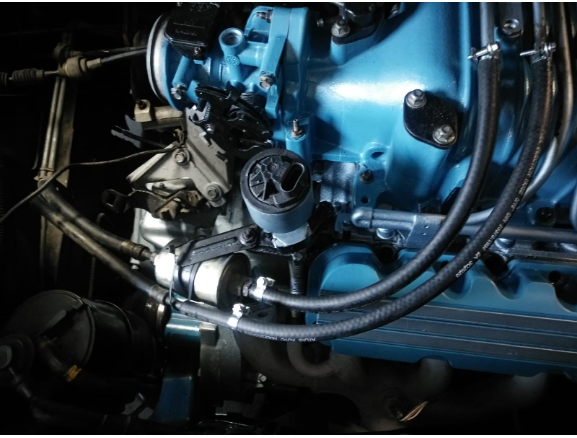

longjonsilver
DEC 22, 03:54 PM
Thanks Dennis, you da man!
Heres a pic of my (just installed today) fuel lines -
i'm really behind on my 3800 thread, gotta start posting pics.....------------------ Astronomy says we will find a coded signal from outer space. Then we'll KNOW that life exists there, for coded signals aren't by chance.
