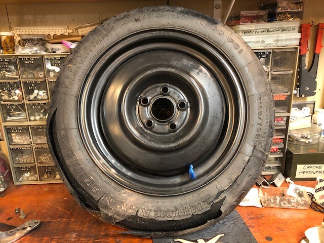

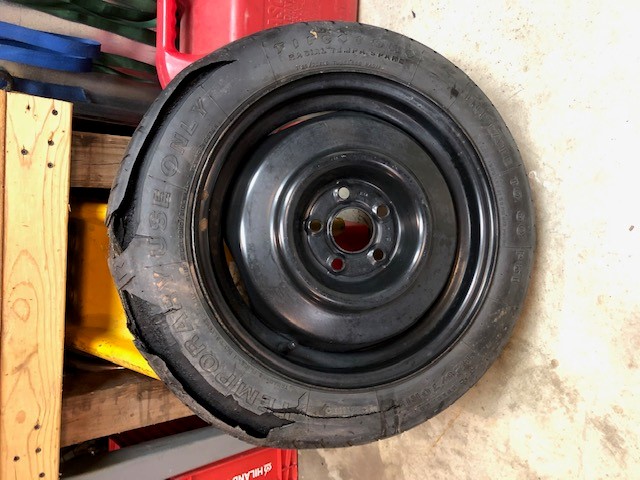

I needed to replace my spare, as the original either blew apart sitting in the frunk, or the PO attempted to drive on it, causing it to come apart:

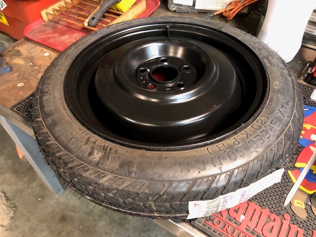

 I had searched this forum only to find that folks were having a hard time finding a suitable replacement that would fit the original spare rim and/or fit in the area where the spare lives. After some searching, i did find that there is indeed a tire is available to fit these spare tire rims. I was able to order the Kumho 125/70R15 95L tire from my local Firestone Car Care center (yoiu can't find it on their website), and had them mount it for me. Total cost was about $65:
Just thought I'd pass this along in the event it might help someone replace their spare.

Great info. Most of us are driving around with mid 30 year old spares. Wear and age influence tire strength. If the original OEM spare is kept fully inflated and not exposed to bad environmental conditions; for a short distance at reasonable speed, it should be able to get you to the next service station or tire store. The one shown in the pictures here appears to be an old tire driven on low air pressure for more miles than the tire is rated for. These are short distance lower speed tires. Keep that spare inflated. Still no guarantee it will work but there are reports here that these unused old OEM spares work.

While spare tires will "rot" from age... Looks more like Old tire was "run flat" cause belt failure then stored again. New regular and spares tires can and do have same failure w/ low inflation.

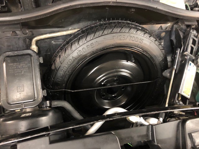

Above is T125/70D15 95M. Just read label and sidewall.

If you have them mounted, should ask DOT Date Code are on same side and neat the fill valve. Tire Date Code only "stamped" on one side in one spot. Think above is close to that so can read w/o pulling tire out. Loosen the "clamp" and rotate valve point to MC should show DOT data.
