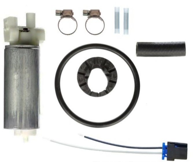

Hello, this is about an 84 fiero's fuel pump. The new one i got with the car it looks like I will have to splice the wires to the fuel pump onto, so I am wondering if there is a way to test the polarity to make sure it is pumping the right way and functioning correctly before I install it and the fuel tank again, as it was a huge pain to remove for a newbie. Any suggestions?

It is this kind of deal, the black and white wires I believe are supposed to splice onto the black and black original wires of the fuel pump, as I understand it.

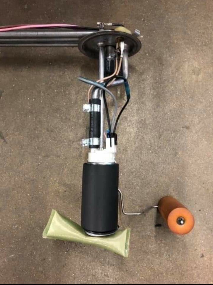

Here is what the final result looks like, you can see the plastic bits covering where the wires were spliced.

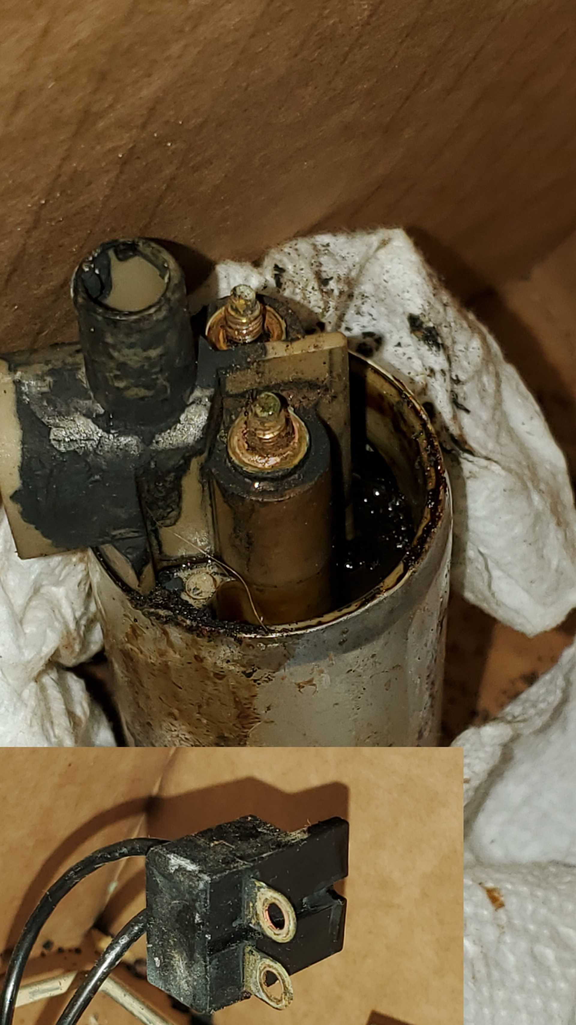

Here is what the current connection looks like

That picture of the old one doesn’t look like a normal fiero fuel pump or connector to me? It might just be the angles? [This message has been edited by wwcvel (edited 11-25-2020).]

Could be, here is another picture. They might have changed the fuel pump arrangement for the later years, there are a lot of things different from the '84 and later models, especially in the electric arrangements. This one had been sitting for 23 years, so I doubt it would be an aftermarket part.
