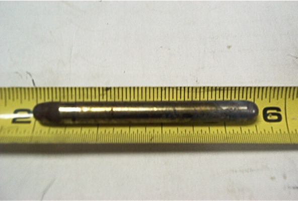

The '86 GT had both 4 and 5 speed transmissions. If you have a 5 speed, the push rod is like this:
 [This message has been edited by Gall757 (edited 11-16-2020).]

Whoops! Forgot to mention - 4-speed. For now...

The 4-speed slave pushrod is 5 5/8 inches long.
The new slave didn't come with a pushrod? If you have to make a replacement, be sure it's a properly hardened rod, else it will bend under use and fall of the clutch release arm.
