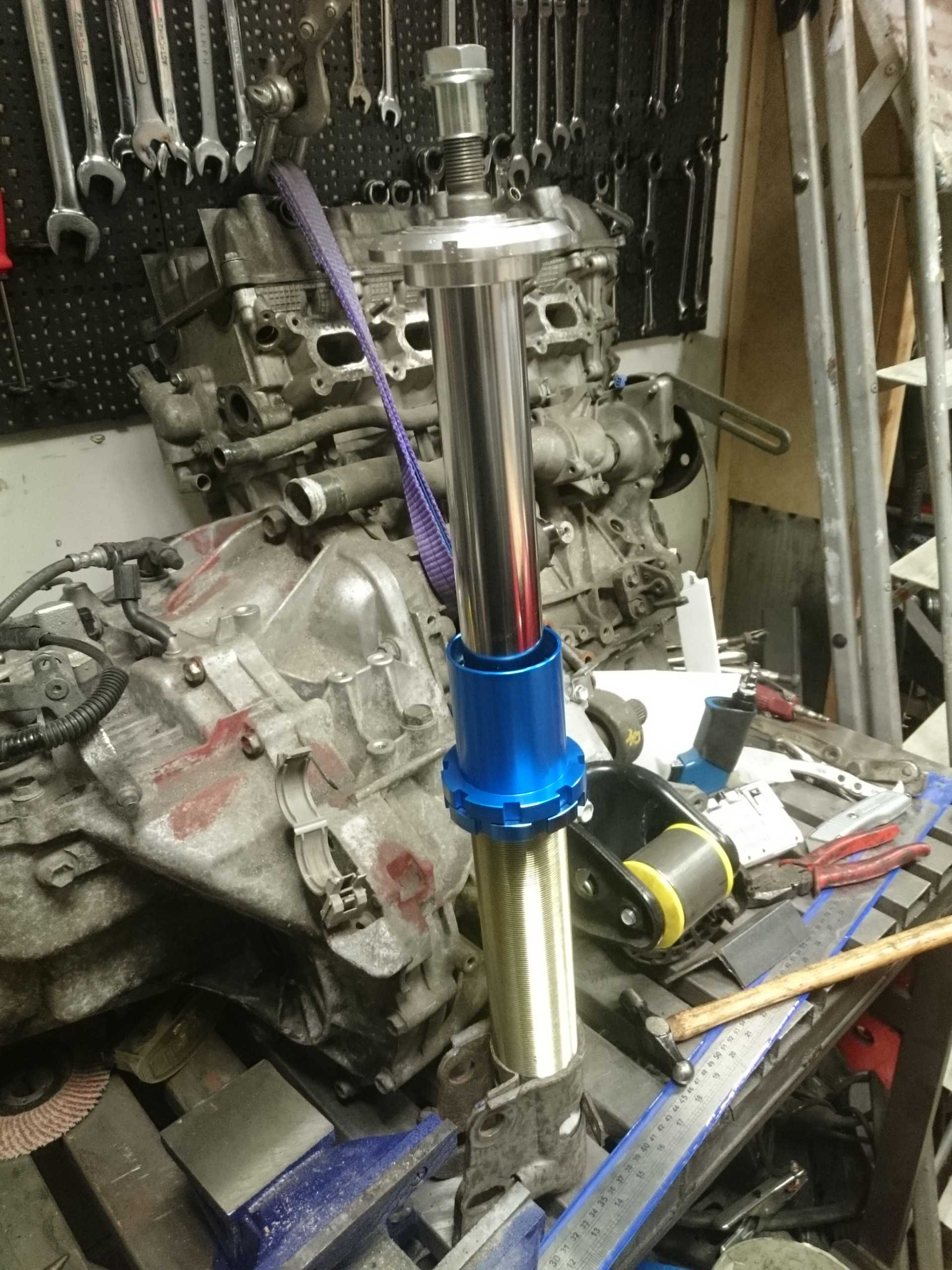

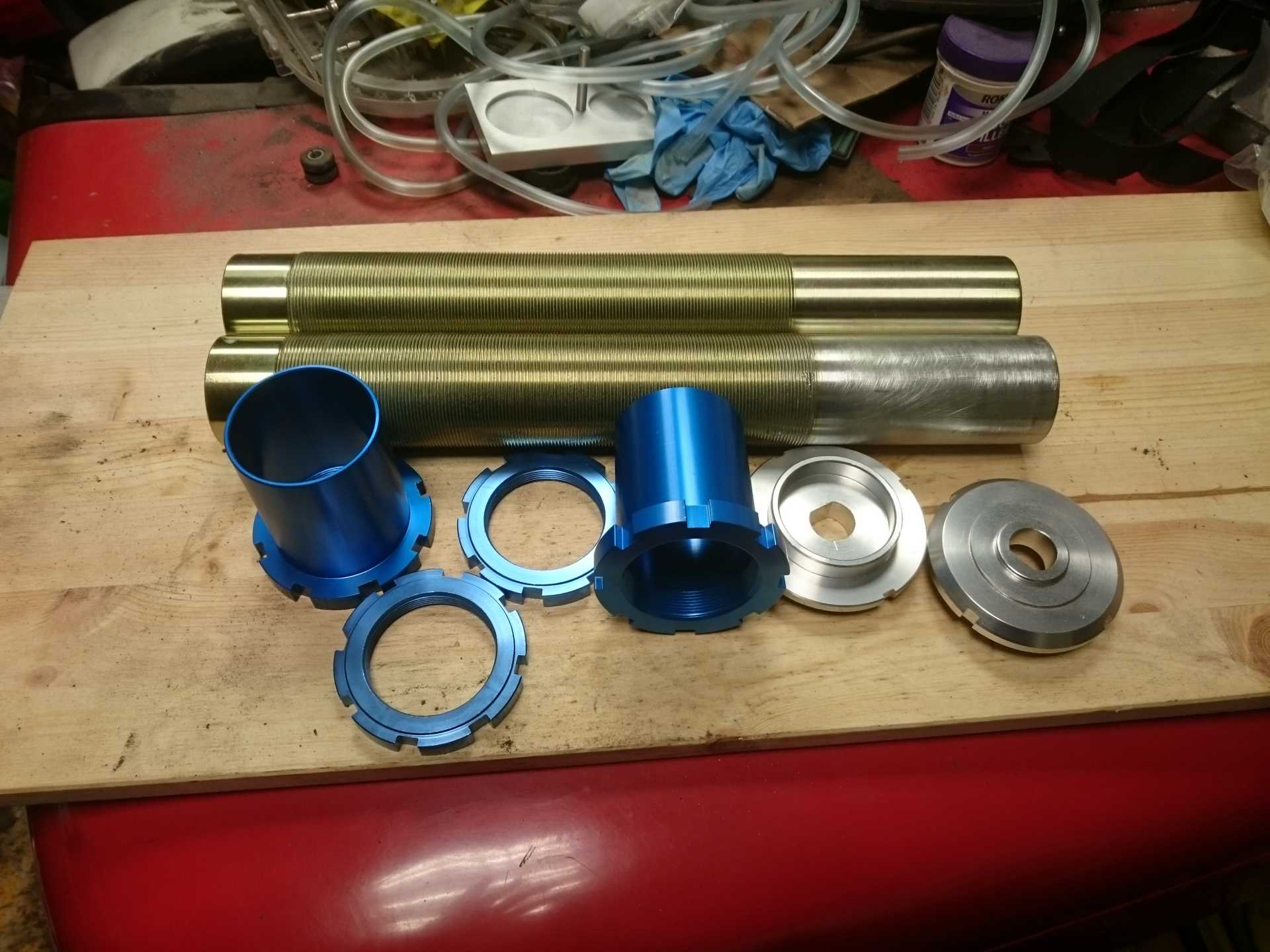

There's also been limited investigation of building inverted struts using Bilstein cartridges, which can be easily revalved.
If you can find a Koni insert that has the right dimensions, the Koni Custom Shop (and other builders) can revalve it to whatever you want.
Iain
NOV 06, 09:04 AM
Will
NOV 06, 09:25 AM
| quote | Originally posted by Iain:
It's actually not that difficult to build Bilsteins, but you do need to be able to weld to a good standard. If you use s/h inserts you'll likely need to fabricate, or buy, new top mounts. Gives you much better control of ride height and valving though.

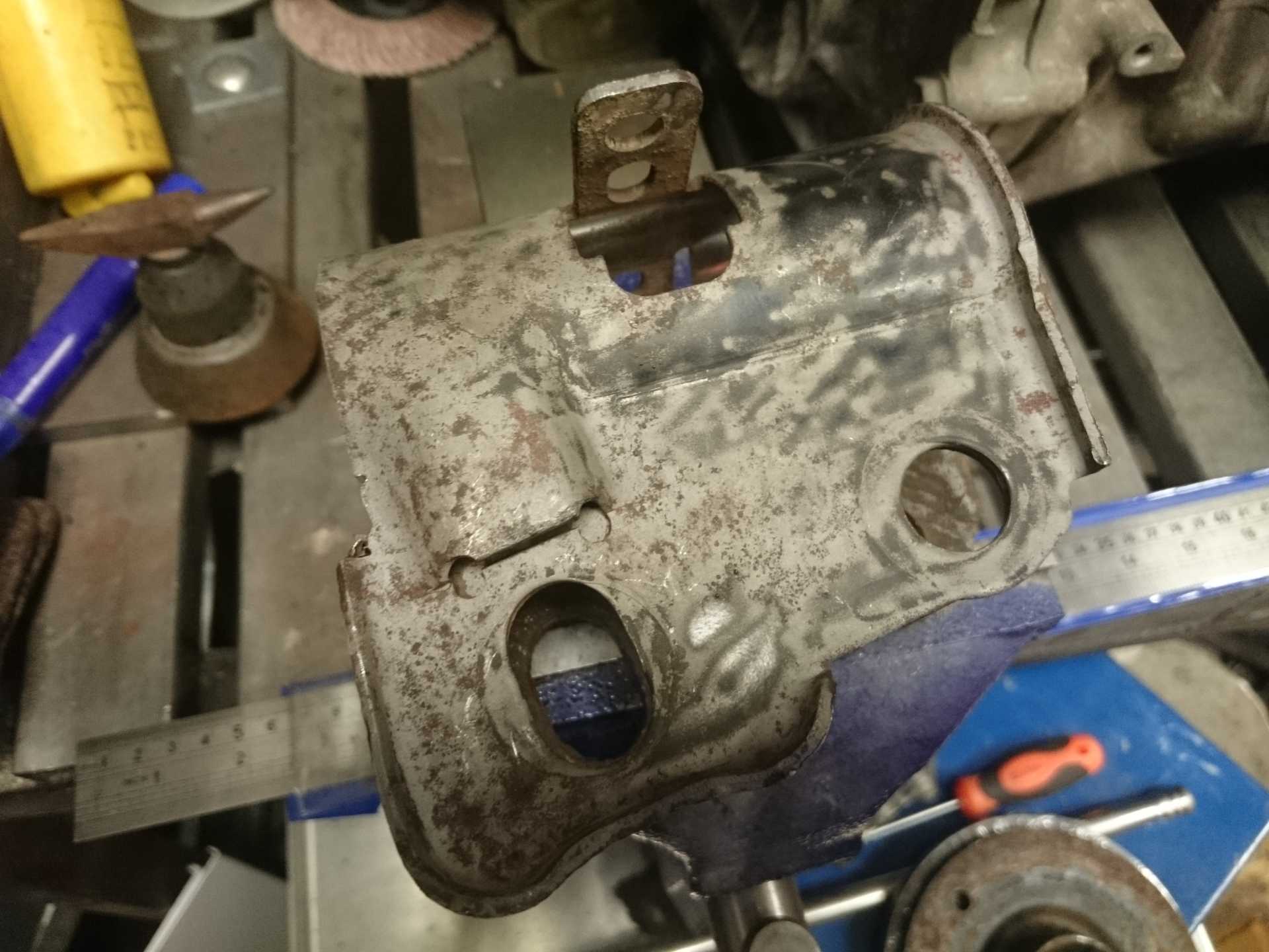

You need the bottom brackets from a pair of struts.
If you're bulding from scratch, you don't need the brackets.... a pair of profiled/drilled plates and a couple of reinforcement pieces would make a new taco clamp from scratch.
