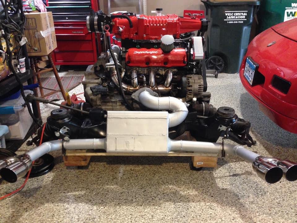

3800sc 4 speed build looking the part link and number for the spin tech muffler people use for their 3800 builds  [img]http://images.fieroforum.com /userimages/pontiacfierokid1985/6BF4AA50-02F3-4A33-B7E4-4325F7526B16.jpeg[/img]
OCT 17, 10:01 PM
I use a Spintech part number 343SC . Its a 13"L Crossflow muffler 9" high 4" W. It has a single 3" inlet and two 2 1/2" outlets. If you want something quieter call Spintech and specify a 2 1/2" inlet and two 2 1/4"" outlets that can be connected to the Fiero trumpet exhaust ends. Spintech mufflers emit a deep sound but they are quieter than the Flotech afterburner muffler that is super loud. With the afterburner it was so loud inside that you couldn't even converse on the highway while cruising. If you want to quiet the Spintech some, wrap both exhaust pipes in DEI exhaust wrap. The pipes will act like resonators.

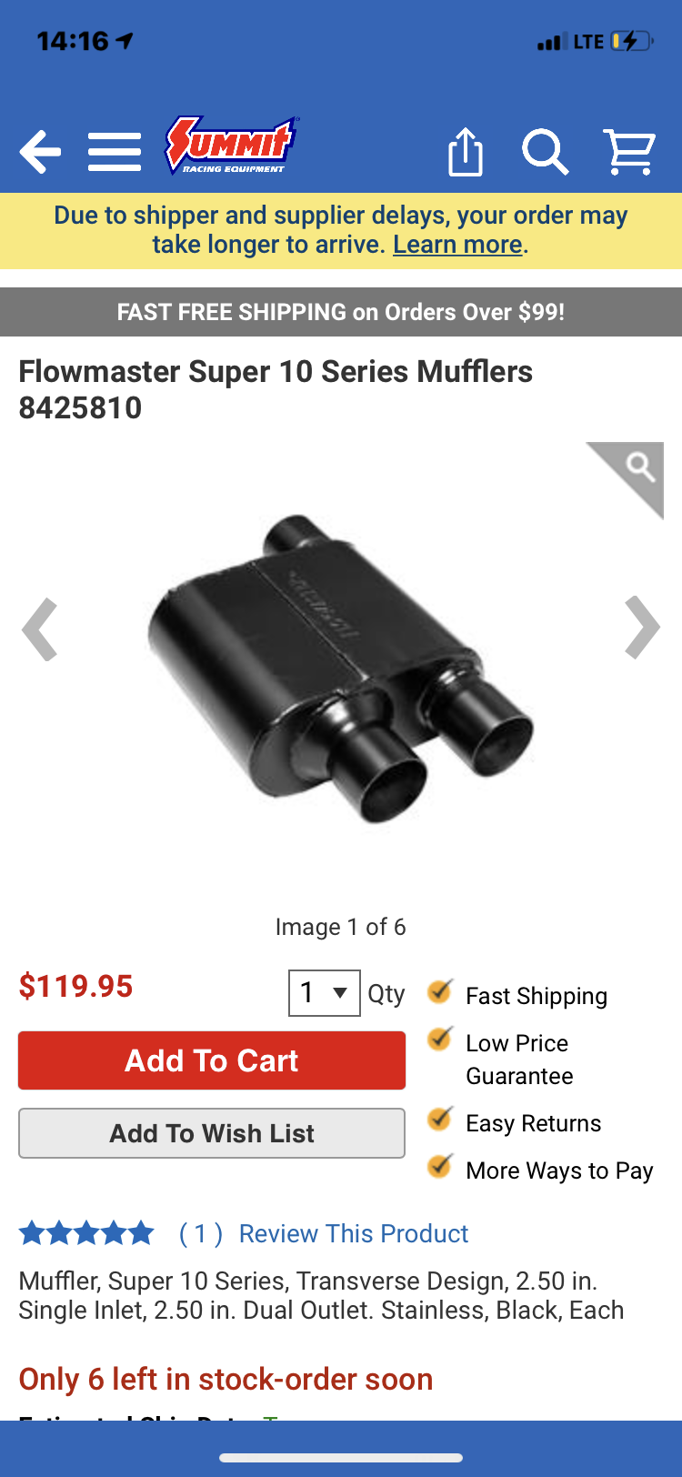

I saw a flow master muffler that looks like it will fit without cutting the trunk but have a feeling it’s going to be really loud which I don’t want lol here is a screen shot can that spin tech 343 muffler be sent to me so I can look it over[This message has been edited by pontiacfierokid1985 (edited 10-18-2020).]

I was able to get a decent fit with the 13" Spintech. Just had to dimple the lower left corner slightly for more clearance to the cradle. Spintech will build any muffler to specifications. Just call them and ask for a quote. Spintech uses non-restrictive circular, noise cancelling baffles in their mufflers. It make their mufflers the quietest for the given size.
