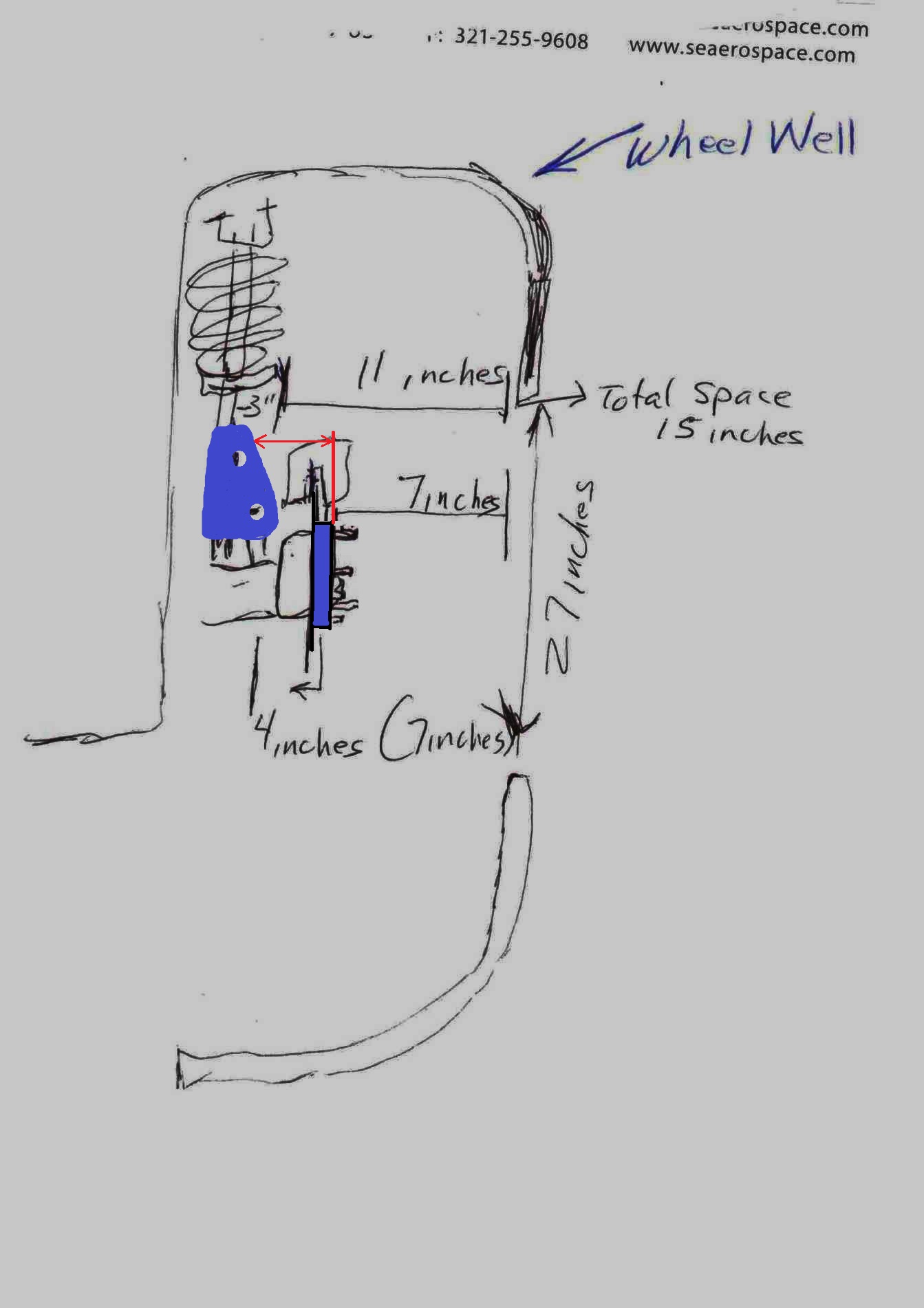

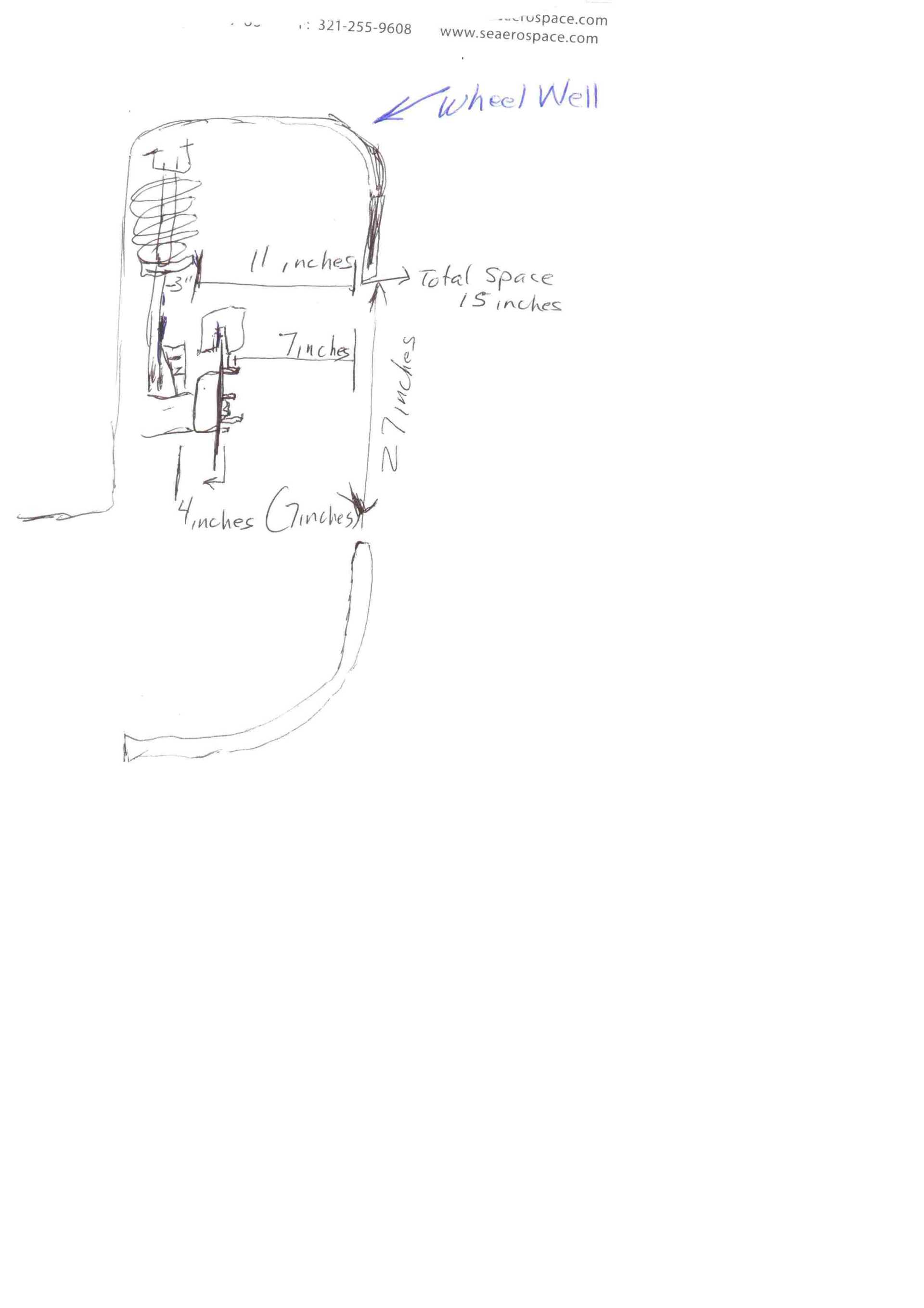

altownsend
OCT 18, 11:27 PM
Thanks for the wheel tire discussion. I have a request for wheel and tire combonation;
1986 Fiero, V-6, 4-Speed Manual transmission.
I have a very wide wheel well in the rear - see photo.
I am asking for recommendations on wheel and tire combo that will fit my application. In the rear, stock suspension, I have a total of 15 inches between the inside well and the outside of the fender lip. I want to get a wide enough wheel and tire to fill up the space. Thanks
I want to get an off of the shelf solution. Please comment
cvxjet
OCT 19, 04:08 PM
You need to pay attention to the measurement I marked in red; Distance from mounting surface to strut for WHEEL clearance.....That is if you are running coil-overs. If you aren't then you need to watch the clearance between the spring seat and the tire.
