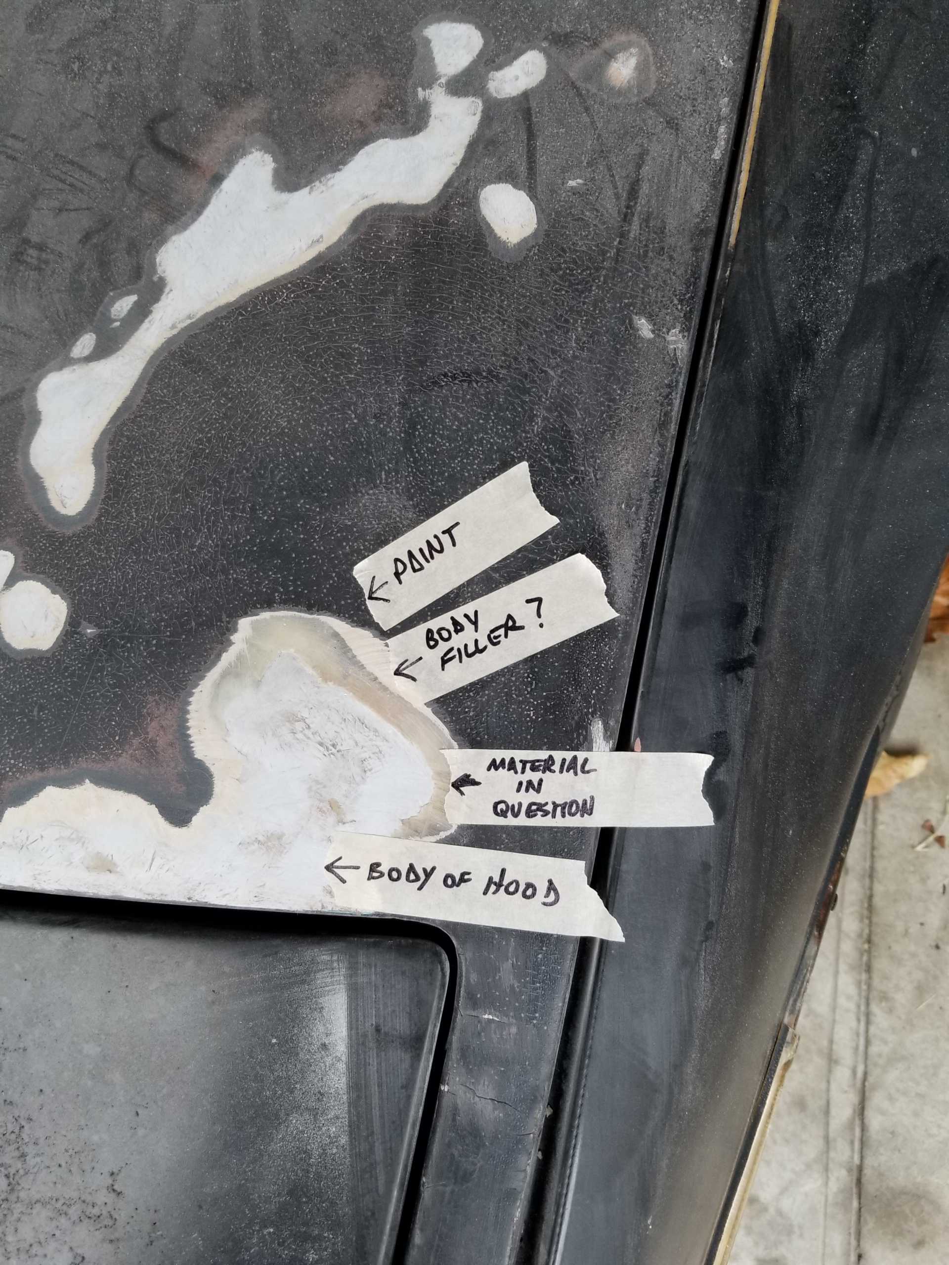

A few minutes ago, I was sanding away the loose chunks of material on the hood of my '86 GT in preparation for restoring the original contours and applying paint products. In the process, between the paint/primer and the stranded 'glass, I noticed what appeared to be a layer of gelcoat. Is this correct, factory work, or a prior owner's (or shop's) attempt at a repair? Just want to know before I proceed. Thanks in advance - Chris

Post a pic of what you are coming across. I don't remember the SMC having a Gel coat, but it has been a while since I painted one, namely my 1985 Fiero. Man I miss that car; only had 4 cylinder but paid $1800 for 18k miles on it back in early 1990's.

Let's see how this shows up. 4 separate layers. Hope this gives an idea of what I'm looking at...

That mystery layer must be some type of Gel coat to give a flat surface for paint application. I can't remember the SMC finish and if was rough like fiberglass.
mrminty
OCT 16, 04:36 PM
I worked in a Chevrolet plastics plant for a few years where SMC van engine covers and Mailbu and Monte Carlo noses were molded out of SMC. Although it was fairly rough and the fiberglass was visible when the strips were put into the molds they came out relatively smooth after the pressure and heat were applied. They were nowhere near as smooth as the nylon Fiero quarters I later ran at the Pontiac pressed metal plant out of Dupont Bexloy nylon from 85-88 though.

Thanks, all so far. I'm curious as to whether fiberglass resin would work as a substitute for whatever this stuff is. Removing the chunks of it left about a 3/16" dip in my hood...

The '"material in question" looks like fiberglass resin to me. Is it clear looking & produces white dust when ground? If so that's NOT the proper way to fix SMC. If I were you I'd scrap that hood & find a replacement - unless it's just a small area then you can grind it out & use SMC filler to repair it.. ~ Paul aka "Tha Driver"

Yes sir, clear with white-ish dust when sanded. It fits in about half of a 4" x 7" rectangle...
