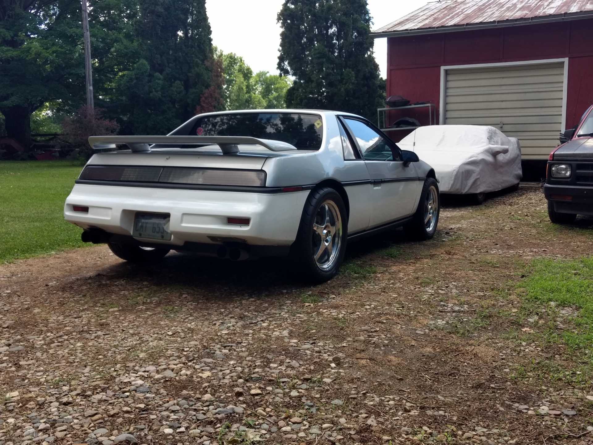

For earlier cars, it is my opinion that 35mm is the optimal offset, front and rear. For 88s, I prefer something between 38 and 48mm. If I didn't have 38mm wheels (17x7) on the front of my 88, I would say 40-48mm.
One thing that people tend to overlook is that 88s tend to sit a bit high in the front, which seems to exaggerate the wheel sticking out. Fieros - especially 88s - that are lowered in the front tend to tuck the wheels under the fenders a bit, or at least give that illusion.
This is my 88 with 38mm wheels on the front. Lowered by one coil.
And yeah, pmbrunelle... I would certainly expect that the "more tucked in" wheels would help with steering effort and kickback on the earlier cars, too.
I agree, with one caveat. For daily-driving use, I run 16x6 42mm offset Sunfire wheels on my Formula... but with the addition of 1" spacers in the back. IMO, this positions the wheels, both front and back, in/out to where they look best. (205/55/16 tires in the front, 225/50/16 tires in the back.)[This message has been edited by Patrick (edited 10-05-2020).]
OCT 05, 09:05 PM
Even better. No argument from me. Different means to the same end, essentially. All things being equal, the 88 fronts tend to stick out more than is "aesthetically pleasing" - steering/handling considerations notwithstanding. My white car in the pic above has 17x7, 38mm wheels on the front, with 215/45-17 tires. The rears are 17x8, 35mm, with 235/45-17 tires. FWIW, my other car (the gray fastback) is the identical setup, except that the fronts are 48mm offset, instead of 38. I really don't notice a great deal of difference in the steering. But it does look a little better, IMHO.[This message has been edited by Raydar (edited 10-05-2020).]
