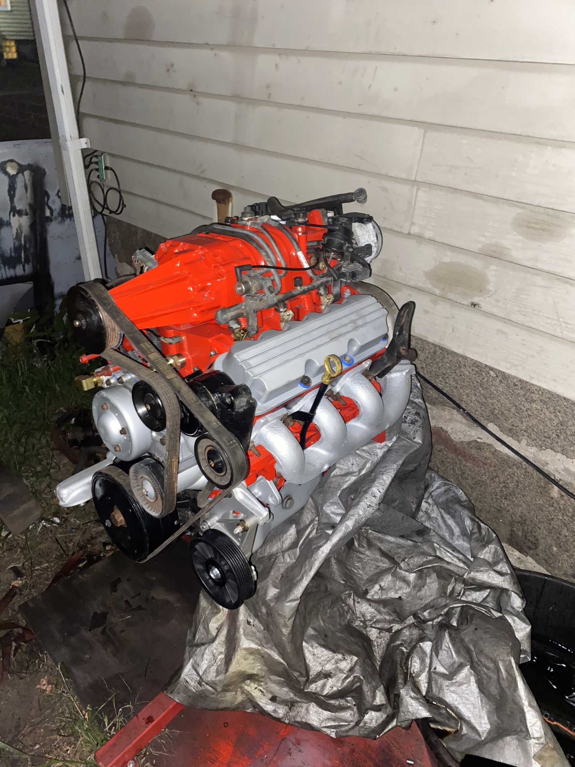

Can people provide videos and part numbers for a muffler to go with on my 3800sc build I’m getting all parts in order dropping cradle out today I know tons go with the spin tech muffler but are there any other out there that will be the same size in diameter as the stock fiero one to fit up in front of the trunk. I don’t want to cut my trunk out so that isn’t a option here I’ll be using the stock manifolds and cross over if this helps and I want it to be at least a 2.5 inch exhaust so it can flow somewhat decent
