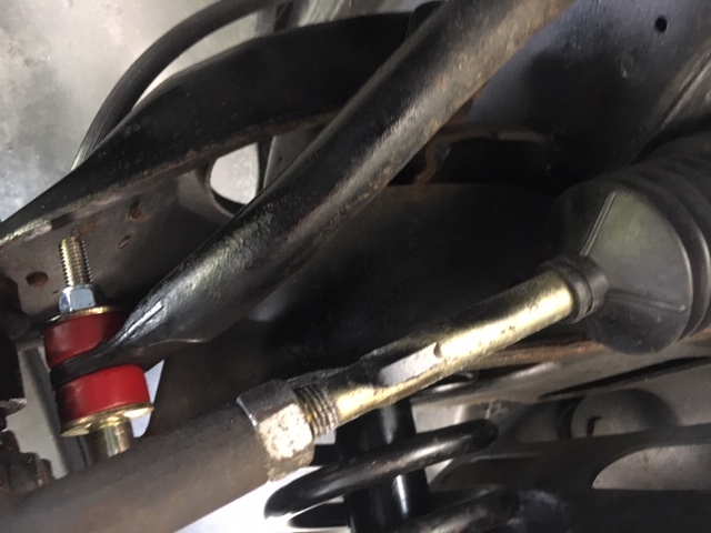

Is it me or does it look like the sway bar bolt will hit what ever is above it if the suspension is loaded??
Bob
ltlfrari
SEP 24, 08:58 PM
That's the upper A arm above it I think so it will move with the suspension so no, it should not hit.

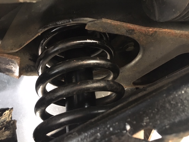

I removed the Shock, Sway bar bushing, and the upper bolt on the hub assembly with a jack under the "A" arm. Lowering the jack allowed the hub assembly to drop low enough to get the spring out and replaced it after I cut it. I never touched the "A" arm bolts. Should I remove the wheel. Jack up the "A" arm and tighten the bolt?

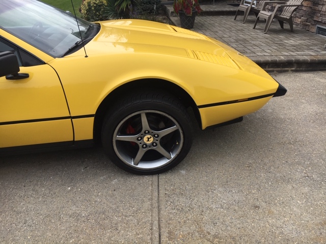

Make sure that the spring is seated correctly, at the top. If it isn't, it'll hold the car up to about the same height as a spring with one more coil than it really has. I can't speak to the Mera, but in this pic, the car has had exactly one coil removed from the stock front springs. 88.

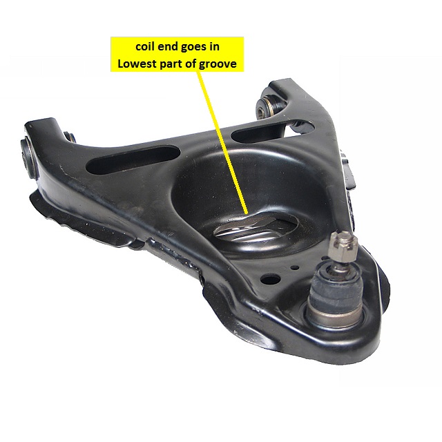

One thing some people make a mistake with is the Coil end must seat in the end of the groove in the lower arm...If not it will ride higher.
 [This message has been edited by cvxjet (edited 09-25-2020).]

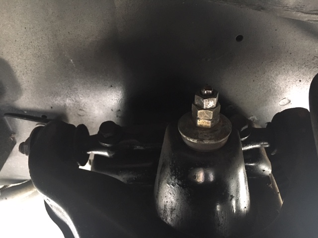

I use stock springs plus a Rodney Dickman 0.5" lowering ball joint along with the stock tire size (265 x 50 x 15) and it looks decent or better.
Nelson
