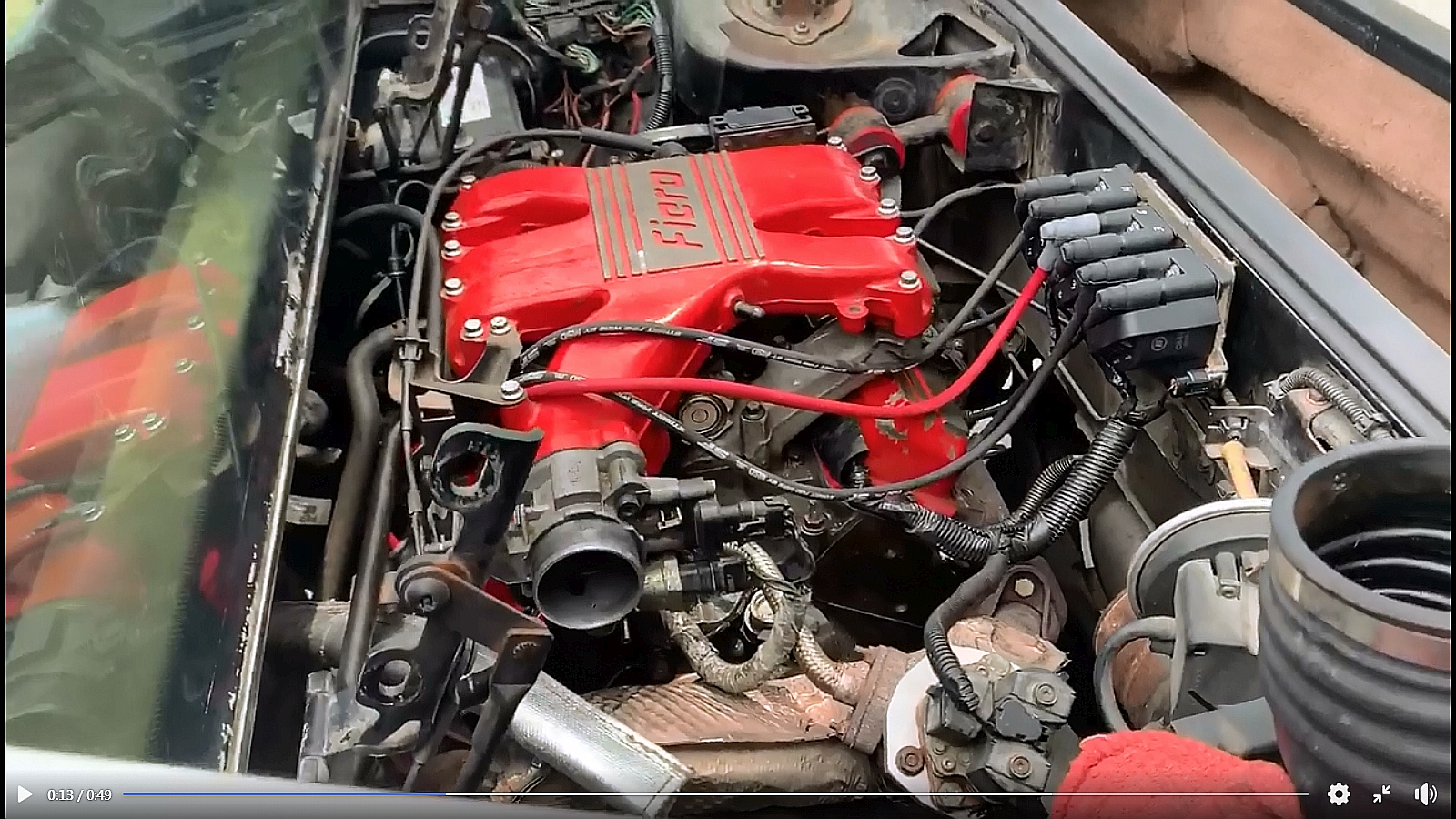

Need help. (Posible electrical/spark issue).
When I turn the engine on, it make a loud ticking sound, like spark sound. When the Plug cable number 6 is unplugged, the sound goes away.
Things that have been done 1. Swapped the spark plug 2. Swapped the spark plug cable 3. Changed the coil 4 changed the ignition coil plate.
Any ideas is greatly appreciated.
Link to Video on Facebook https://www.facebook.com/ce...s/10223511010114085/[This message has been edited by Ceez11 (edited 09-14-2020).]

Look for an exhaust leak on that cylinder. Yes....exhaust leaks can make a ticking sound even though that seems odd.

My buddy and I also checked for exhaust leaks and replaced one of the manifolds that was cracked.
The sound occours when spark plug wire number 3 is connected, when I unplug the wire the sound goes away and of course it runs crappy.
The issue began with lossing power/ compression maybe? And then it escalated to a loud sparking sound comming from the air intake.
I hope this gives a better understanding of the issue.

Wait... so is it cylinder #6 or #3? Also, the fakebook link says "content not available".
Anyway, a ticking noise coming from the intake area could also be a bad lifter. You could try a relative compression test. The cylinder with the bad lifter should have less compression than the rest.
SEP 14, 04:11 PM
You'd make the video accessible to a lot more people if you uploaded it to YouTube. You'd also be able to embed the video right here in your post.
I'm not familiar with how those coil packs are wired/numbered, but are you sure you don't have some of the plug wires connected to the wrong plugs?

It is cylinder #6. Tha should be our next step. We did looked at all lifters but we didn’t do a compression test. ------------------ Cesar G

The tick does not follow engine RPMs!.....it's more like a miss in the high voltage.[This message has been edited by Gall757 (edited 09-14-2020).]

SEP 14, 09:51 PM
