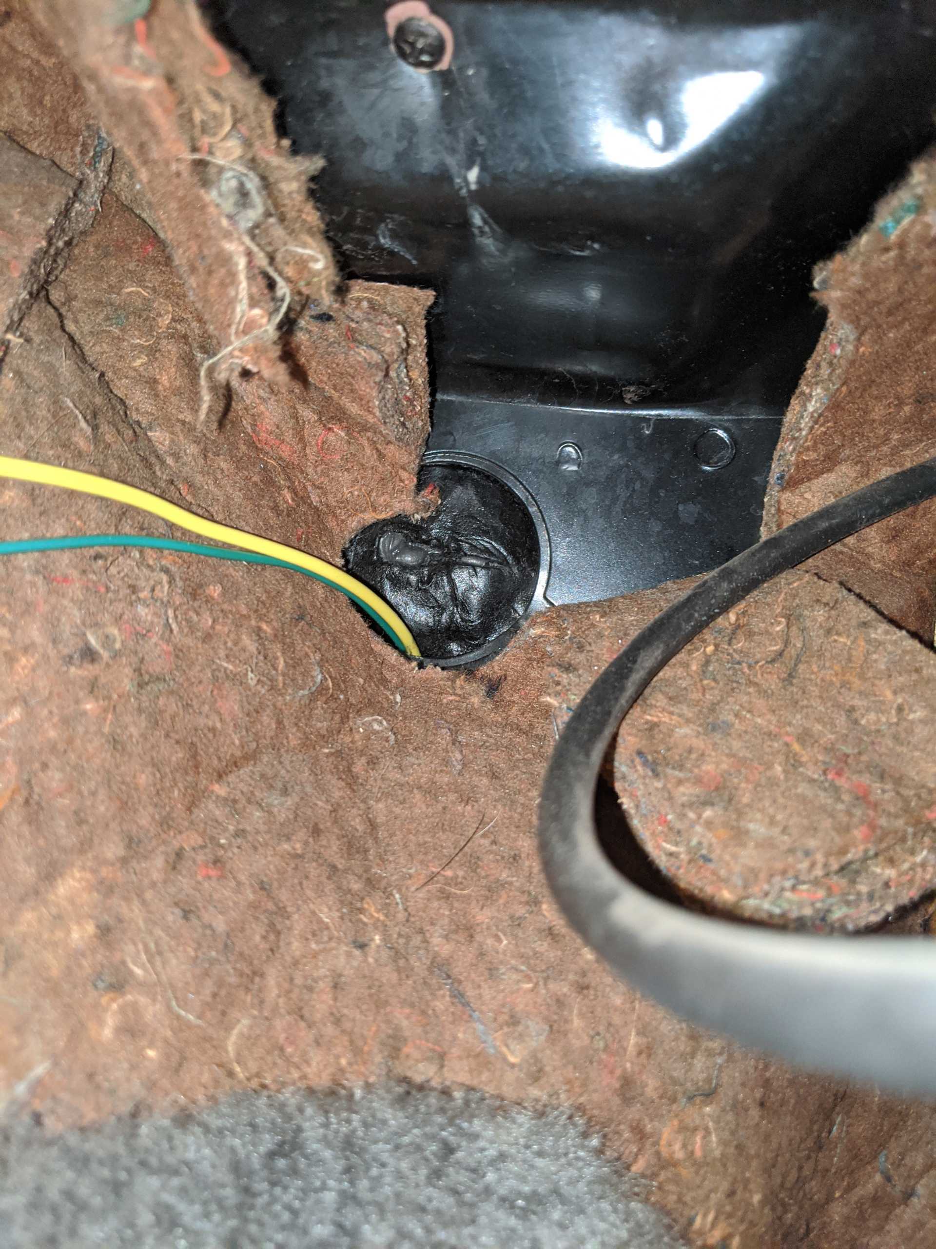

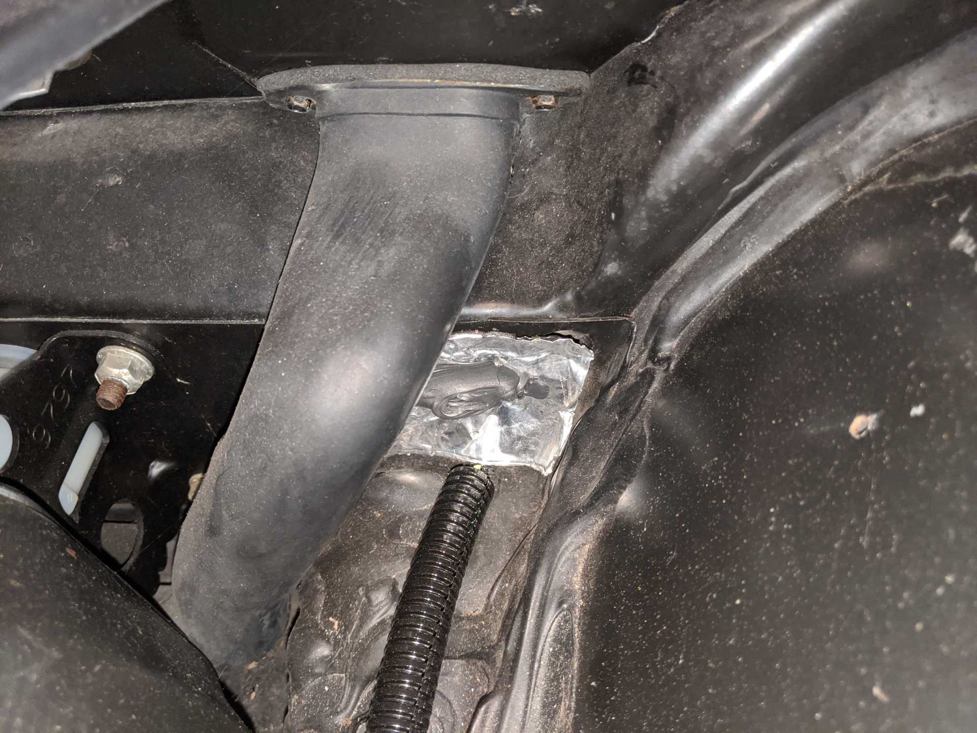

rbell2915
SEP 08, 04:46 PM
Inside the cabin. Wires go through the hole for the clutch.
In the front compartment.

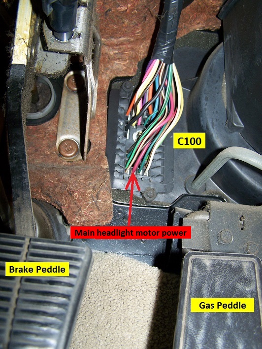

cmechmann
SEP 08, 05:41 PM
Depending on the gauge of the wire. If you want to keep the clutch hole open for other things, there is a bulk connector above the gas pedal. This is where the wiring for the HVAC, radiator fans and some lighting. If you only have a few wires, there is normally a few places in the bulk connector that don't have spaces occupied.

cmechmann
SEP 08, 08:24 PM
Some more info.
