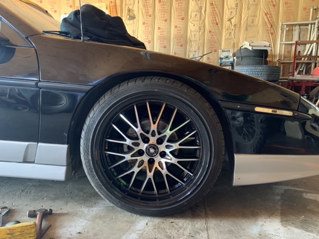

I have 18x8 35mm offset on our 87 GT. They don’t rub anything. Bone stock suspension. Just cut 1 1/2 coils off the front today

Just want to let you know the 35mm offset is perfect for the 87. I have that and my wheels are just about flush with the body lines. I can not speak on clearance because I have coilovers are the way around.
