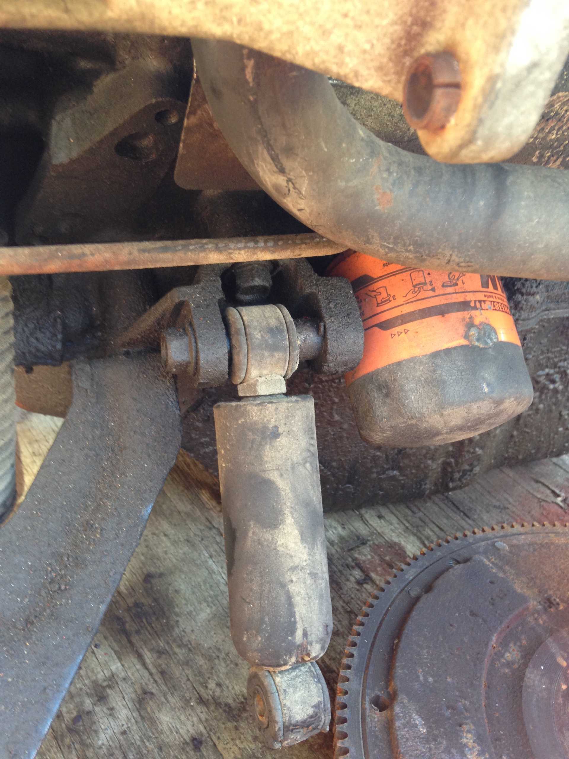

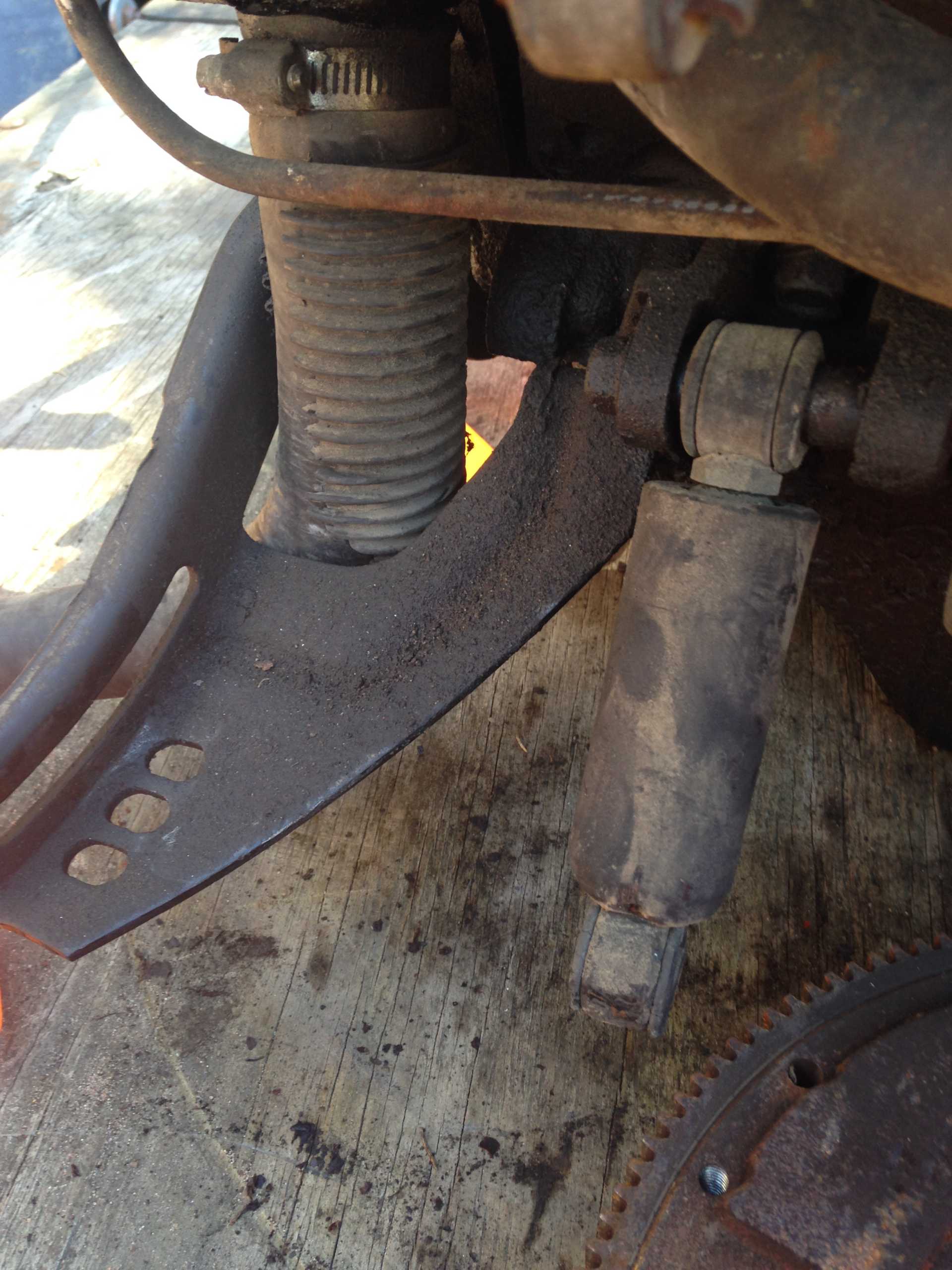

Hi to all,
There is a shock absorber like device on the front side of my 2.8L engine. It isn't in the car yet.
fierofool AUG 01, 10:16 PM
It is a torque shock that was on the 85-87 V6's. It has a bracket that bolts to the cradle. It was eliminated on the 88 for some reason. It supplements the dogbone to reduce front to rear engine movement when accelerating and decelerating.
If yours doesn't have much resistance or is frozen, you can get a new replacement from RodneyDickman.Com
