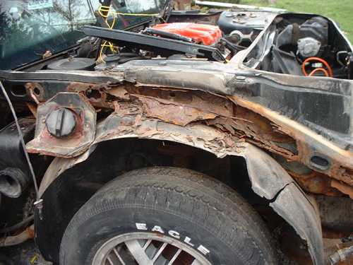

I know this may be a stupid question but are you sure the upper frame rails haven't rusted through? It seems like you covered all the bases with the suspension so I would look at the frame just for the hell of it. Here is a pic from someone in Canada who had issues. You need to remove the wheel well liner to see this part of the car. If this is the issue, unfortunately the car is finished.
You can see that when this occurs, the only thing holding the entire rear of the car together is the front cradle mounts.
So, they have certainly not rusted through, there is next to ZERO rust on the vehicle (it is from New Mexico and the body has like 50k miles).
The only way I could see those nut housings being loose is if they got over torqued and broke the welds, but I was able to get them as tight as ever when I checked just now.
