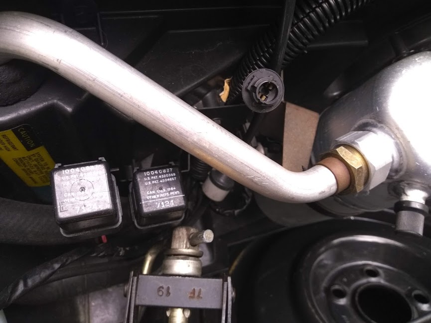

| Any idea what this plug is next to my AC drier (Page 1/1) |
england006
AUG 01, 12:18 AM
the ac is not working, should this be plugged in somewhere? [This message has been edited by england006 (edited 08-01-2020).]

That is a socket for a 194 light bulb.
When the parking lamps are on, and you open the frunk, that bulb is supposed to help you pack/unpack your baggage at night.
Near the relays is supposed to be a sheetmetal bracket with a cutout where that socket can fit into, to hold the bulb socket securely, rather than having it dangle around.
Looks like your Fiero doesn't have the bracket installed. I don't know if they came standard on all cars. You can get a bracket though from a junkyard Fiero.[This message has been edited by pmbrunelle (edited 08-01-2020).]

Yeah, that's for the under-hood light. It doesn't affect the A/C.
AUG 01, 06:40 PM
Yes is "spare tire light" socket but many have a wreck switch so that and ajar light don't light w/ hood open. Most to all have the socket but not the bracket and bulb from factory.
Yes, this won't affect AC or anything else.
