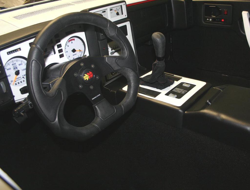

Yes, you need an adapter. Whatever brand steering wheel you buy, that company should make an adapter hub. I used a Momo on mine:

It extends slightly closer to you. Here is the adapter: https://www.amazon.com/84-8...dapter/dp/B008TZPEKO
The wheel is a Corse Sport. I don't know if they still make that style and used they sell for about $220 but the wheel is up to you. Any Momo with 6 holes will fit the adapter.[This message has been edited by IMSA GT (edited 07-27-2020).]
