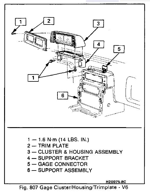

You have to remove radio/heater trim plate and loosen radio surround to remove gauge cluster.

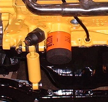

Non A/C car has it down by oil filter.
A/C car has tube relocating it near front of head.

I got rid of that ac setup and just went with the 88 style sender. I mounted it down low so it is no longer an eye sore.
