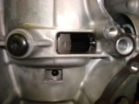

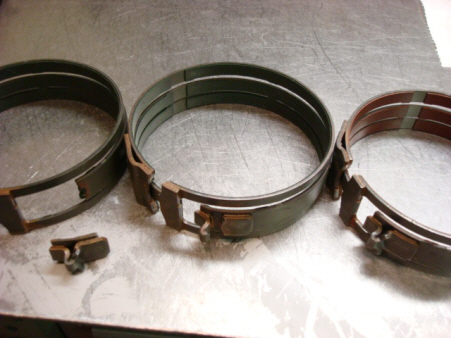

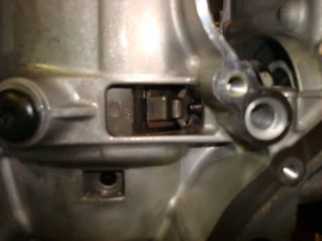

I swapped a 3800SC and 4t65e-hd out of a 2001 GTP about 1.5 years ago. Driving was great until about a week ago when drive and 3rd gear went out. I still have R, 2nd and 1st. I've done some research and it appears I have a broken 1-2 forward band. I've searched this forum and unless I'm missing something I haven't found anyone that has had this same issue. I'm wondering if this is normal, can this be fixed with the trans still in the car or is this a drop cradle and remove trans repair? I found these images talking about the 1-2 forward bands at tripleedgeperformance.com and they make this sound like a common issue on the non HD version of this transmission. How similar are these transmissions and has anyone heard of this broken 1-2 forward band issue? Broken band in Trans -  Broken bands -  Good band in trans -
