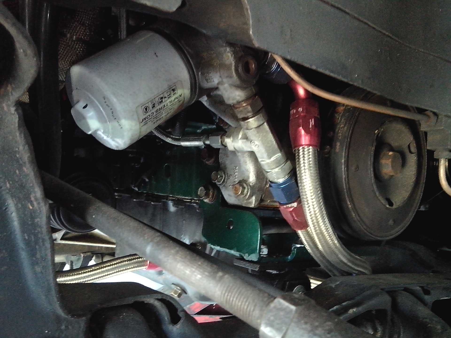

This type of oil filter bracket with provision for oil cooler lines came off a series 1:
Really usefull for high power mods!
