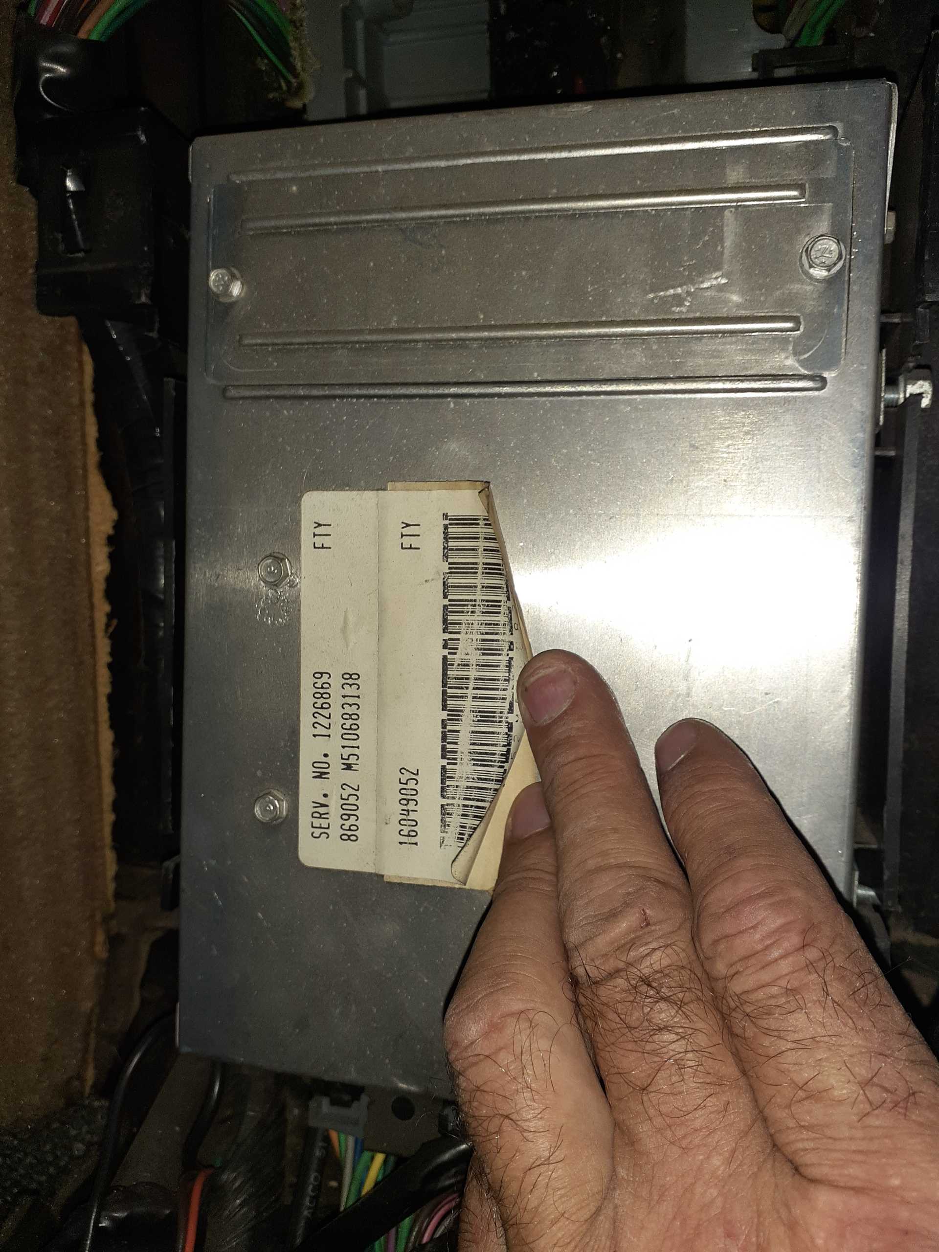

Daryl M
AUG 06, 08:08 PM
This is in my 86 GT 4 speed parts car. I drove the car into the garage, so it seems to work.[This message has been edited by Daryl M (edited 08-06-2020).]
Gall757
AUG 06, 10:05 PM
| quote | Originally posted by Daryl M:
Yes, 1226869 is the only other ECM that was used on 6 cylinder Fieros. It was used for 1985 and apparently early 1986 cars, and will work in '87 and '88 cars.
