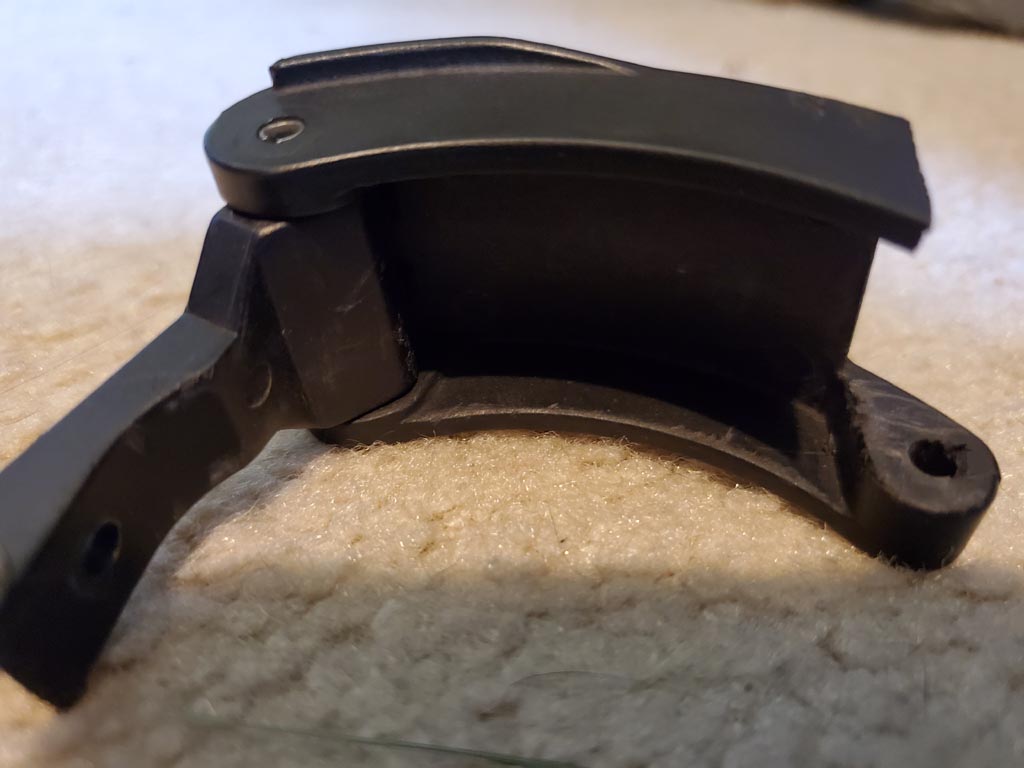

I was putting up my convertible top the other day and the latch broke. I was wondering if any knew of where I could get another. I looks like a generic plastic latch. Here is a picture. If you need more let me know. Any help is appreciated.

Can it be scanned and 3-d printed?
JUL 14, 10:18 AM
That is the latch that was on the Brisa/California Convertible convertible top. That top is on my 85GT. The company is long gone and it was never announced who got the parts when they closed. There are some aftermarket convertible top kit manufacturers that still make convertible top kits for other cars like the Miata. You might try seeking them out. If all else fails that part can be duplicated by a machine shop. ------------------ " THE BLACK PARALYZER" -87GT 3800SC Series III engine, custom ZZP /Frozen Boost Intercooler setup, 3.4" Pulley, Northstar TB, LS1 MAF, 3" Spintech/Hedman Exhaust, P-log Manifold, Autolite 104's, MSD wires, Custom CAI, 4T65eHD w. custom axles, Champion Radiator, S10 Brake Booster, HP Tuners VCM Suite. "THE COLUSSUS" 87GT - ALL OUT 3.4L Turbocharged engine, Garrett Hybrid Turbo, MSD ign., modified TH125H " ON THE LOOSE WITHOUT THE JUICE "

| quote | Originally posted by Mike in Sydney:
Can it be scanned and 3-d printed? |
Scanning a piece like that would be more trouble than it's worth, IMO, but you're on the right track with printing. You'd have to CAD it up, but that looks like a simple enough piece to draw.
Printing it ... hmm. I think you'd want a stiff material like nylon, as opposed to the more typical ABS which has a bit of flex and tendency to snap.
Madess, if you absolutely run into a dead end, shoot me a PM, and we can discuss options. At the least, if you can get the part to me I should be able to draw it up for you, maybe get you an ABS prototype of the bits. (I've had mixed results doing nylon so I don't want to make promises that I could make you a workable one.) From that point maybe you have a professional print house make you a "real" one.

Oh, and you might ping these guys
http://www.sunroofdoctor.com/
with Dennis' info above, see if they have any wisdom. I have zero experience with them save that I've read their web page while looking for other stuff.

Thank you for the responses, I emailed the sunroof place, and I will see what they come back with.
My brother in law works at an engineering firm, so I will try the drawing and printing next.
