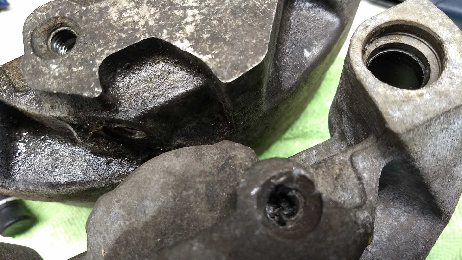

I have all 4 calipers off, stripping them for the long awaited powder coating.
They have to be stripped and rebuilt, of course.. and front right was in no mood to comply.
I really did try, heat and WD40 and that.. and.. it broke off.
I drilled and backed out and drilled and backed out and all I have to show for it is a stripped hole.
I hate brake bleeders.
So TFS has the caliper for $80. Sigh.

fieroguru JUL 12, 09:20 PM
If the bleeder doesn't come out easily the very next step is to cover it with a 1/2" nut and weld the center up. While it is still red hot, hit the top with a hammer.
Let it cool and it will come out w/o issue. Don't mess with all the other stuff... Extreme heat from welding will break any steel bolt or stud loose in aluminum... every time.

Chris Eddy JUL 12, 09:44 PM
Right you are.. Autozone was teasing me with a short skirt. Looks like TFS.. with no good core!
And on welding.. I should have handed it off to someone that could, I cannot.

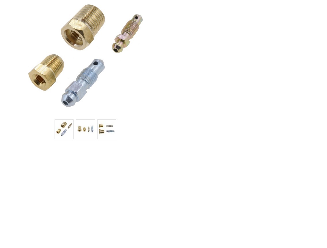

Larryinkc JUL 12, 10:26 PM
I haven't tried one of these kits but I would in your situation.
Dorman - HELP Brake Bleeder Screw Repair Kit
https://www.autozone.com/te...3105_0_0?CAGPSPN=pla

Thunderstruck GT JUL 13, 12:25 PM
I never had a bleeder screw I couldn't get out. Not even on my 1962 Pontiac Grand Prix.
I first try Castle Thrust penetrating oil and an air hammer. Spray the oil a few times for a full day or two. Then rap the area near the side of the screw with an air hammer. Then use a 6 point socket on a 1/4" drive ratchet, working it back & forth an 1/8th or 1/16th of a turn at a time.
If that doesn't work I take my acetylene torch and using a small brazing tip, heat the area up around the screw, hit it lightly with the air hammer, heat it again and remove the screw with a 6 point socket on a 1/4" drive ratchet.
Doing it any other way or rushing the process and you will be buying a new caliper.

vette7584 JUL 13, 09:21 PM
brake bleaders twist off for a couple reasons, in tight, corrosion, etc. next time try this, it does work and they do make kits for this. clean out the bleeder the best you can. take an old drill bit that is as close to the size of the hole in the bleeder, if it fits tight, even better. tap it in with a hammer as far as possible. use your favorite penetrating oil, i prefer kroil. it will back out almost every time. with the bleeder being hollow, when you try to remove it, it collapses in on itself. Put the drill bit in there to keep it from doing that. i have been doing this for quite a long time with good results
Chris Eddy JUL 13, 10:19 PM
I have the repair kit above ordered, and will follow Ogres protections to the letter.. Should get me under way with 4 usable calipers.
