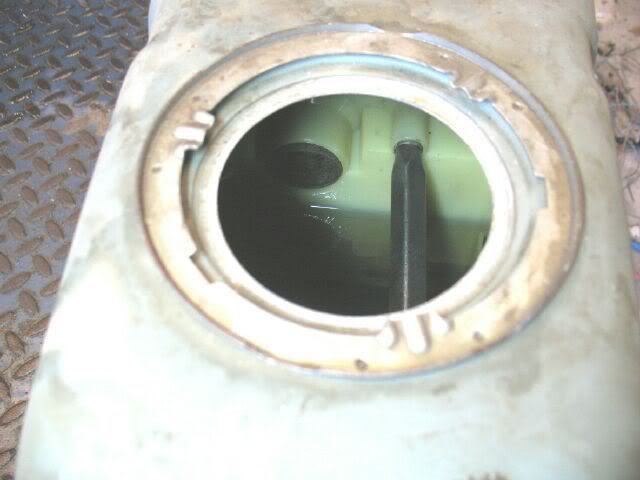

This is what the top side of the fuel tank with lines looks like, where exactly where you planning to install the aftermarket sender.

Nice Pic....but shows what I feared. The new sender inserts from the outside, not adaptable to install on the inside.
Sure looks like a new opening will be required.
So: dare I just cut a new opening, use gaskets and sealer, or bite the bullet and have a weld flange installed on the new opening?
They DO make block off plates, but then I need the not only put the sender through, I would have to come up with some way to transfer the tubes to the block off plate.....

The tank is also not entirely open inside. There is a plastic baffle liner that mostly encloses the area around the stock fuel pump and level sender. The fill and vent tubes also run down the back half of the tank to the center as well.
