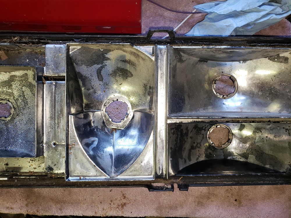

No surprise how bad they were. Most other old cars are same including Fiero notchies and think just use hotter brighter bulbs and lights still suck and that's even before LED added their own issues. At lest you can clean/fix Fiero rear lights fairly easy. Many others is very hard just to clear them.
note that there are 2 or 3 "holes" maybe more to vent "water" at bottom where parts meet. Don't block them. Not sure where they are for a GT taillight set.------------------ Dr. Ian Malcolm: Yeah, but your scientists were so preoccupied with whether or not they could, they didn't stop to think if they should. (Jurassic Park)

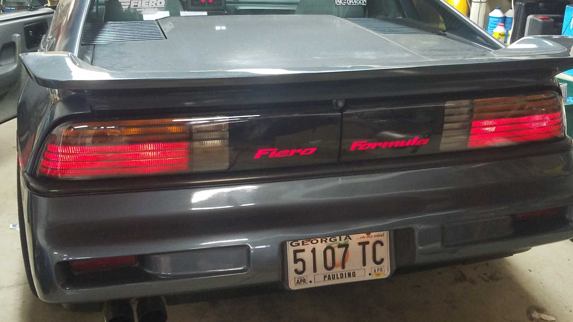

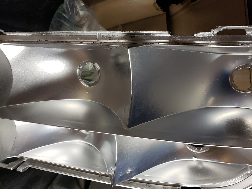

Thanks for taking the time to post a description. My reflectors were pretty ugly too. Just for grins, I painted my reflectors white. It seems to have worked out okay.

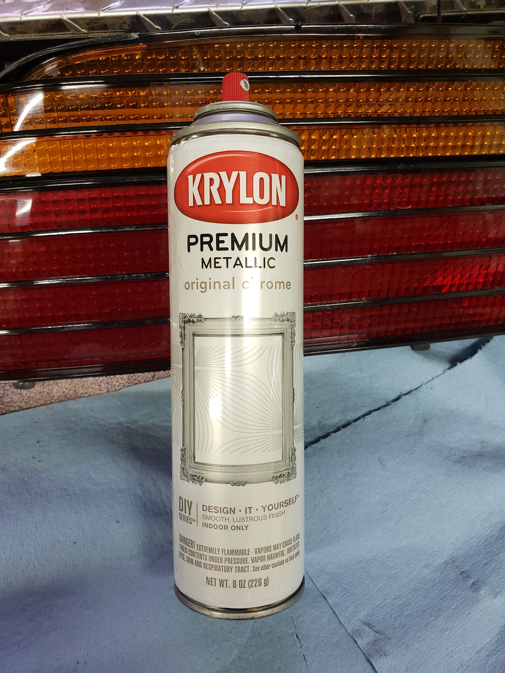

Good job. I've used Chrome silver paint and it does make a difference in brilliance. The LED lights that I just added took things to the next level.
V8Steve
JUL 09, 07:59 PM
Dennis, Thanks for your input.
I did a lot of research on the paint but I'm no expert. I'm a good mechanic and passable MIG welder, but lacking in experience with paint. Based on reviews all over the place, it seemed like a good solution. Time will tell. Meanwhile...put miles on my finally finished restoration that began in July 2015!------------------ 88GT 355 CI Sequential Holley Multiport , AFR milled 180, Dyno'd at 427 HP, 320 WHP anderson@gdsconsulting.com
