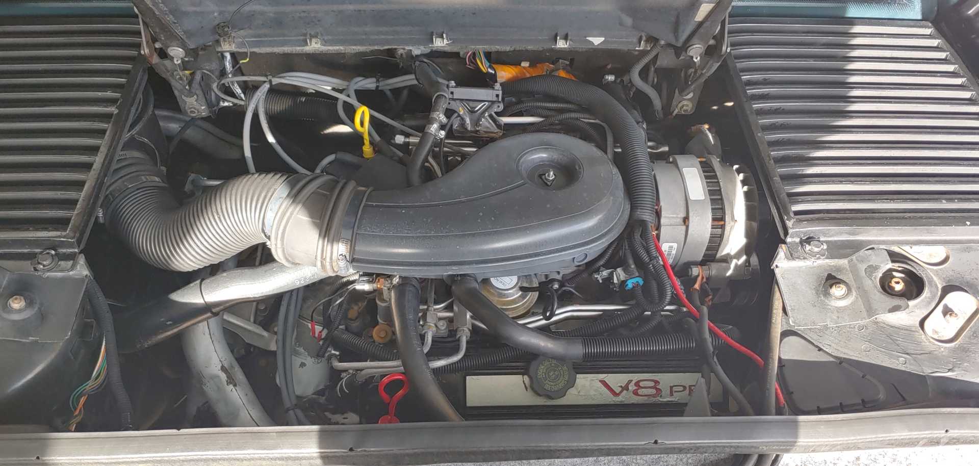

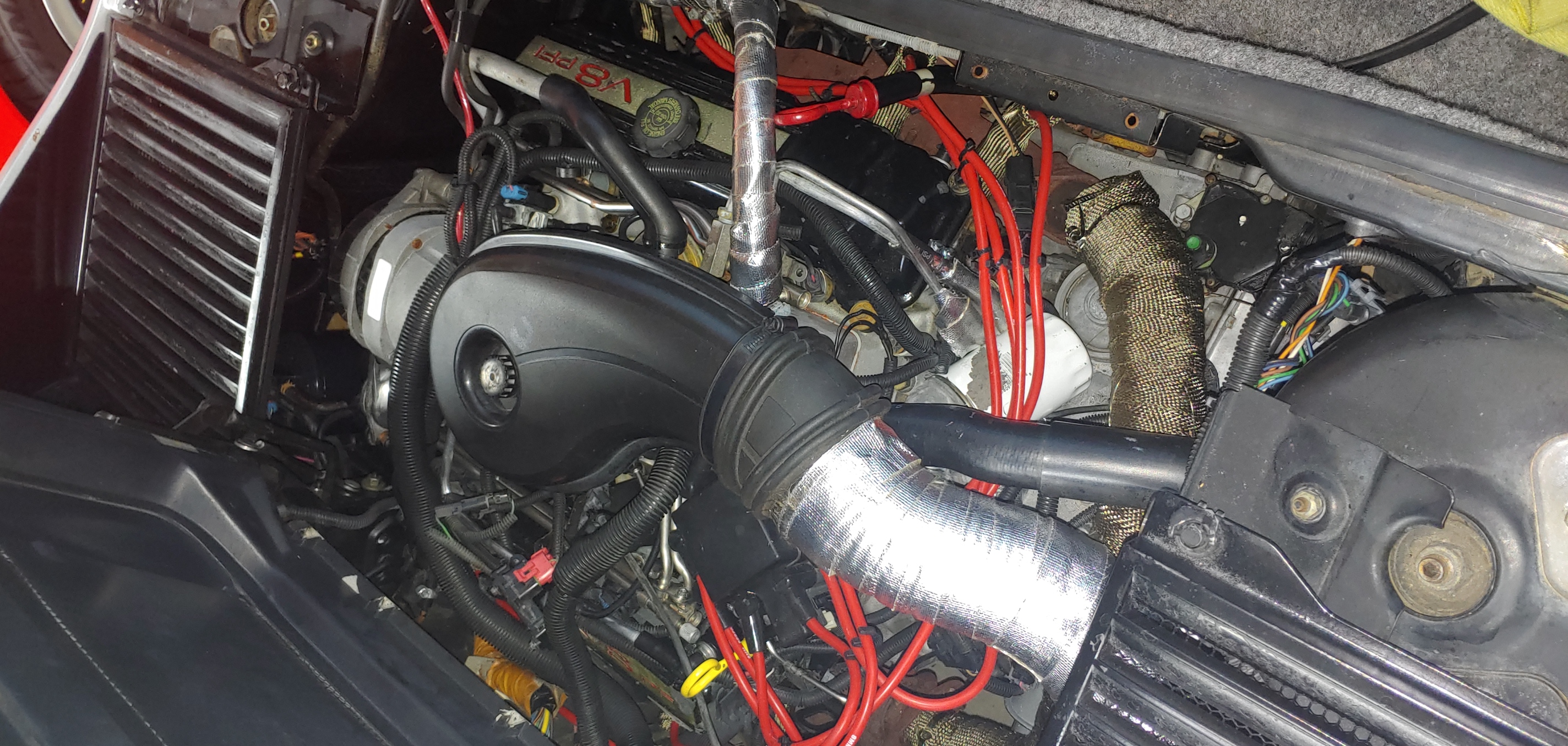

Very nice car. Do you know who did the install? Please take a few pictures of the engine bay and post them. When you say misfire, is the engine backfiring, stumbling, or just sounds rough? Are there any code you can read with a code reader?

I don't know who did the swap, it looks like a clean install minus a few things here and there.
