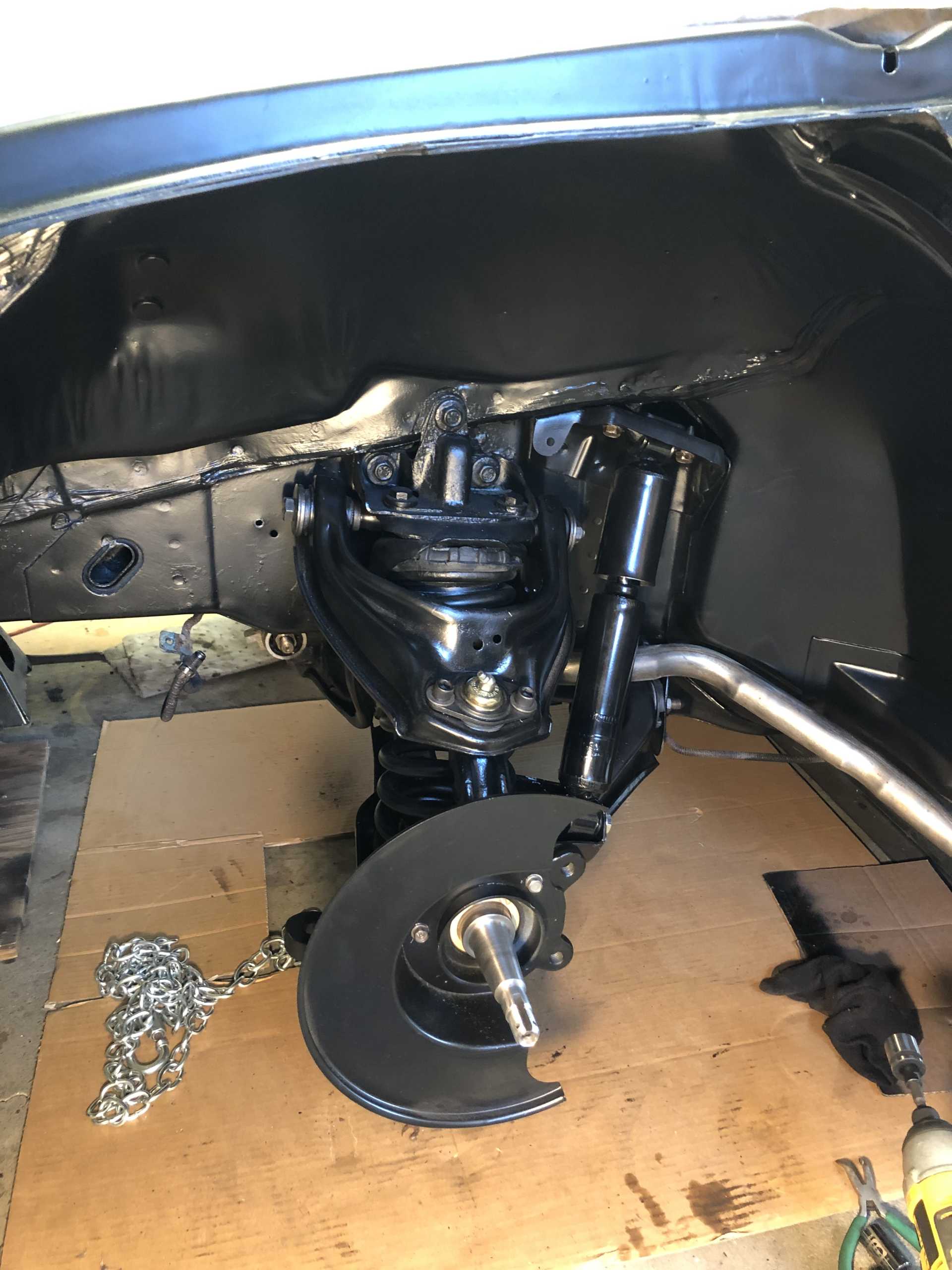

I know it’s been awhile since I last posted on this issue (was majorly sidetracked) , but I’m still having the problem of the boot pinching when installing the joint.
Please check out the pics below -- you can see how much the boot is being pinched/squashed on one side. The metal collar which holds the boot against the joint is in place, though not sure if it’s in the correct place:

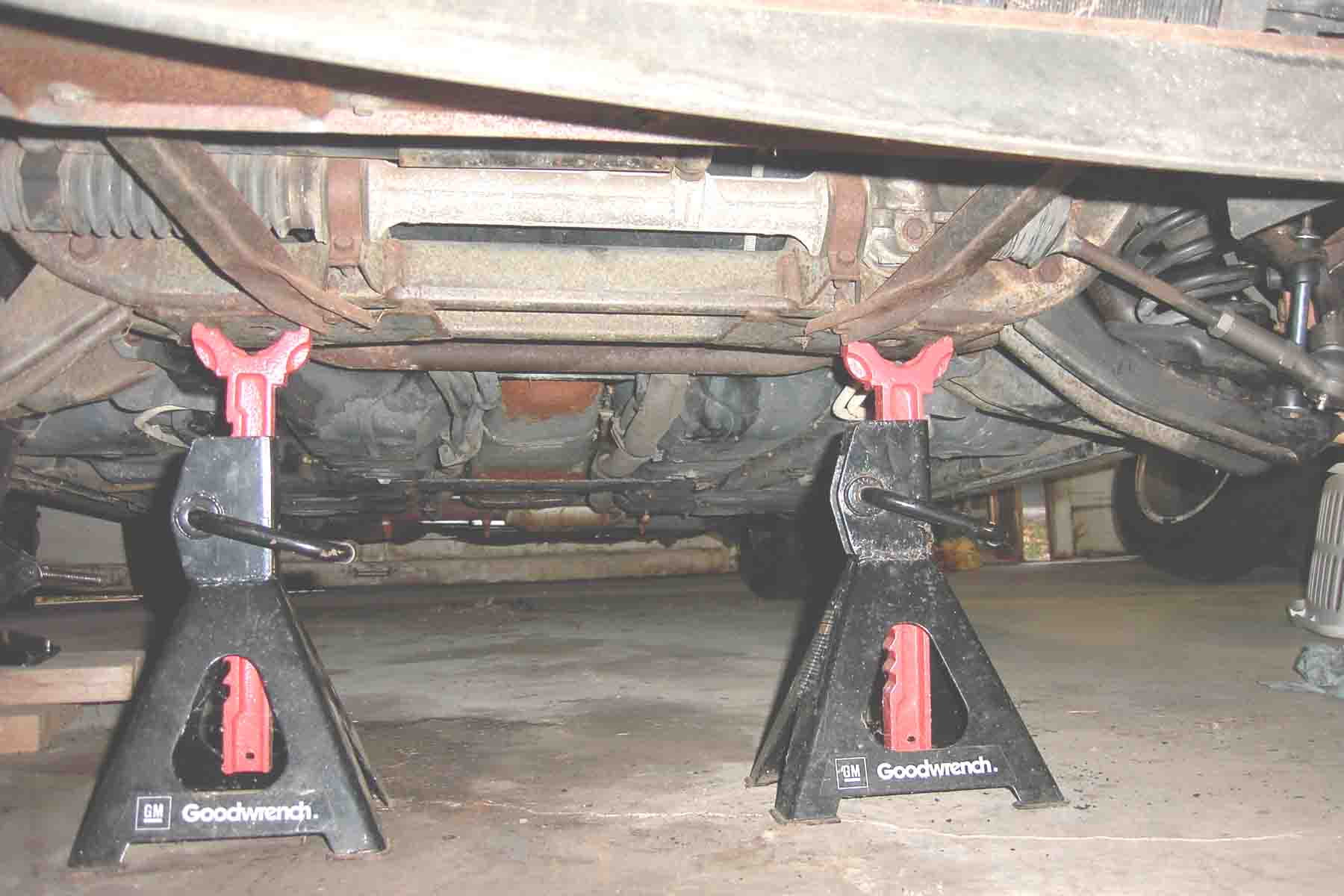

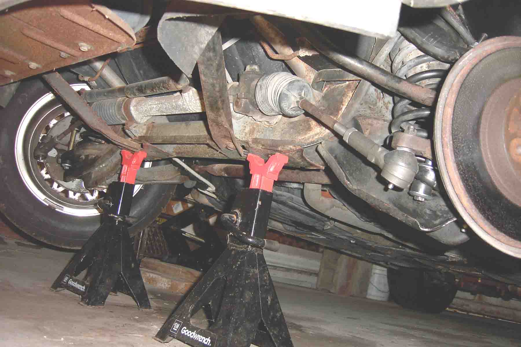

 I’ve searched for scenarios like this online and ran across this forum with someone talking about a similar case with a Chevelle (scrolling down about 6 times displays the paragraph). The guy talks about the way the front end of the car is jacked up may have an effect. Here is where I have my jackstands placed on my car:
Does anyone here have any thoughts or additional advice on what I’m doing wrong here?

Once you get some weight on it the ball joint angle will flatten out. Looks fine to me. [This message has been edited by PhatMax (edited 10-17-2020).]
OCT 17, 10:05 PM
quote | Originally posted by Brent7088:
You've still got the control arms hanging down. If it was me doing this, I'd have a hydraulic jack lifting the lower control arm of the side I'm working on... just enough to level it out while installing the ball joint.
It's been a long time since I've replaced ball joints, but is there a reason why you have the control arms hanging down so low? I think if you raised the lower control arm, things would look and/or go together much better.

Ok - that does make sense. I don't have anything else disconnected at this point, so I just couldn't understand why it still wasn't leveling out.
As Phatmax suggested I could just piece it all together, slap the tire on and see if it all evens out once it's back on the floor. If it doesn't I will jack the control arm up and redo it as you suggested.
Thank you both
OCT 17, 10:49 PM
Brent7088
OCT 18, 04:09 PM
Patrick - yea I understand what you're saying.. I wasn't seeing the bigger picture of how it would fall in place after the job was finished. I just kept thinking I was missing something or doing it wrong.. I'll do it your way and finish it up... thank you for setting me straight.
