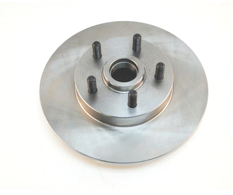

Do all new rotors like above come with the bearing race installed ? [This message has been edited by hunter29 (edited 06-29-2020).]

quote | Originally posted by dremu:
Umm, Patrick, are you thinking of the rears?
The stock fronts on 84-87, anyway, are one piece, hub and rotor. [Various upgrade options have separate rotors, but the stock ones are one piece.]
Damn, am I thinking of the front rotors on my '88 Formula?
Sorry Brent.
dremu
JUN 29, 10:40 PM
quote | Originally posted by hunter29:
Should do, yeah. Now whether that race matches your bearings is another matter. When I redid mine I just hammered out the new ones with a brass drift and put in the matching ones that came with my new bearings because they were there. All the books tell you not to mix old and new.
Oh yeah, and be damn sure the bearing grease is spec'd for disc brake, as they get toasty. General duty grease is no bueno.
-- A

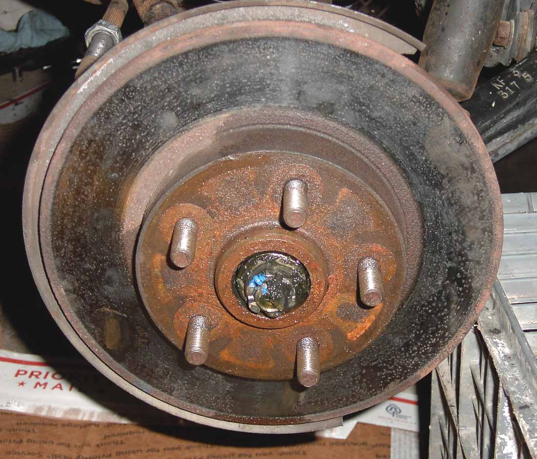

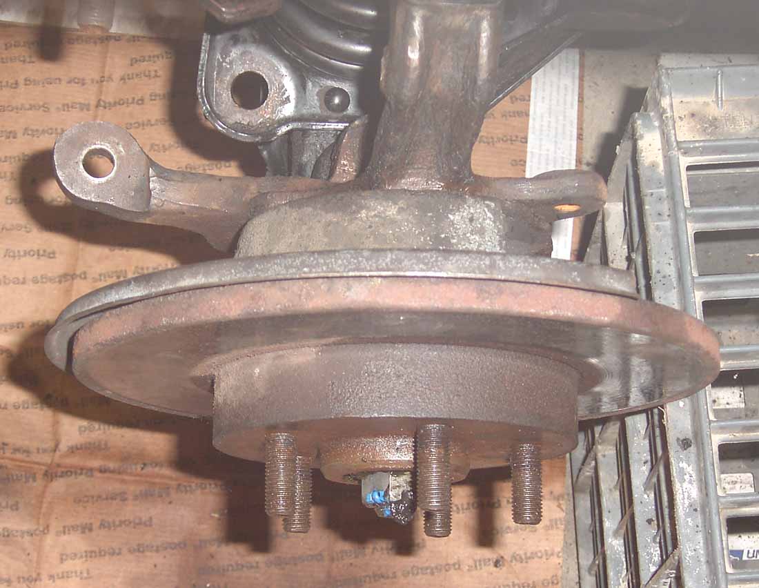

The whole purpose of wanting to remove the rotor was to simply get the rust removed and clean it up. While this is obviously the original rotor, there is actually nothing wrong with it to my knowledge; I had just planned on doing this while in the process of replacing my upper ball joint.
Taking a look at the pics here, does anyone think it would even be necessary to clean it up or would it be a waste of time? I understand if I do, I would need to remove the bearing assembly first, since it would be submerged in a rust remover (planned on vinegar).
