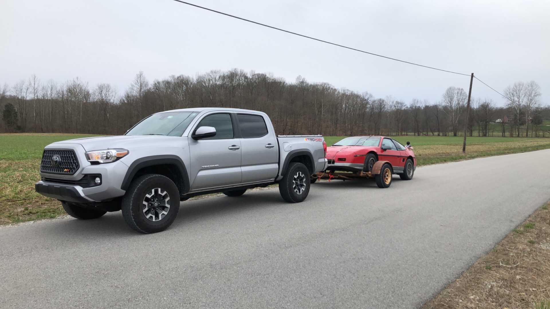

This past March, I finally pulled the trigger on buying a Fiero. I fell in love with Fieros in high school after first seeing a white fastback GT, and I didn’t even know what it was back then. I had an itch for a little project, something to tinker on. My buddy found a Fiero for sale about 4 hours south from me. We hopped in my truck the next day with a dolly to check it out. Little did I know it was going to be doing a lot more than “tinkering”

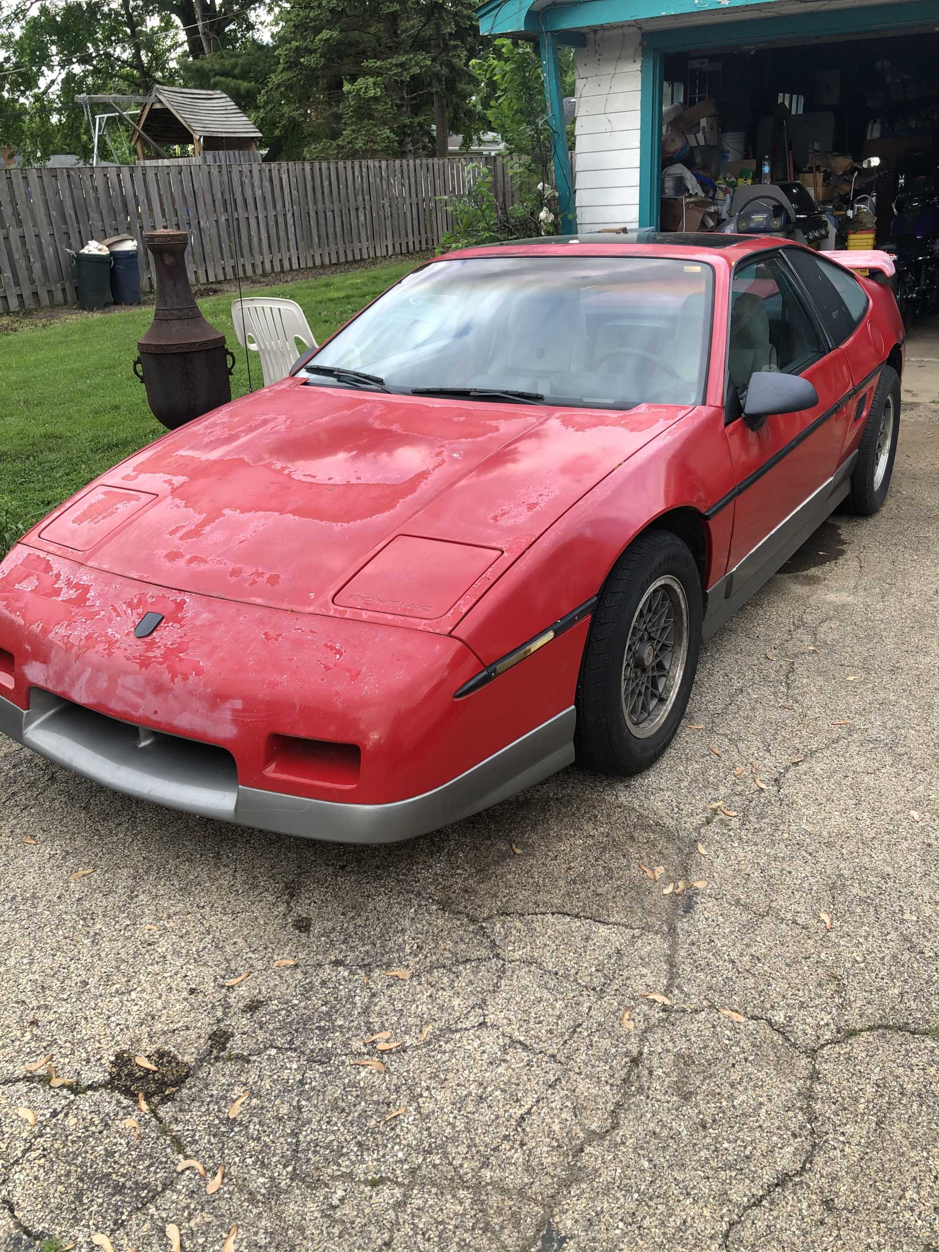

It’s an 86 GT 4 speed Had 147k miles on it. Supposedly sitting for two years, but evidence later on makes me think it was longer, but who knows Didn’t run. Underbody and truck were super clean. Only a small rust hole in the drivers wheel well and in the passenger wheel well as well. Nothing to be worried about. Floor pans clean. (Yes I know there are people who say I towed it wrong. Since it’s a manual don’t have to worry about lack of lubrication, and it handled very well on the 4 hour drive back) Got home, went on eBay and ordered a service manual for it.

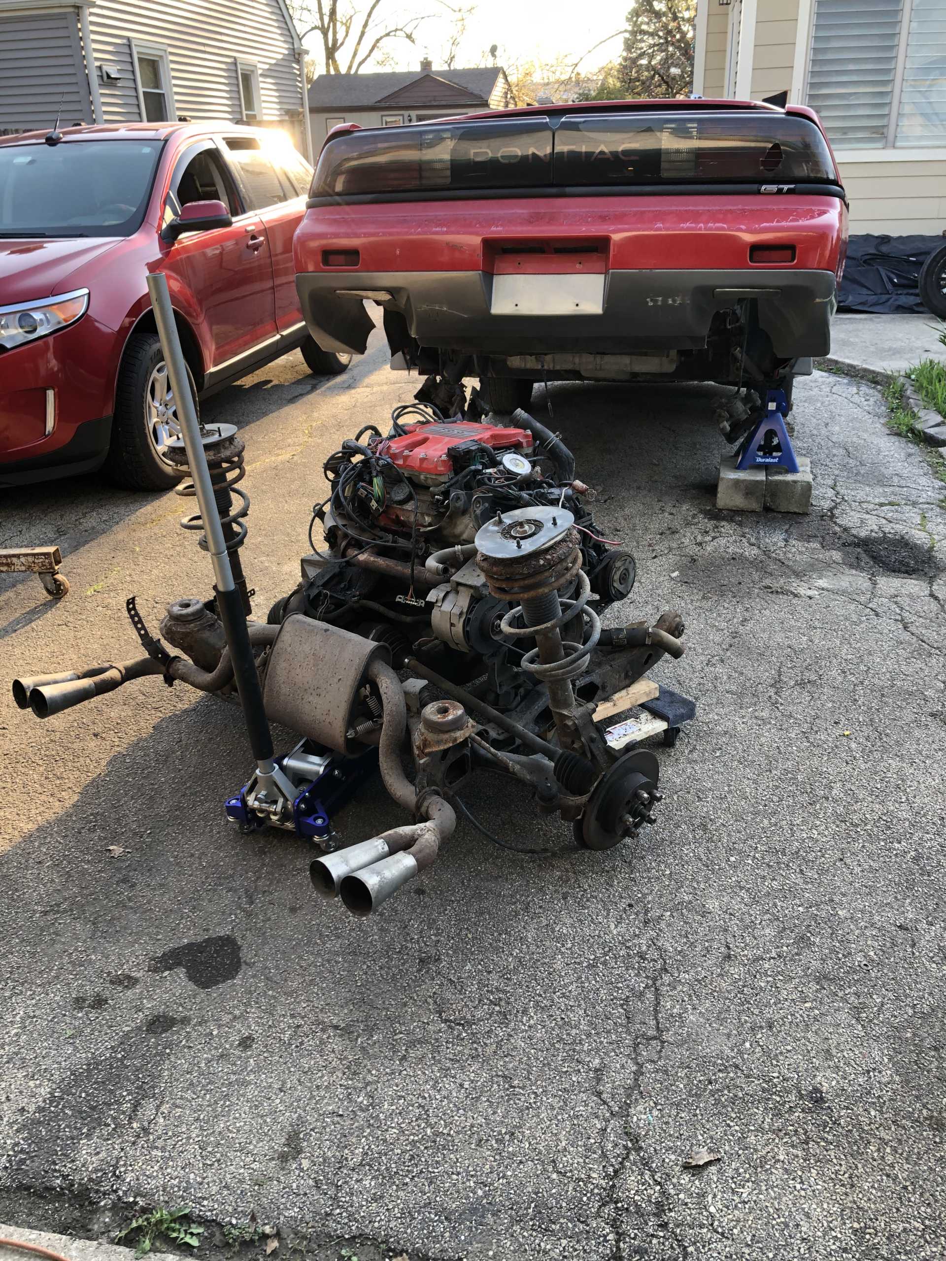

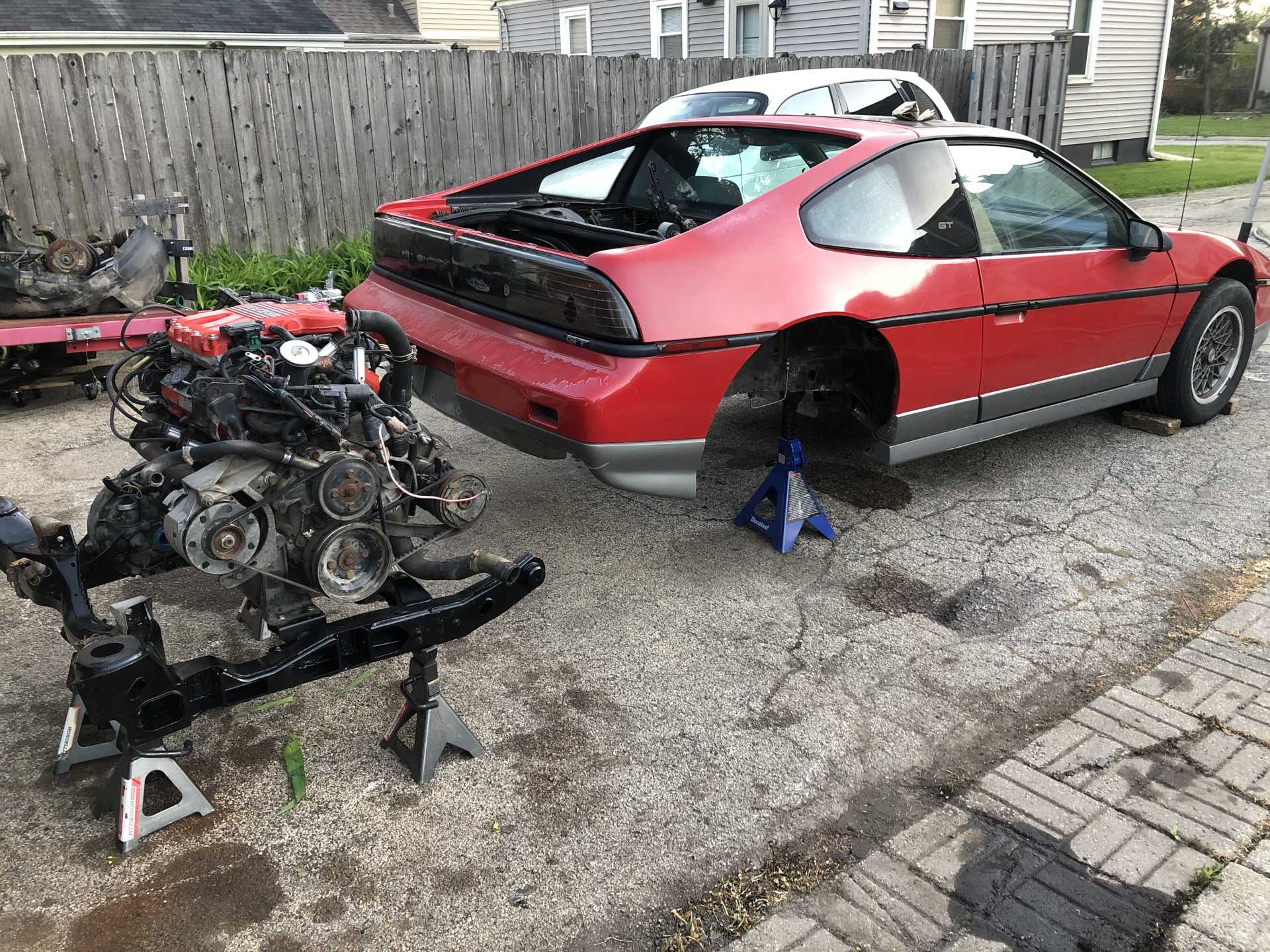

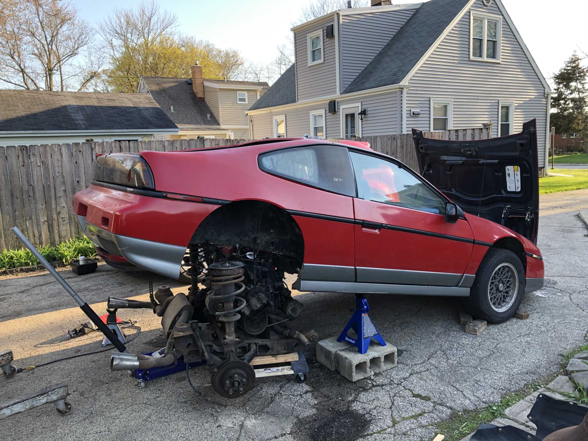

Next was to drop the cradle. Had to go out and buy some new heavier weight jack stands and borrowed a friends cherry picker. And just started ripping and tearing. First time pulling and took me 4-5 hours.  Now it’s time to go through everything since the engine is out. And found a few problems

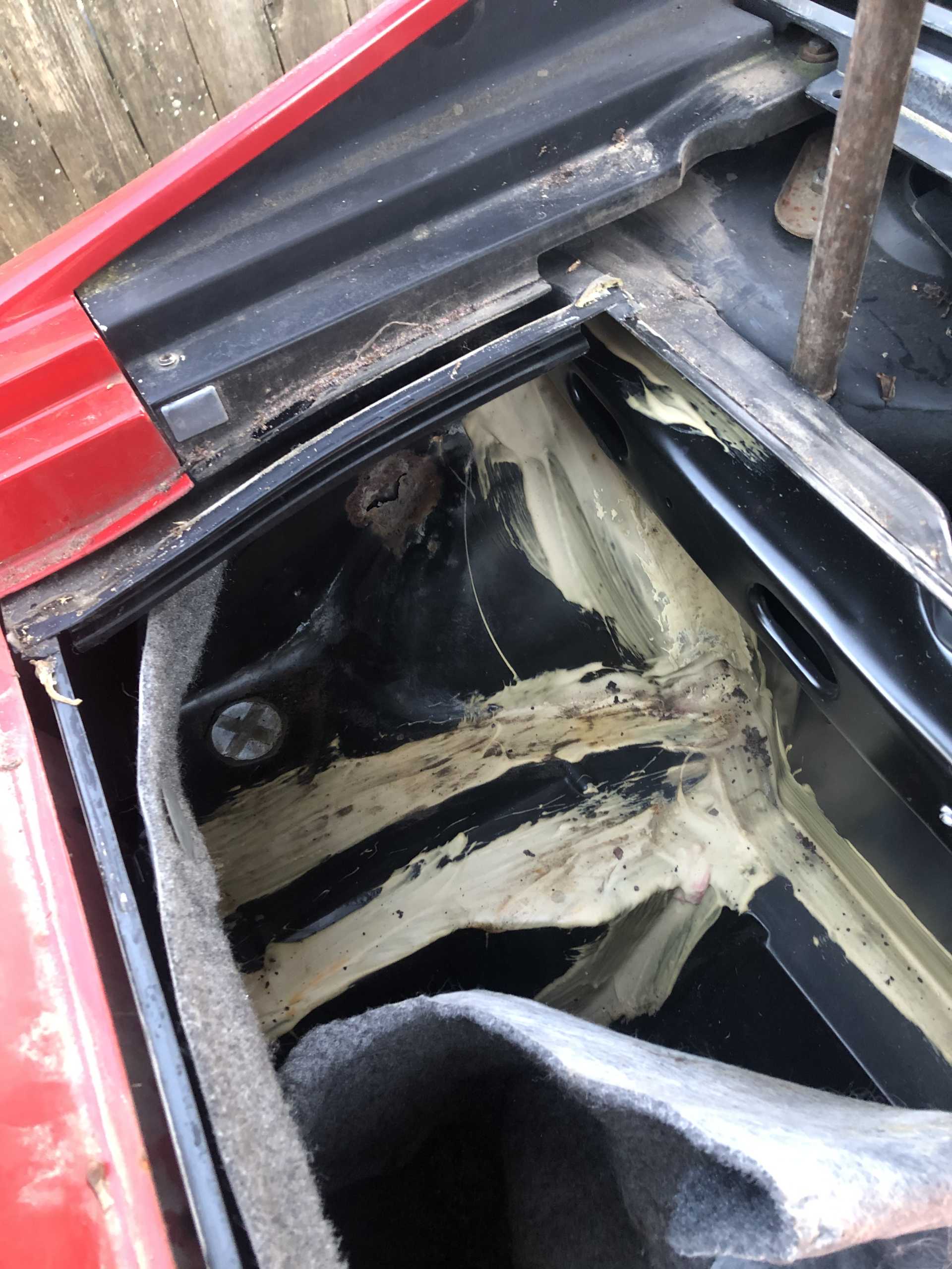

-slave cylinder bracket was broken. -alternator bracket was cracked. *along with the lower mounting bolt threads stripped from the alternator, needing a nut on the backside. -3 exhaust manifold bolts were broken. 2 on the firewall side, 1 on the back side. A/C was inop due to the rubber line on the firewall was cut -Valve covers leaking oil. -Axle seals leaking oil.

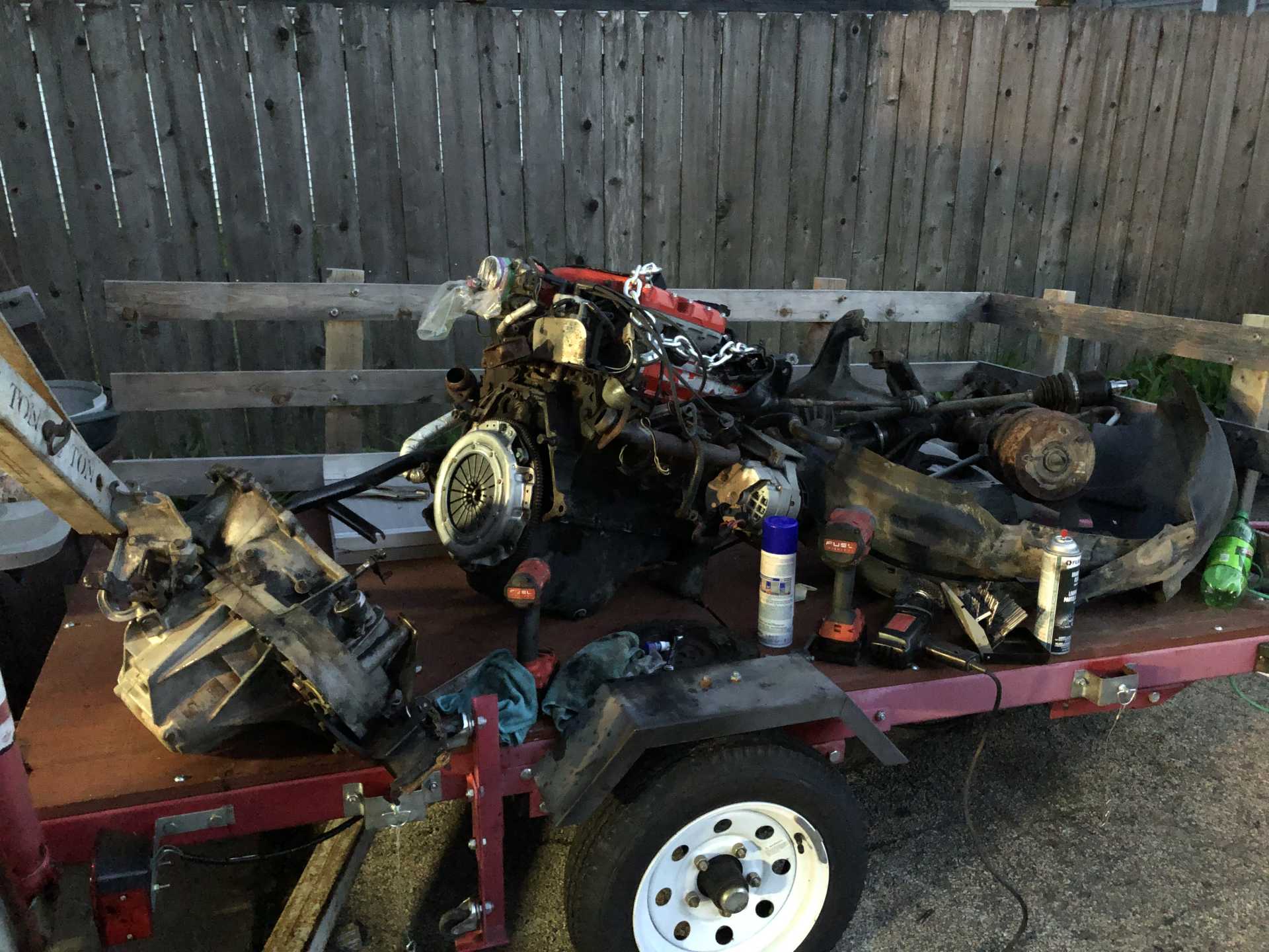

I tore everything apart and split the engine and trans on the parents trailer

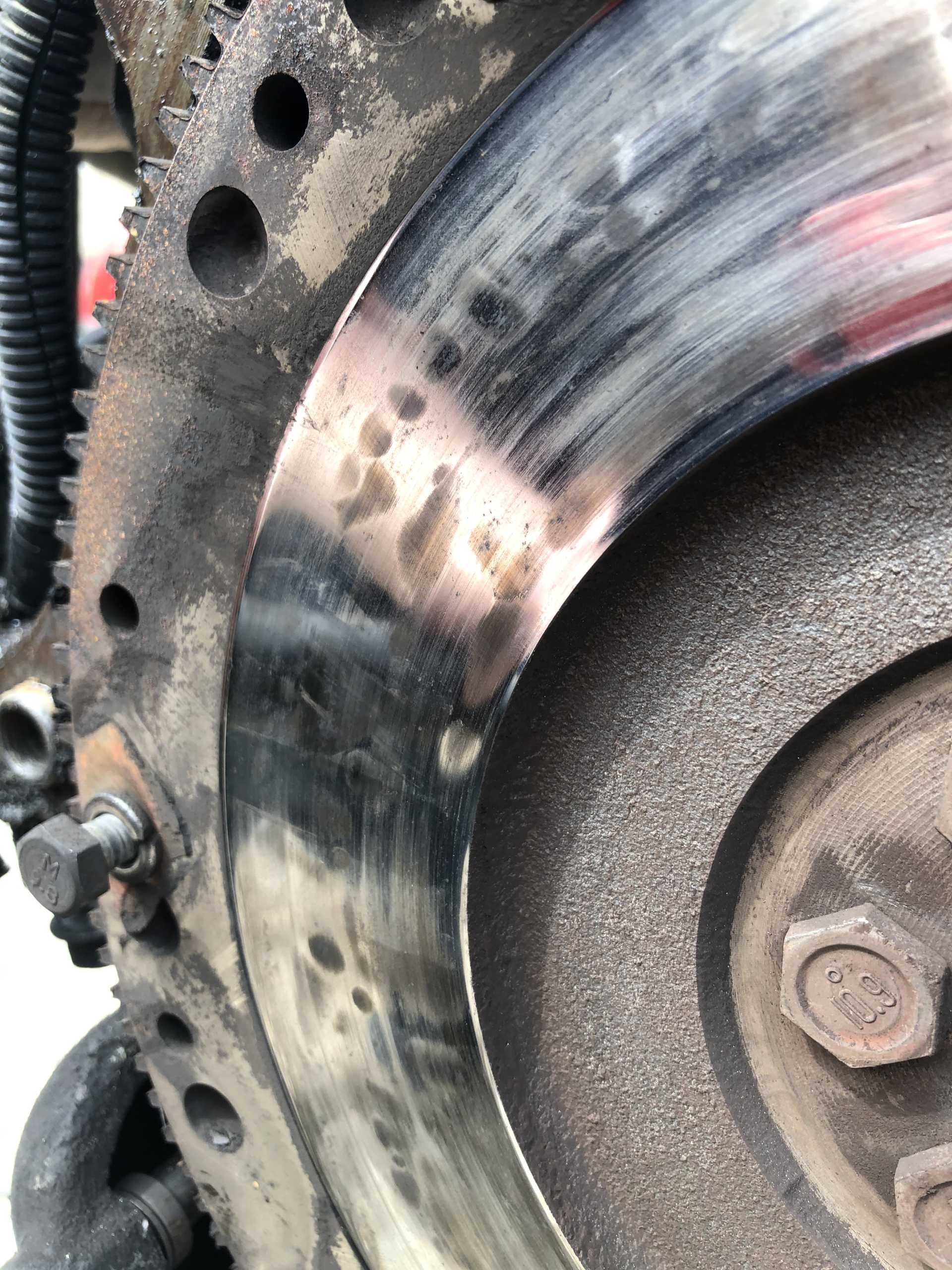

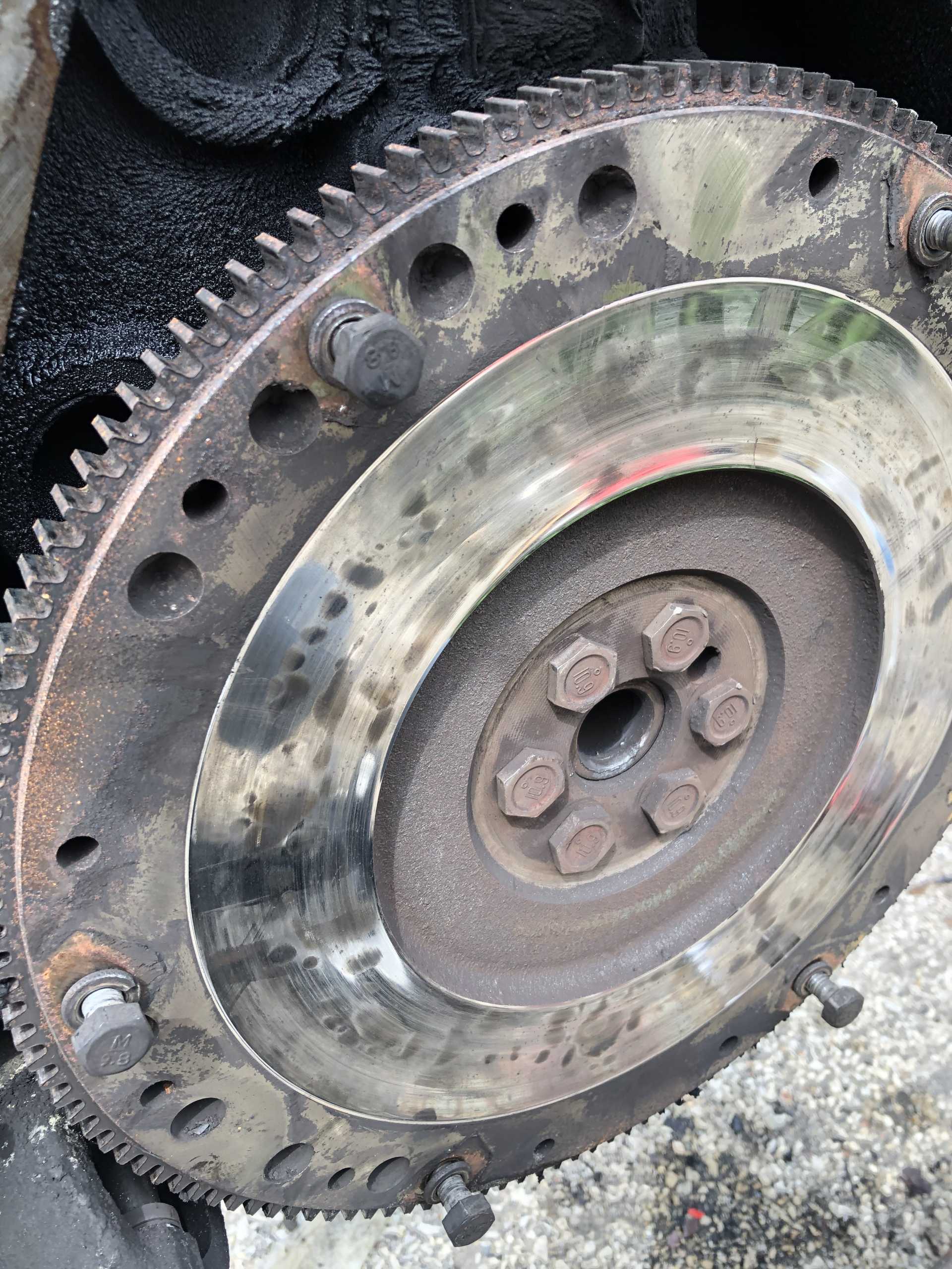

 Great way to work but that’s what I have to work with at home I took apart the clutch and found another unexpected problem. Not only was the clutch smoked, the flywheel was really really worn as well
 For the sake of time. I was able to source an almost new flywheel from a friend, and on that note. I was able to find another A/C line and compressor from a guy local to me who actually has a 3800sc swap Fiero.

Good luck on the swap and welcome to the forum. As for the 30+ yr old 147K mile transmission, its probably a bit worn; I would go over that and make sure that all of the bearings are tight and in good shape. ------------------ " THE BLACK PARALYZER" -87GT 3800SC Series III engine, custom ZZP /Frozen Boost Intercooler setup, 3.4" Pulley, Northstar TB, LS1 MAF, 3" Spintech/Hedman Exhaust, P-log Manifold, Autolite 104's, MSD wires, Custom CAI, 4T65eHD w. custom axles, Champion Radiator, S10 Brake Booster, HP Tuners VCM Suite. "THE COLUSSUS" 87GT - ALL OUT 3.4L Turbocharged engine, Garrett Hybrid Turbo, MSD ign., modified TH125H " ON THE LOOSE WITHOUT THE JUICE "

Just an FYI, the V6 flywheels prior to 1988 are not neutral balance, the engines prior to 1988 are external balance. Make sure the flywheel you get is from a car prior to 1988 otherwise, vibration problems. Your making great progress!

Thank you for the concerns Dennis and Ogre, I quickly learned that lesson when I got chewed out by multiple people I lowered the vehicle down on just the jack stands positioned on the rear frame rails without bricks to support them, thenused Sourmash’s method when I reinstalled the engine later on.
Mark the flywheel I later installed was from a pre-88 engine, I was wondering why only new 88 flywheels were available but luckily a friend came through with one of his
