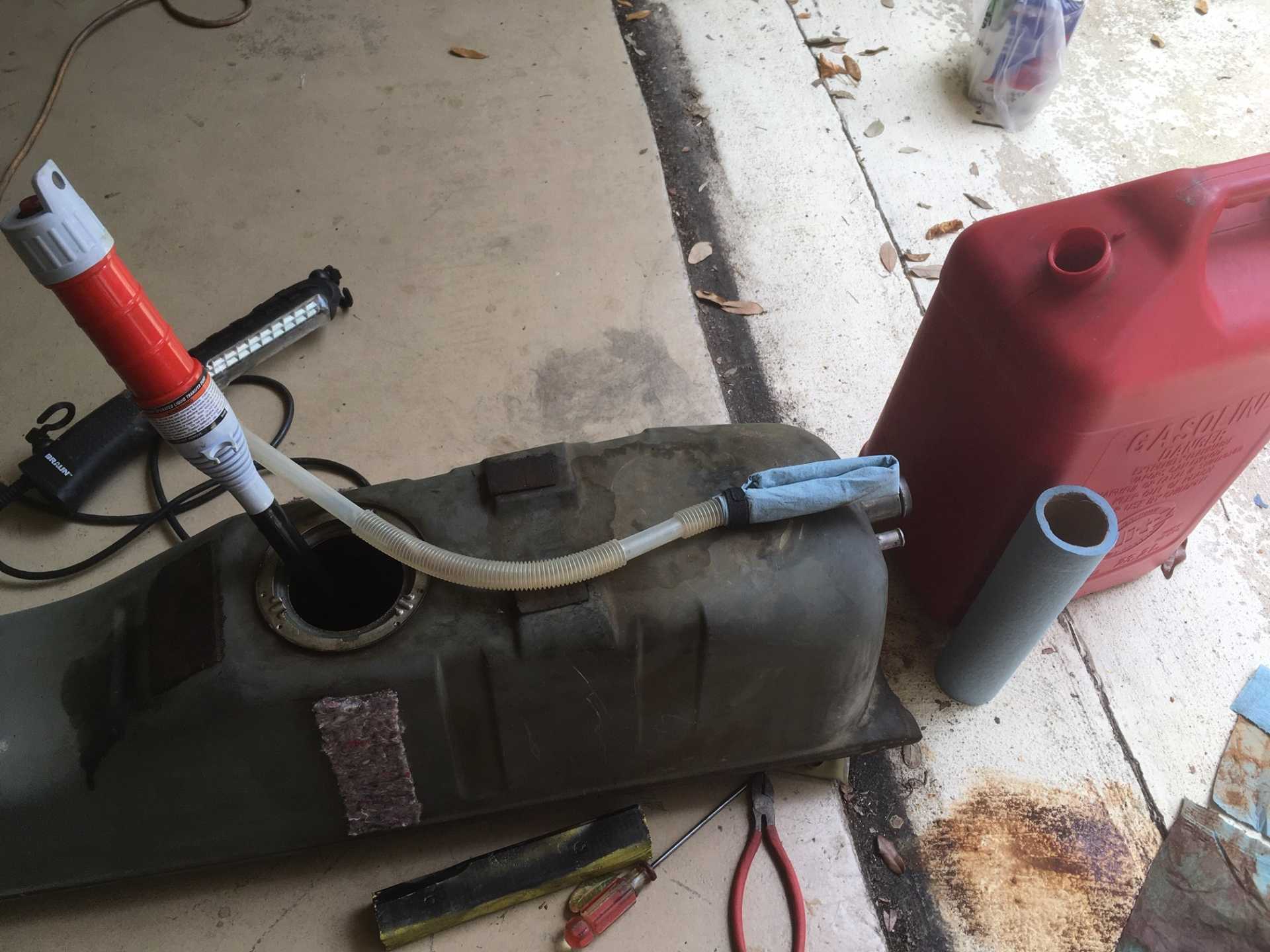

So my fuel pump died, and I had 7 gallons still in the tank. I knew dropping the tank would be no problem, but I had no intent to muscle 7 gallons back up and into position, even with a jack. The neighbor says, "Hey, use my battery-powered pump to suck out that fuel after you have the tank on the ground." Holy cow, it worked great. Best of all if sucked out almost all of the crap that had accumulated along the bottom of the tank. The basic process was to slosh the fuel back and forth, stick the pump in and velcro a folded-over paper towel to the outlet (to catch all the crap). Took a while, but it worked well. Flushed it a couple of times with a fresh gallon of gas and repeated. Then I finished up with a telescoping magnet extended along the inside bottom of the tank to pick up the remaining rust that did not get sucked up. Only thing I didn't do was end by filling the tank with phosphoric acid like is frequently done with motorcycle gas tanks. That stuff works like a charm. If I ever drop the tank again I'll consider that, but for now using the battery-powered pump and the magnets worked well.   ------------------ '87 Fiero 4.9 5-speed

⚠️ Warning: Run the pump Outside w/ a lot of air moving.
That pump is mainly made for non HAZMAT and maybe fuels like Diesel and K1 that's won't explode easy.
Gas fumes in/near tank can get in Stoich range (~ 14.7:1) and burn or explode. You want the space if the tank light up but if you have a lot of air moving the fumes should be to lean to burn.
Plus many garages has Water Heaters, electric whatever turn on/off automatically. etc that fumes can finds.
Or just raise tank up and use any siphon but still need to do this Outside w/ plenty of air.------------------ Dr. Ian Malcolm: Yeah, but your scientists were so preoccupied with whether or not they could, they didn't stop to think if they should. (Jurassic Park)

Roger. Good advice, Ogre, and should apply even though this pump IS rated for gasoline.

I won't trust DIY and cheap transfer pumps even rated for gas. Your releasing a lot of fumes if nothing else that follow the ground/floor.
Watch out for static buildup. If not on the ground or grounding surfaces... Same reason most to every stations have warnings to put portables on ground. Worse in dry weather. Example: Many think truck beds are metal but many have bed liners that's insulating metal and plastic gas cans.
Station pumps have a ground wire in the hose but still can have problems cause fire or worse filling legal portables in/on truck beds etc. (Worse fools pull out active nozzle and gas goes everywhere in a fire.)
