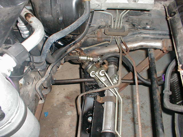

Spoon
JUN 28, 07:08 PM
dremu
JUN 28, 07:34 PM
Spoon, out of curiosity, why put the pump in the trunk? Seems to me like you'd be better off with it in the frunk, assuming there's room. Shorter lines, at the very least, plus no chance of leaking on the carpet. Or is the pump too big or your frunk have other stuff in it?
