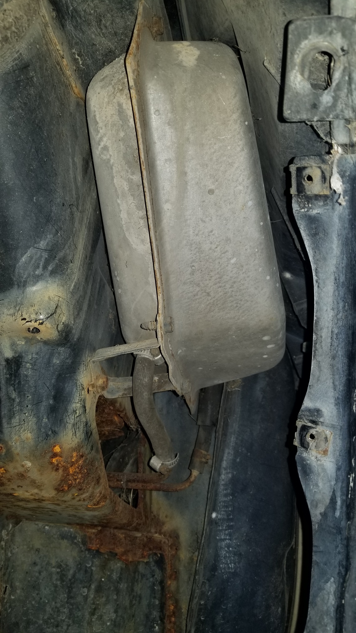

Before I take the car off the lift and run it under load, I wanted to talk about the Fuel Vapor Tank, which is located under and forward of the battery. Is there any possible issue that can cause problems with this tank?
