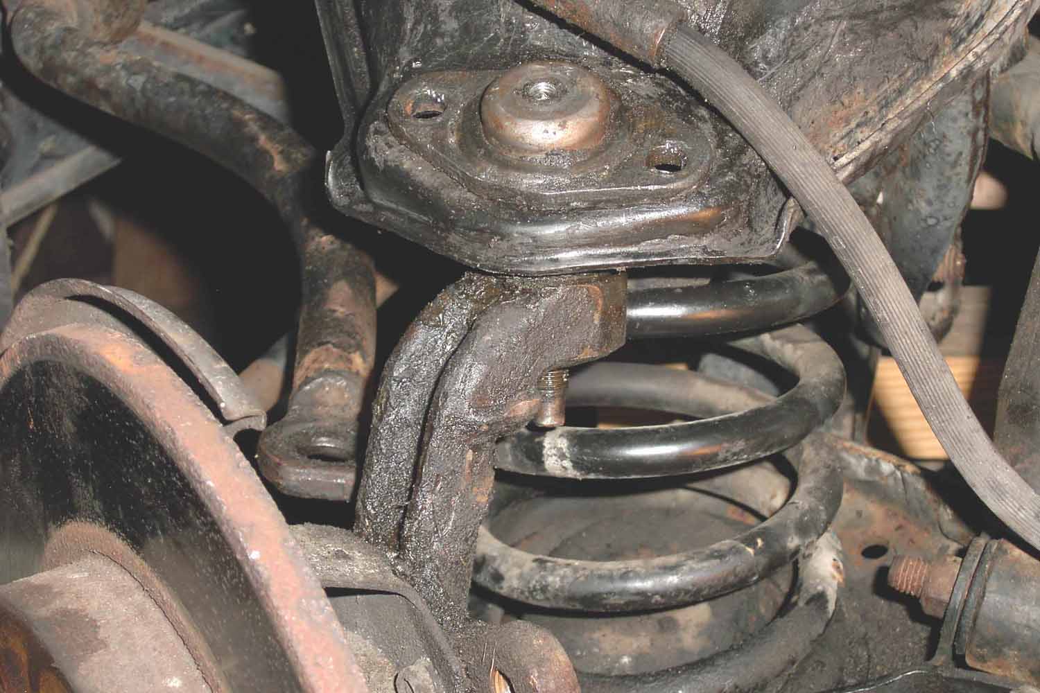

I'm trying to replace the front upper ball joints on my 86 GT. I removed the mounting bolts, castle nut and the grease fitting. I tapped the threaded stud from the bottom with pretty good wacks, and even tried prying up on the top between the mount and the control arm and the stubborn thing still won't pop out.
Is there anything I'm forgetting to do? Thanks in advance.

Could you add a picture or two showing the situation? Some of us haven't done this job yet and we can learn with you

It takes a lot to break the tapered end of the BJ loose....I bought Rodney Dickman's BJ removal tool which goes between the two BJ ends and then expands- Be prepared- when one breaks loose it makes quite a loud sound. Also, leave the nut on but loose by 1/8" to contain it when it pops loose.

Thank you - I'm assuming this tool is for the upper joints. I may just decide to use a fork (even though it may be tougher to get under the collar). I'm not worried about damaging the BJ since it's being replaced.

I had that problem before. Here's what I did. Check to make sure someone didn't tack weld the the BJ from the underside. Put the BJ back in the spindle with the nut on as far as you can, but don't tighten it. Lift the car and put something solid under the lower control arm, but NOT on the grease fitting. Now make sure there's space between the upper control arm and the spindle and pound the top control arm close to the BJ flange with a flat nose of a hammer or dull chisel. Repeat around the flange. I was surprised how stubborn it was but I got it out. Then you should be able to remove the old BJ while the lower control arm is still propped up. Wear safety equipment and exercise caution at all times. Good luck.

Most of the time I hit the part of the knuckle the ball joint stud is inserted into perpendicular to the stud rather than the ball joint stud itself while pulling down on the knuckle. Other note is leave the castle nut on the end of the threads flush with the end of the stud, gives you a larger surface to hit with a hammer but it'll probably damage the threads(doesn't matter here).
I know for sure I removed my passenger side upper ball joint with the pickle fork however I had the lower ball joint disconnected when I did this, might not be able to fit it with the lower still connected.

Thank you for adding the picture. Now I see what you are dealing with. Lots of great suggestions are being posted. (But I still don't look forward to that job in the future.)

I don't know if I misunderstand your issue. Is your problem, 1- getting the tapered stud out of the spindle or 2- can't get the bj out of the control arm? I thought #2 is your problem. In that case my post will not help you a bit. Sorry.
JUN 26, 12:48 PM
Put the nut back on the stud so spring etc hits the nut not you. leave nut 1 or 2 turns loose ref to full tight.
Buy/make a tool above and use it to push out the stud. To help that, bump the side of knuckle hole area w/ a hammer to shake/vibrate the joint area. Do Not "beat" the knuckle, use repeated light hits Between the two, should pop out w/o tighten the tool "to death."

Another vote for Rodney's balljoint tool. It locks between the upper and lower balljoint studs. As you unscrew it, it expands and forces against both balljoints. As others have said, leave the nut screwed on, but only loosened a couple of turns. When if finally lets go it'll make a nice "bang". You'll probably never be able to pry it off, and a pickle fork will just tear things up.
