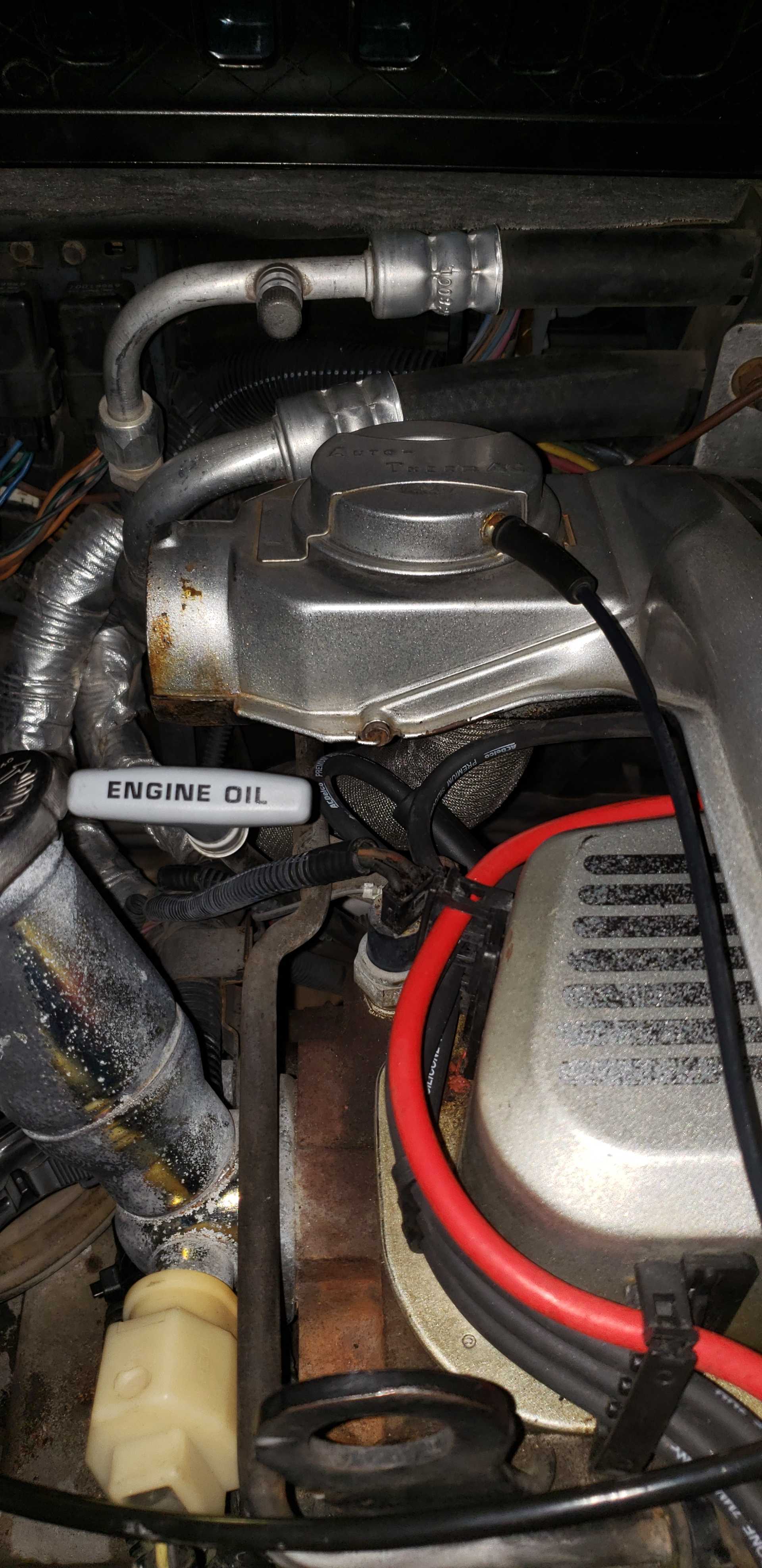

First time owning a 2.5 myself. Has a heater tube from exhaust up to air intake. Not sure about this flap but looks like something on top of the air intake that may be a flap.
Is this the flap? Is this accessible or repairable?

Look inside the filter housing and see if that thermac flap is capable of closing off the intake. I think it probably isn't. The valve opens to pull heated air off the exhaust down-pipe when first starting in cold weather so the throttle body doesn't ice then it gradually opens to allow air to be pulled in through the side intake of the car as the engine warms and closes off the heated air from the down-pipe. But it's open to air flow in all positions.
The blockage is likely in the main air inlet from the side of the car.

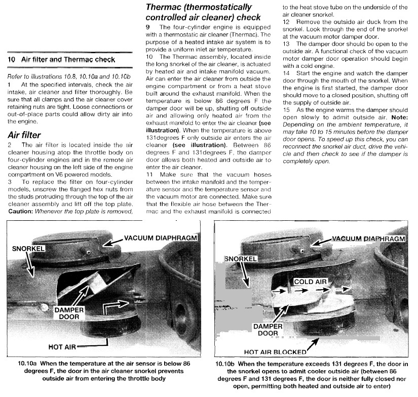

Definitely sounds like air not getting through to engine from air system. How new is the air filter element? Take filter out, put lid back on.
This is from Haynes Manual to check for thermac valve operation.
