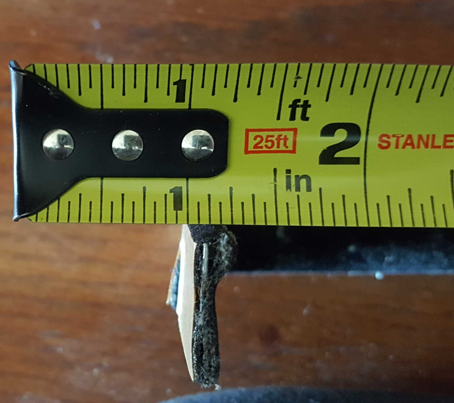

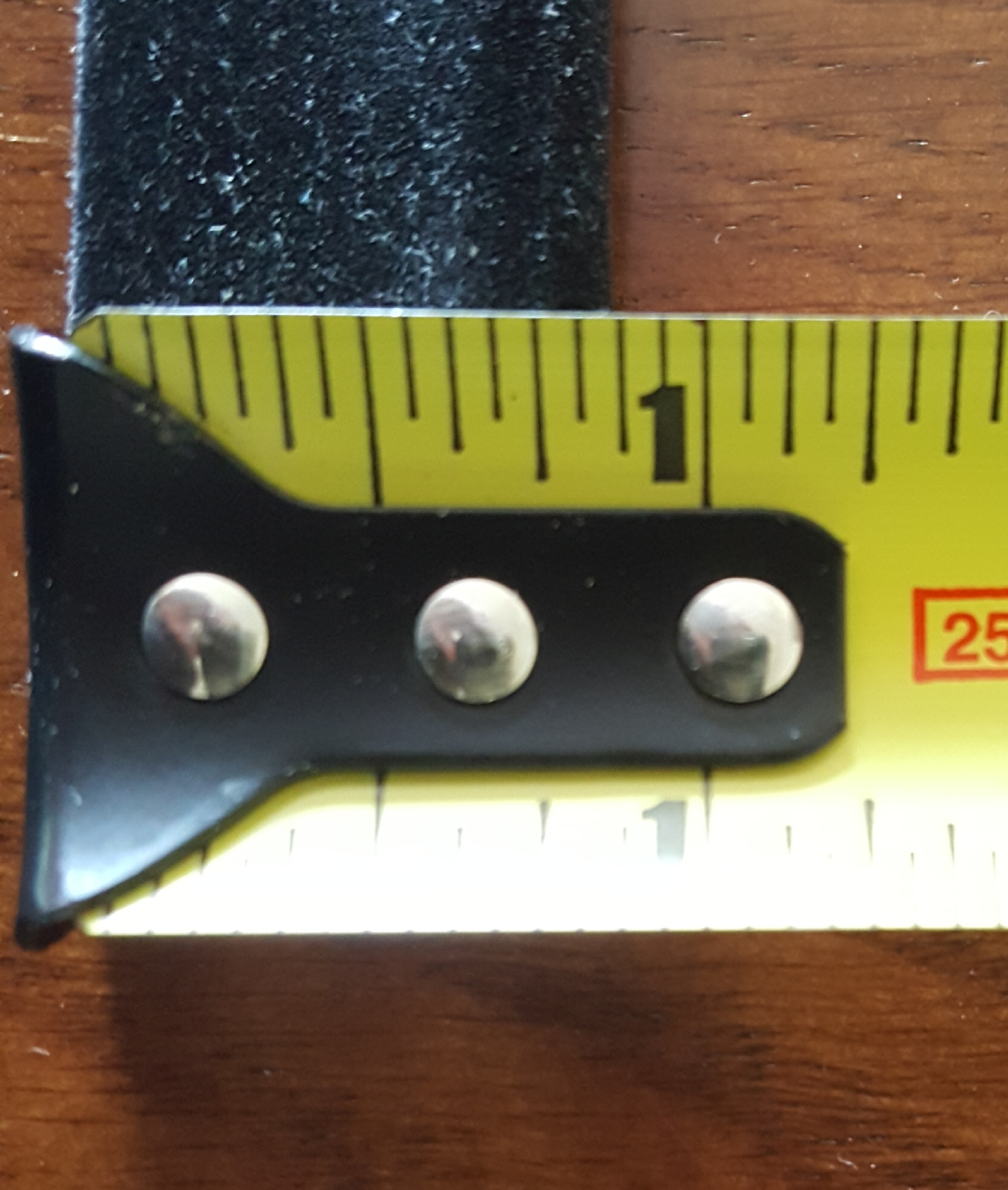

The seals I have are a firm. They have a stiff rubber or plastic tube running through for the "P" part. There looks to be a thin metal backing encased in them to keep their shape. Wrapped in a velvet (fuzzy) type material. About 7/8" tall and 1/4" thick.

Perfect. Thanks so much! Saves me randomly ordering sizes and getting them wrong
