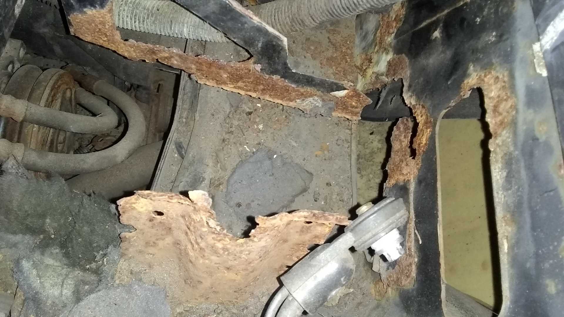

I've been trying a while to find threads about this and have, but I need specific questions answered.
Question #1 is can you weld/reinforce the rear subframe with out screwing up the nature of the part and wheel alignment? #2 how easy/hard is it to take the rear subframe off the car aside from the fact the car probably has to be pretty high off the ground?
Its a slow project cause I am on a tight budget. Had it since April last year and am just trying to get it safe to drive. Maybe another year if hope isn't lost I will try to replace the bushings and renew the suspension.

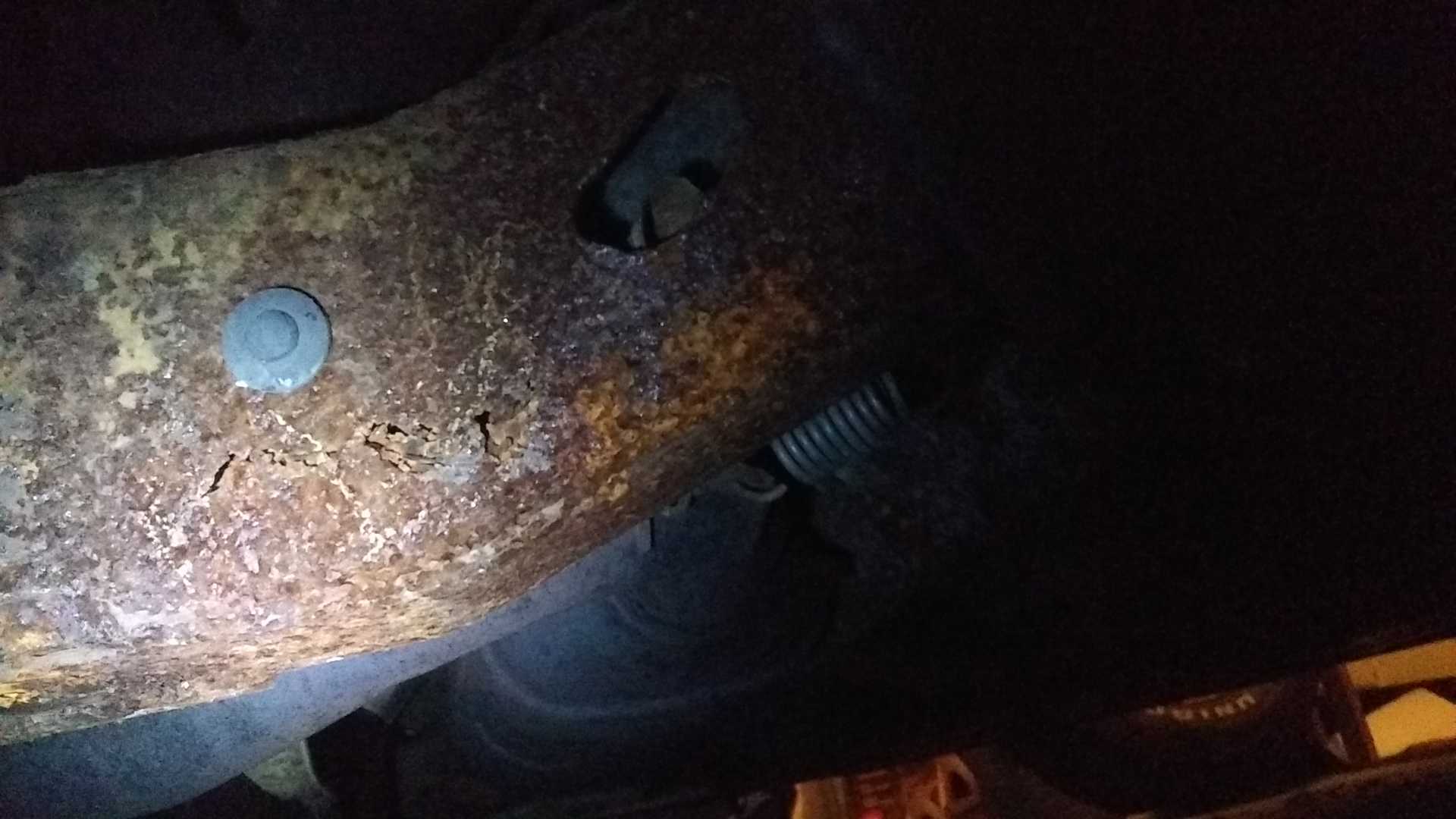

question #3 is there a better place to jack it up from? since I've been using that subframe and it is slowing the project down when I saw that crack it hasnt been off the ground much.

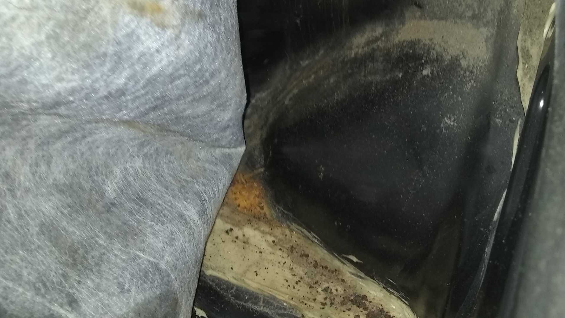

I'm pretty sad to realize the extent of the project over a whole year of having the car lol. I think I need to work some overtime to get it done. Like an engine hoist might not be a bad idea if I want to do the work myself. But I want to clarify, the existing subframe probably can be welded if the only rust is what is shown in that picture and that'd save me $300-$500. I can't weld myself, but I can find a welder. Or $500(+an engine hoist) really isn't that bad considering how I seem to be committed to the thing.

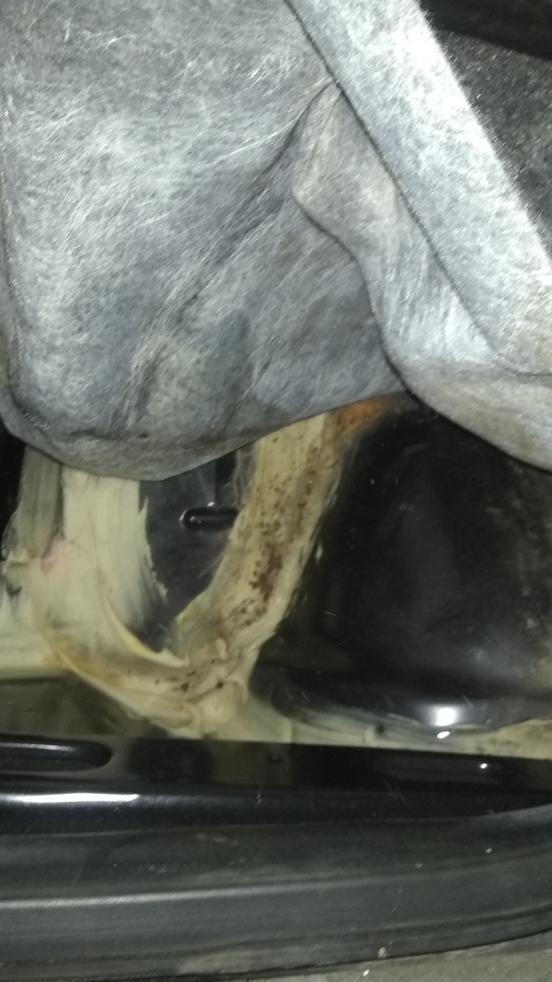

If you cradle is rusted through like that, I suspect the rear part of your spaceframe is toast as well. Pull back the rear trunk carpet on each side of the trunk and post photos of what you see - this will be very telling of the spaceframe condition.

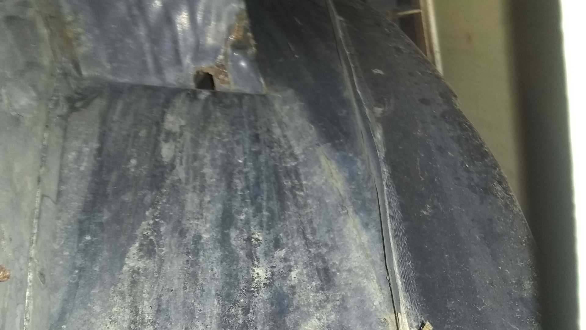

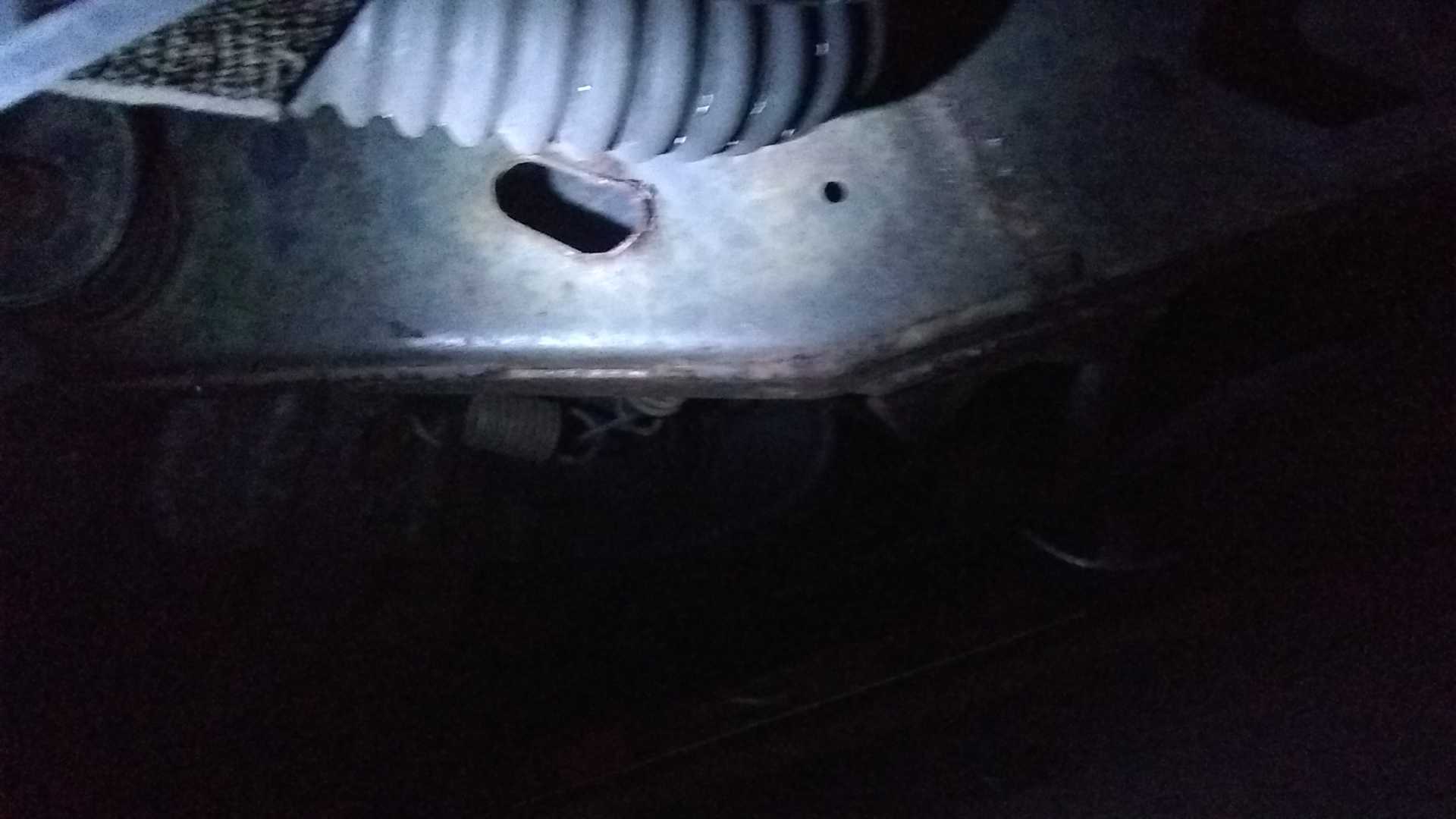

I meant to work on it last week, but with the feeling like I need to address the engine cradle first, I tore off all the insulation. The trunk liner looks factory new underneath and besides the battery tray being obliterated, under the insulation there it looks mint. I am glad. Now I need to know if I have a lift and engine hoist, where can I lift the car up from to get the engine cradle off?
I am thinking of buying an engine hoist and doing the 2x4 method to lift it high enough in my backyard, getting it off and having a welder look at it. I don't want to get it on a lift only to have the welder say he can't fix it.

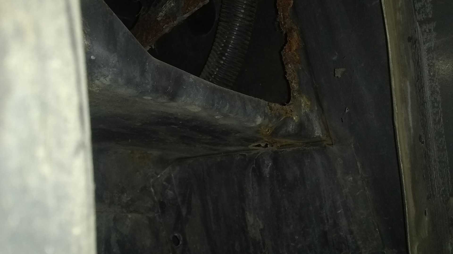

 I did lose the pics I had taken earlier and the only way to see better is to take the body panels off, but with a mirror and some light I can make out that a lot of the car still is protected. I have only found those 2 rust spots and of course surface rust or rust on hardware.

You need to at least loosen the rear plastic wheel well liners and have a look in there at the upper frame rails.

So I loosened the wheel well and its literally the same as taking a picture from below no?
