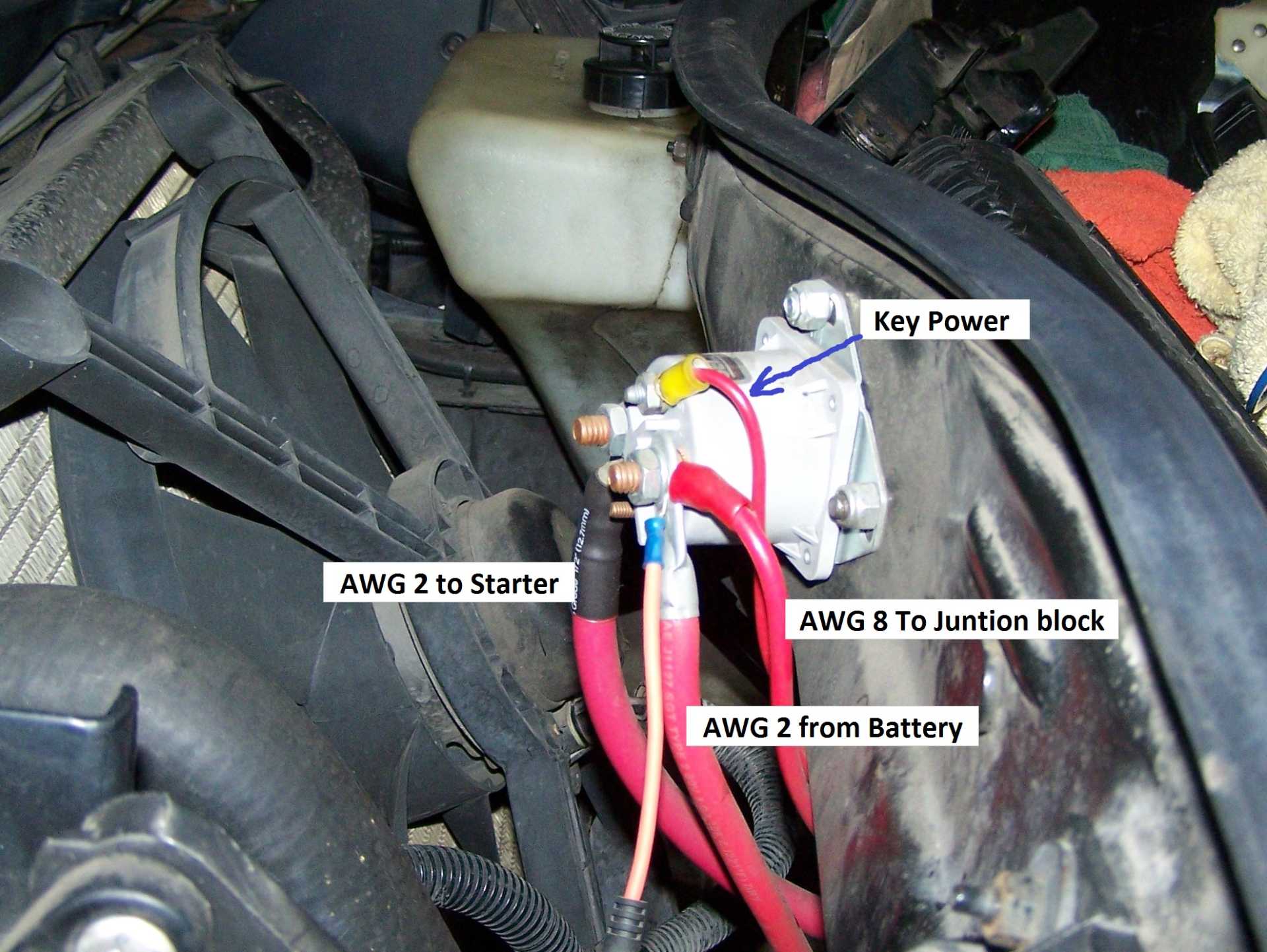

I put mine on the negative side- because when I moved the battery up front I didn't like a AWG2 wire (always Energized) running next to the gas tank, so on the positive wire I installed a Ford-style separate starter solenoid that only energizes the big cable during starting, then ran a #8 wire to actually power the car- and that has a fuse so that if it shorts during a (High-center) accident, it will hopefully shut off the power before gasoline gets to it.....
