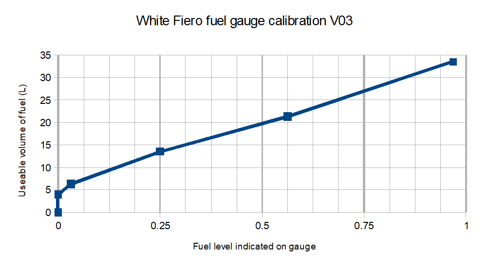

I found the stock gauge to be fairly OK, with 4 L remaining between "E" and the engine sputtering to a stop. After running out of fuel, I filled the tank to the brim; with this test I established the volume of fuel that is useable by the engine. Then, on future fill-ups, I recorded the gauge reading and the volume of fuel needed to refill the tank to the brim.
In general, I would make "E" equal to empty. Having a reserve after that means you're blind to the level of fuel. In other words, your gauge has become devoid of useful information when you need it the most.
The exception is if someone else will drive your car... they may expect to drive for a while on E like they do on other cars.[This message has been edited by pmbrunelle (edited 06-19-2020).]
