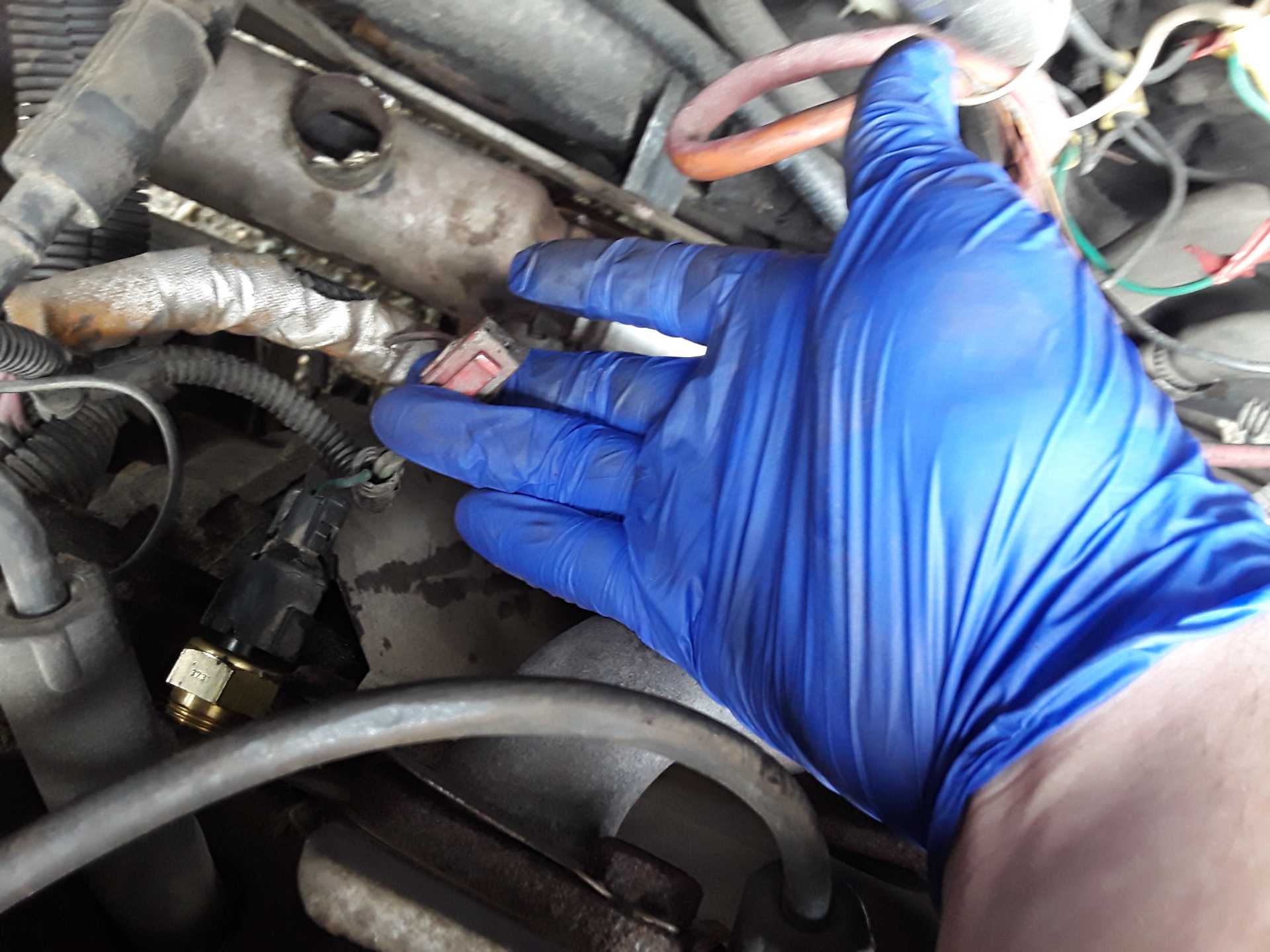

Not sure what this is for, or if it's important. It's an electrical connector on 2 green wires, coming out of the same harness wrap as the connector for the radiator fan. If anybody knows what it is let me know please. Thanks in advance

Sorry. Can't make it out. I only have v6's. I am having trouble recognizing the engine. Is this a 4 cylinder?

?connector for temp gauge sender?
JUN 18, 08:01 AM
/\/\/\ TEMP GAGE and HOT LAMP/\/\/\

| quote | Originally posted by Kwmiller:
What year? Is this perhaps an 84 and someone changed from the 2-speed fan switch to a new single speed switch? They likely would have just spliced the new pigtail into the existing wiring.

Sorry I forgot to include information. 1985 2.5 isuzu 5 spd. I noticed it when I was replacing the radiator fan switch (on the far side of the motor near the spark plugs)

Dk Green, Lt Grn, or both? (Either w/ blk stripe on side.)
Red plug is likely for "extra" 2 speed rad fan switch that 85 I4 cars don't have. See my Cave, Rad Fan
GM and others have made many harnesses w/ "extra" plugs because cheaper for them. Many or all l4 engines can use fan plugs and just install the right plug(s) on the motor in the factory. These are made in batches and dealing w/ Many Thousands of parts. Make minor changes can cost more then have "extra" plugs/wires for trim level etc car is build for.------------------ Dr. Ian Malcolm: Yeah, but your scientists were so preoccupied with whether or not they could, they didn't stop to think if they should. (Jurassic Park)

Okay that is probably what that red connector is. Thanks guys
